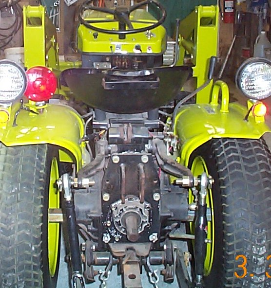

I have finished mounting the lower lift arms and mounting hardware for the 3pt on my YM1301D. All that is left is the upper link mount.
I haven't figured out the best way to put the upper link mount on the tractor. I attached a photo of the rear of the tractor where you can see two lower holes that I plan to use just above the 2pt bracket for the tiller. The only other accessable threaded holes are above those I just meantioned, and they are in the 3pt hydraulic housing. This housing appears to be aluminum, and I am reluctant to use them for fear of the possibility of breaking the aluminum with heavy use. Furthermore, the link will attach in this area directly between the upper lift arms.
Anyone out there have suggestions? Anyone with a 1301 or 1401 (they are virtually identical in the rear) with a 3pt hitch and some photos of the upper link mount? Any dealers willing to part with some good knowledge of where and how to mount the upper link bracket?

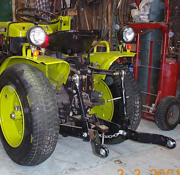

OOPS! Here is the picture.
Matt

   / YM1301D 3pt Upper Link Mount
Matt,
Thanks for the photo. It looks like yours is bolted to the housing on top of the tranny. That's how I did my 1110D, but the housing was steel. On my 1301D its aluminum. I'm just worried about its strength.
Matt,
I see from your photo that the top link bracket is mounted to the posts that are used for the 2pt tiller linkage on the gray market tractors like my 1301. Thats not really an option for me unless I want to convert the tiller to 3pt - and thats more work than I'm interested in right now.
