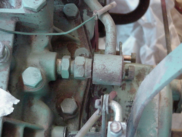

#9
Yes, I'm at that point now. I have removed the fender and took out the 'T' spicket valve that is on the right hand side of the control thingy that adjust the drop rate= still no go down. I have ordered & received a parts manual that show exploded view of control thingy, and I am at the point where it looks like I am going to have to take the control thingy off of the tractor to get a view of it's insides working from underneeth. Question?? has any one taken the high pressure connection apart between the high pressure line and the control thingy. I will have to take this apart at that point in order to get my control thingy off of the tractor. Looks like there are 2 wrench type places between the control thingy and the high pressure line. Can I just use 2 wrenches to seperate the line at this point?? or is there something else I need to consider??
THANKS /forums/images/graemlins/confused.gif

   / YM1401D 3ph goes up ok=down no go #10
I have seen rust build up in the 3 pt lift cylinder that would not allow the 3pt to drop. The hydraulic pressure would still raise the lift, but of course there is no hydraulic down pressure. You can remove the housing that the threaded control valve screws into and visually inspect the cylinder. I think there are only 4 bolts.
Thanks,
Bruce
