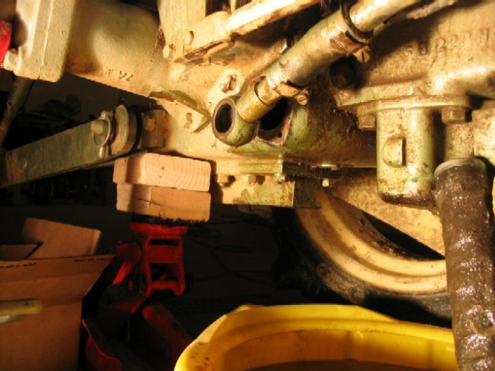

OK so I feel a little foolish here. But everyone here always helps so I figure I'll ask before I break something.
I was changing my tranny fluid on a 1500. I removed the three bolts holding the "banjo" bolt cover to the back right of the tranny case. The cover comes off easily and I can see and feel the mesh suction screen. Problem is it does not want to budge. I tried wigglin. gigglin, twistin, and even some cursin. But it does not want to come out. I even left a plate of milk and cookies...nope, it would not crawl out either.
So before I get rougher...am I doin it all wrong? Should I also remove the flat cover on the left side of the tranny case? That cover is directly across from the banjo bolt cover. Or do I just need to be more persuasive? This tractor is so easy to work on but this little screen seems to be a bit stubborn.

   / YM1500 Suction screen removal help!!1 #2
jdmar:
Hummm....seems to me your doing it all right. I've removed them on both of my tractors (both Yanmars) and they just came right out with finger pressure.
Your right on "how much pressuer" they will take....there somewhat stout....but wouldn't take alot of pulling or pushin' to mess one up.

I know that at least on some Yanmar tractors the screen is removed from the opposite side from the suction line. If I were you, I would take off that other cover and take a look from that side. It may be the answer, and certainly is better than damaging the screen.

JDmar,
Be very careful the 1500 has a spring inside the screen & they tear easily! Remove the cover on the other side & proceed catiously. Dont ask how I came across this info /forums/images/graemlins/frown.gif

   / YM1500 Suction screen removal help!!1 #5
I just finished mine. Mine was a little tight due to alot of "stuff".. Attached are pictures of what to expect..
Jay

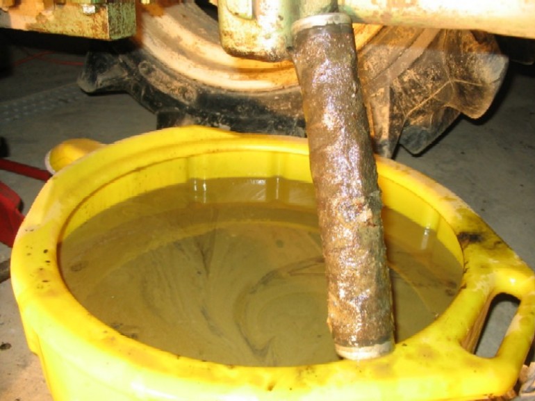

   / YM1500 Suction screen removal help!!1 #6
Pic of it dirty
   / YM1500 Suction screen removal help!!1 #7
Pic of it clean /forums/images/graemlins/smile.gif
It always helps when you can see what you are dealing with...

   / YM1500 Suction screen removal help!!1 #8
The screen on my 1500 comes out from the left side. Also need to remove the left rear tire/rim assembly. I found out the hard way and thanks to Buck at EFC for giving me the correct info.
