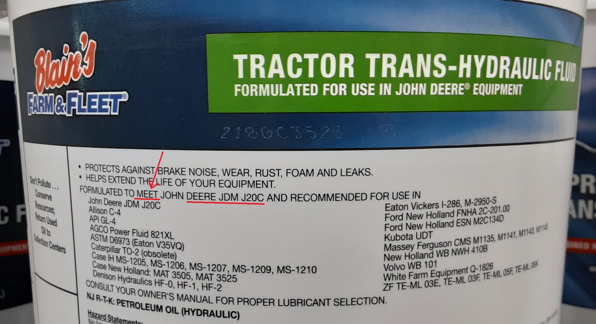

Meets J20C, then it's a good fluid. If it states 'compatible with', set the jug aside and move on.
Since 2020, I've not seen a good price on any of the fluids in a long time.

good to know about the "meets" vs "compatable with" difference..
rural kings version meets the requirements, and is around 45$ per 5 gallon bucket... https://www.ruralking.com/cam2-promax-tractor-hydraulic-j20-c-oil-5-gallon-565298
When I lived down south in TN, the first time I had changed the fluid was the Rural King brand meeting J20C. Living up north, the nearest RK is 2hrs away. :(
The TN Rural King took over an old K-Mart at the west end of Clarksville. Great location and even a huge K-Mart building. The store is so big, they expanded it! I surely miss the place. RK is far better than the Blains Farm & Fleet up here and a huge leap over the TSC store offerings.
