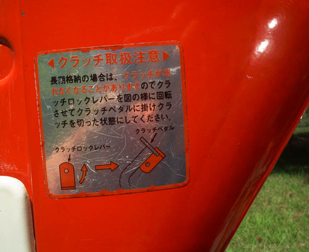

Welcome Terry,
Like they said, block that clutch.
Bruce

After reading this thread, I am thinking I should also be blocking my clutch down since some days I don't use it. I don't see anything on my tractor to do this with. Is it something I can buy?
   / YM169D, clutch #8
I bungee cord a pedal down to the foot plate on one of my tractors... Seems to work fine. Also, since either the tractors are undercover, or in a shelter, I usually don't lock down unless I'm going to be away from it for a few weeks or so... but, I should probably be doing such anyway....
doublecheck if you have this feature. it should be there... either it'll look like a flat plate with slot for connecting or a roundish metal bit (not unlike a tube) to hook over the pedal..
