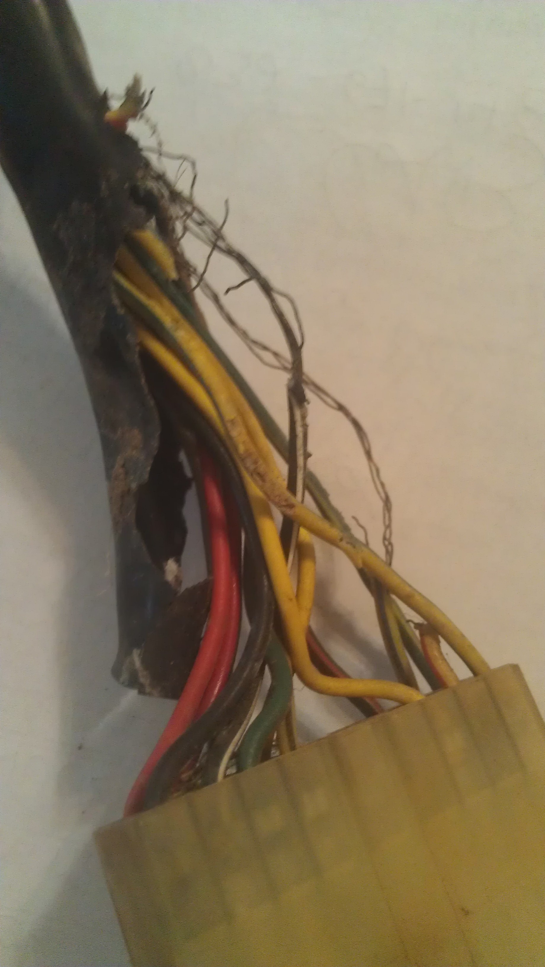

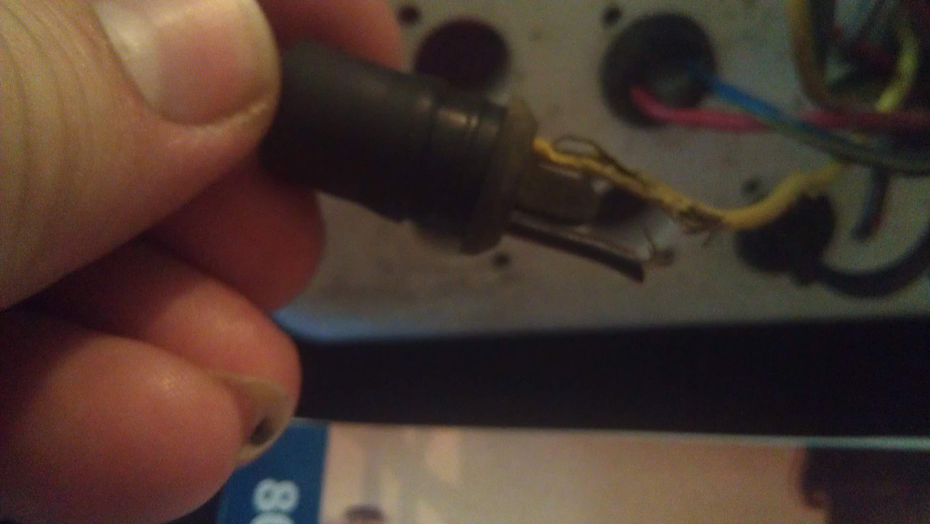

Ok went back outside re-installed the oil pressure gauge i fought to remove. Funny how that works. Started the tractor and it showed 70 at first then backed off to 50. The needle did jump a little, but never under 50 and never over 70. Is it possible I have damage in my harness that is making my switches short out.
YES - I had similar problems on with my F22D; temp gauge working sporadically and warning lights not working properly. I finally pulled the cluster to check bulbs and found what looked like the results of a rodent that nested in the cluster. After eight separate repairs of opens and shorts, lots of things are working better now. If your cluster is as easy to pull as mine, it is well worth the effort.
Here's a couple pics of things that were "ratted out". :laughing:

I had originally wanted to put gauges in. Then I changed my mind and figured I would try to work with the indicator lights. I ordered new bulbs, new temp and oil switches. I took apart the light cluster and cleaned it up. Got all of the sockets working and tested each one. They all worked. I installed and hooked up the new switches. Should be good as new, right? Nope. My oil pressure light would flicker, come on sometimes, doesnt really act right. I have no confidence in it. I took the oil switch out and put the gauge that was in the tractor when I got the tractor back in. Gauge reads 60psi, fluctuates some, but generally the needle sits about 60psi. So maybe at least I have a temp indicator I can trust. Nope. The temp light comes on sometimes and sometimes it doesnt. I can idle the tractor 5 minutes at 1500 rpm the light will come on. I let the tractor cool down to the point I can safely remove the radiator cap, the light is still ON. I worked with the tractor on Saturday, just goofing around, observing the tractor, checking for leaks. The tractor is still new to me, I recognize its thirty plus years old, and I new I would have some work to do. The temp light never came on after dragging a plow for approx 1 hour. Shut the tractor down for about three hours. Came home, hooked up the rotary cutter, cut for 15min temp light came on. Once again let the tractor cool down, but the temp light is still on. Eventually it goes off, but by that time I can touch the motor. I by-passed the wiring harness with a new wire and the same thing continues to happen. I will get an ohm meter and follow Winston advice above, or I may just ditch the warning light gizmo's and put in gauges.
