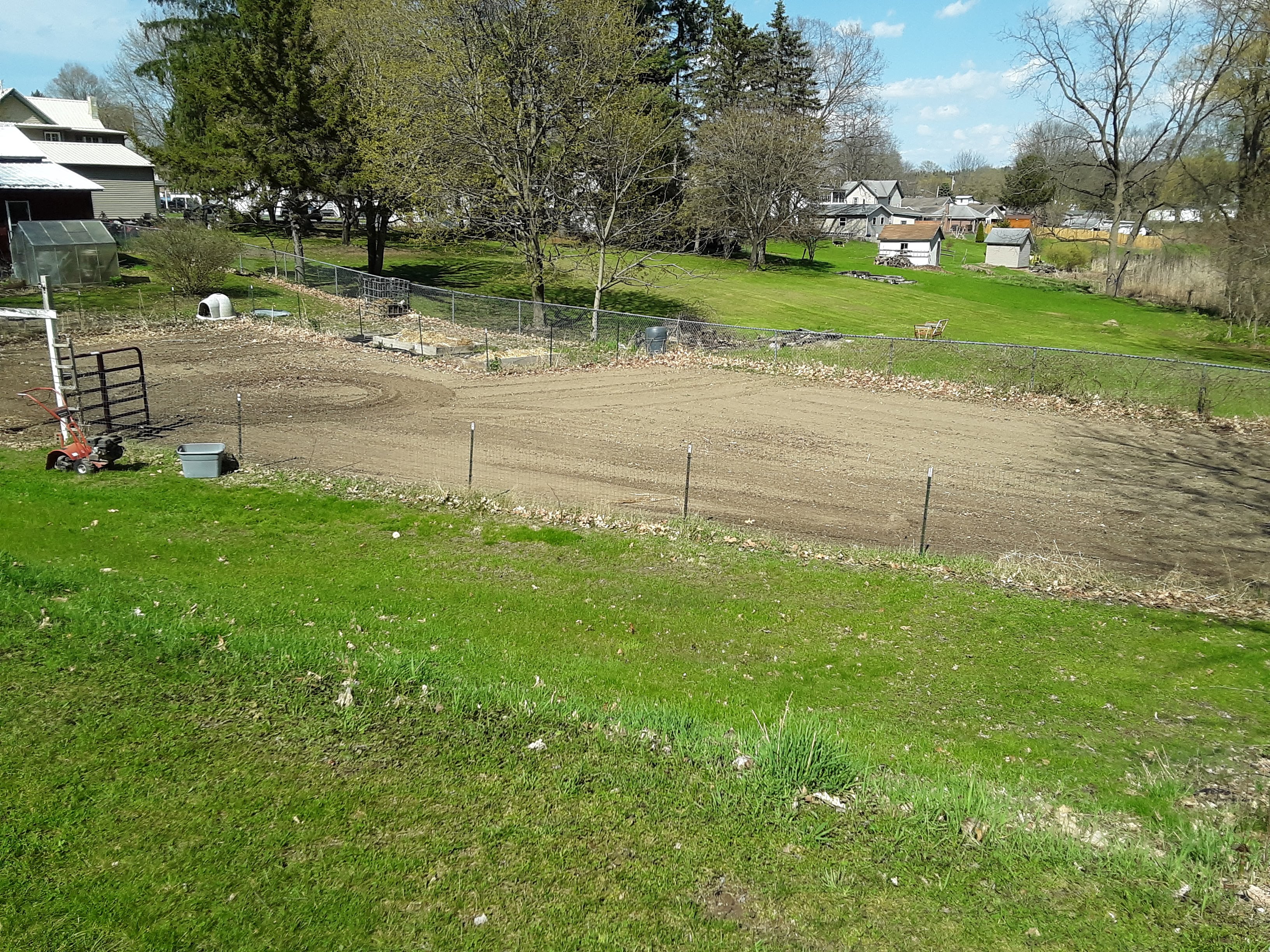

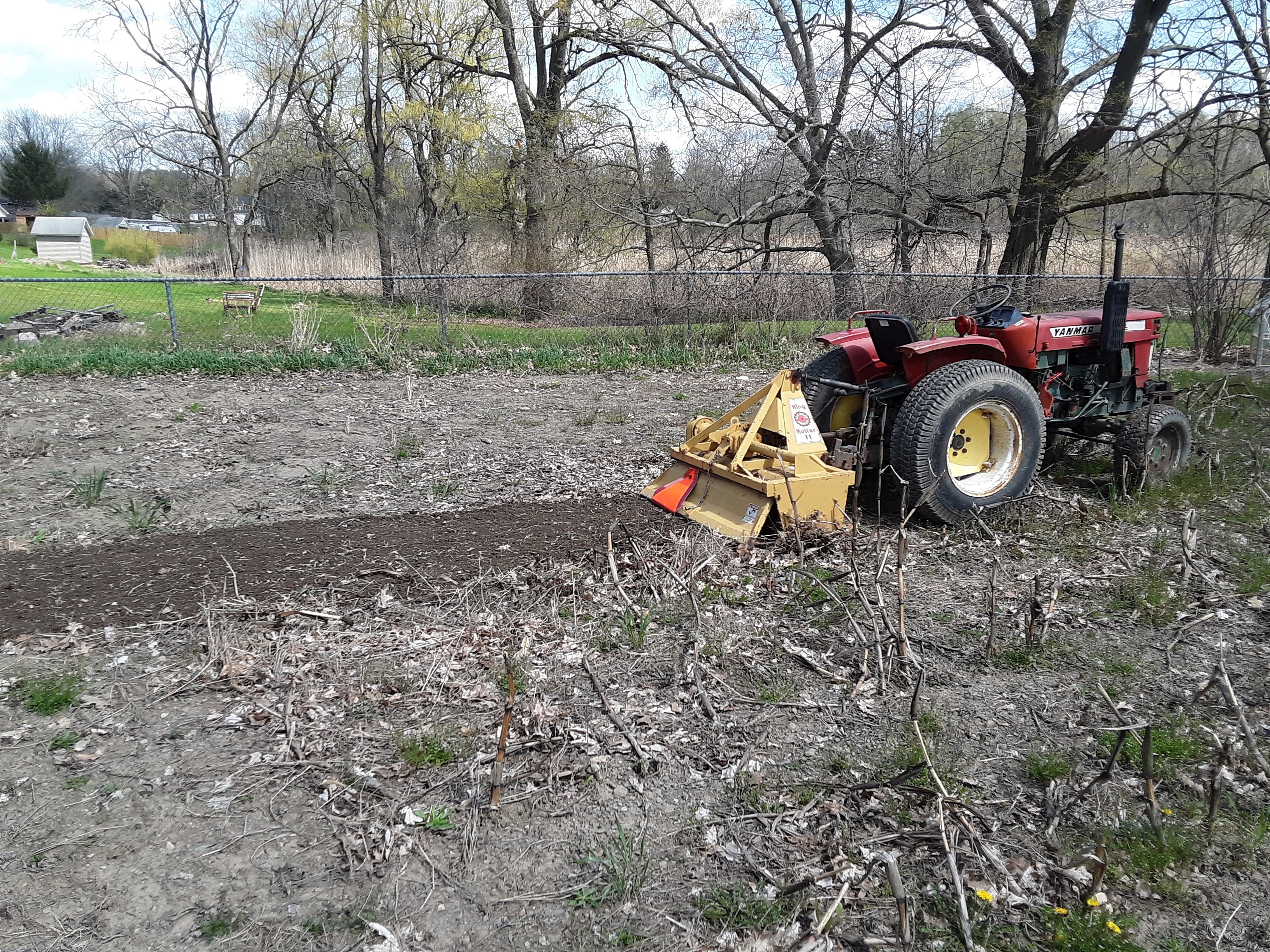

I got the oil leak fixed with some RTV. I hooked the rototiller back up to it and tested it out. It runs great! More power than it's ever had. Rototilled three gardens. This tractor should outlast me now.
Great! Should fire right up now with only a minimum of turning over. I知 not sure what the difference is between the 2000 engine and the 2210 is but I can tell you itç—´ surprising how much power my 2210D has. Youæ±*e going to really enjoy having it. Maybe you said earlier but what rototiller is that? Looks like a good fit for your 2000.
It's a 4 foot King Kutter TG-48-YK
