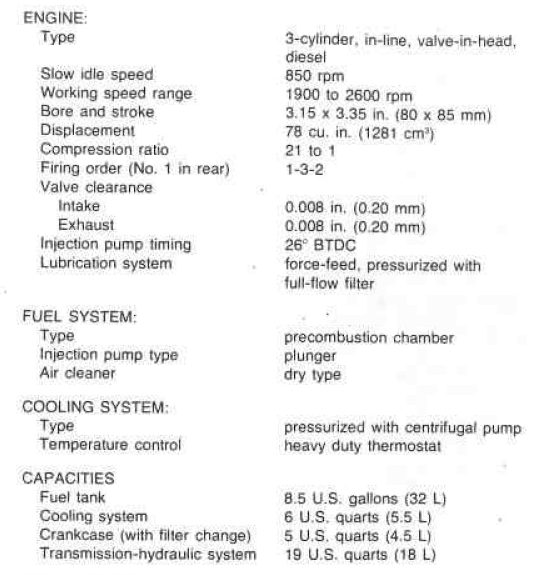

This is a 4wd YM2000D not to be confused with the YM2000 2 cylinder.
This is a 3 cylider engine and I'm trying to help an elderly friend do an oil change and can't find anything on the net.

I don't know the capacity, would guess between 4-1/2 and 5 quarts. If 3 cylinder you are talking about a YMG2000. YM2000 is two cylinder.

A YMG2000 is a far better machine over the YM2000. I hope his machine is the G with the more modern setup.
   / YM2000D Motor oil Capacity
Thanks, That's his machine. His also has a bucket and it's 4WD.
Going to start with 4 quarts check the oil level and adjust accordingly.
Im estimating it's going to take a little over 5 quarts to fill her up.

I've not added this yet to the Yanmar Model Cover Pages. Here is the Parts Manual for the YMG machines attached PDF. :)
Page 5 tells you how much oil the engine takes. 4.5L (5-qts)
Compliments of the Yanmar Tractor Owners Group on GroupsIO.
This is the English summary of a 3T80 engine. Its the OPS PDF attached page 83.
The JD850 is very close to the YMG2000 for engine info.

Thanks for all the info.
For the record it took a little over 5 quarts.

Yes, 5qts engine and a little more for the filter. ;)
The machine has the same hydraulic capacity as my YM2610 with the 3T80. It will be 19 to 21 quarts to change out with J20C Hy-Gard or TF500A. Both work.
