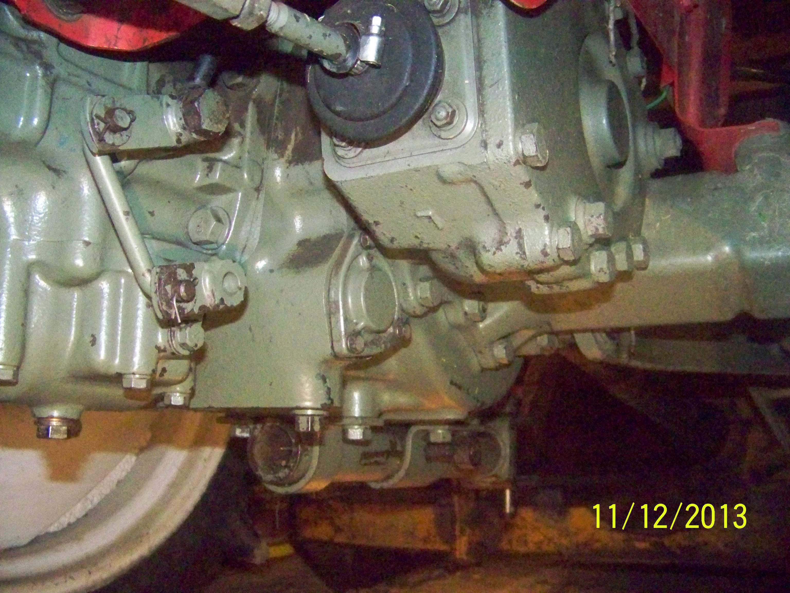

   / ym2002d hydraulic stop working #4
I keep seeing comments about the hydraulic filter screen, but have yet to locate one on my 2002D. Where it the world is it?
   / ym2002d hydraulic stop working #5
Right behind the 3 bolt flange you see here. Right behind the 4 wheel drive drop box on left side of tractor.

I'm having to learn all this the hard way and on the fly so to speak. Hydraulic filter is good, screen has been cleaned, everything flushed out and fresh fluid put in. The Hydraulics work better and respond quicker than ever before. Issue of going in gear still a problem though. Found out my son had pulled the shifter and cover off. Before he did this it would shift when clutch was pushed but would not move. Now it will move a couple of inches forward or back but it shifts without clutching. Any advise.
