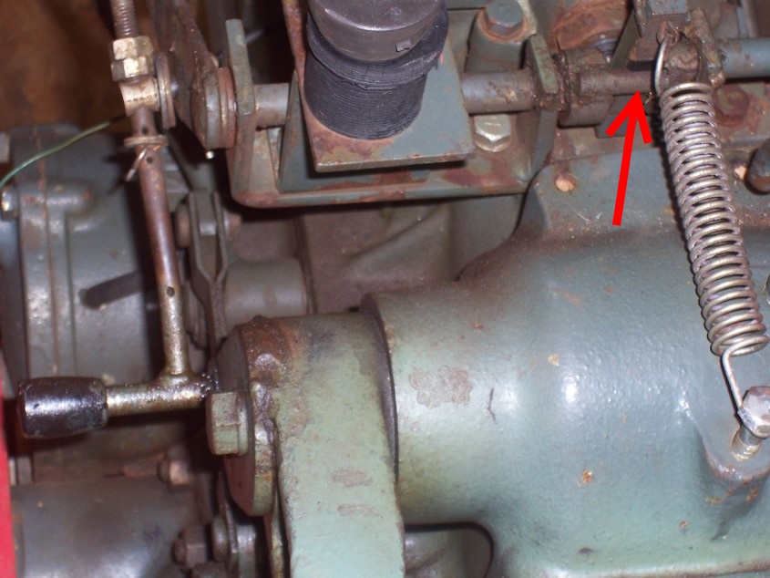

"I added more Hydraulic/transmission fluid thinking that may have something to do with it but there was no change".
If it goes all the way up unloaded it's time to Service the Hyd. Sys.. Clean the Pickup screen and New JD303 spec. Fluid. Curious that there is no mention of any visable leaks? If the Hyd. Fluid is Low on the stick. Who knows how long it's been since it was Serv.
On my YM2000 the height of my Lift is controlled by how you set the Control Arm on the Left of the pick. "Blk. Handle" When the arms get to the highest point that is were it is set to start pulling and relieving the pressure to the control valve ".Stop The Lifting".

That control arm picture is revealing as I keep looking at mine wondering what it does, but then I noticed in your picture that the pin is located behind the little bar that
pushes on the control plunger, but on mine its on the front side and did not seem to do anything.
That may also be part of my problem as I was feeling that if I could push the plunger in further it would cause the lift to go higher.

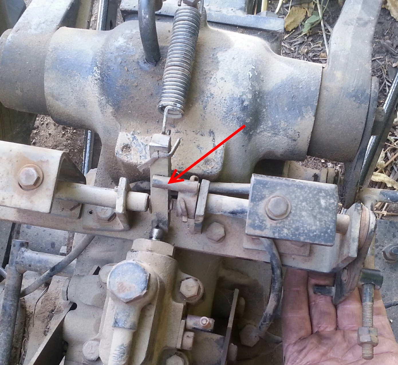

If it takes 3-5 minutes to leak down the lift piston o-ring is not your problem. The linkage Carey has pictured is the feedback rod and must be adjusted properly to get correct lift height. You should be able to watch yours while operating and tell if it is stopping your lift. You do not want to adjust it to high so as your lift piston bottoms out and causes damage.
Having said all that I can't understand why yours would raise with nothing attached. That would indicate it is not an adjustment. :confused3:
   / YM240 3point will only lift box blade 1/2 of its travel #7
Your Lift hasn't reached the Max height. If it did the Tractor will Bog from the Arms not being able to move Further up. Your hear the Hyd. pump Whine also when it does. Check the Height Adj. and watch it's set to the top. I Top mine out and then Set the Adj.Nuts on the Rod to a good 1/8 of a inch to prevent from topping out. Make sure the Feedback Linkage isn't getting in a bind and changing the Height. Still does it clean the Hyd. Screen probably restricting or Lack of Fluid to the pump. IMO.

Here are a couple pictures of my feedback linkage.
Note the "Pin" part is between the actuating bar and the plunger and NOT behind it.
It looks to me that at no point in the travel will it effect the plunger actuating bar, and it looks backwards compared to the picture Careyo posted.
My feedback VS Carey0
