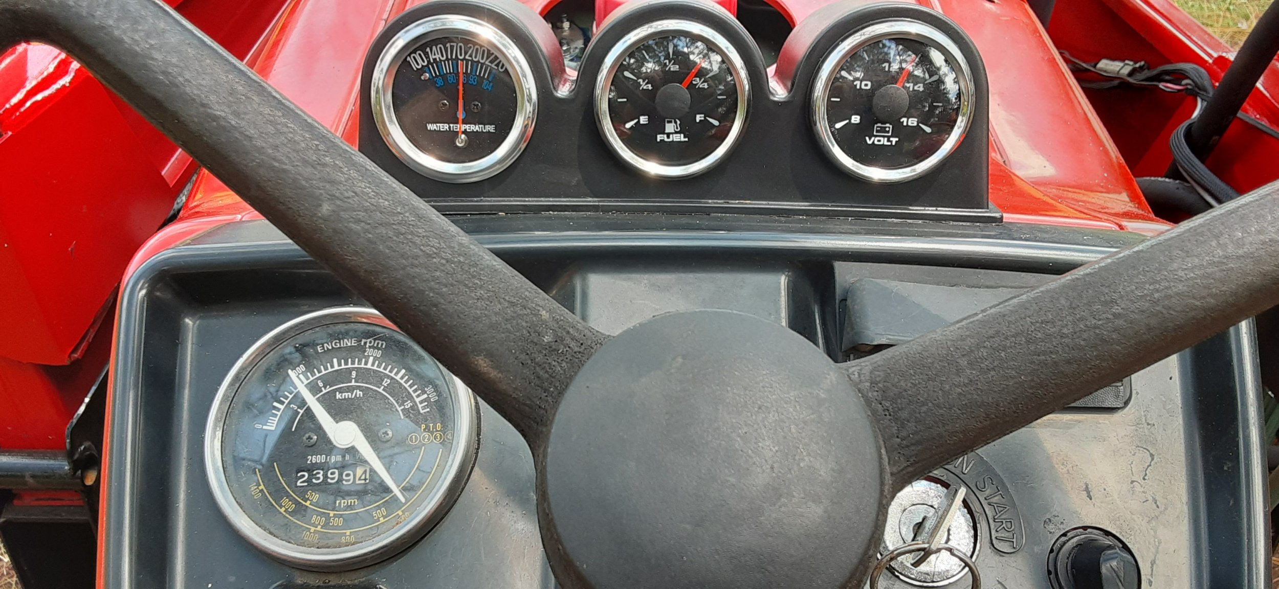

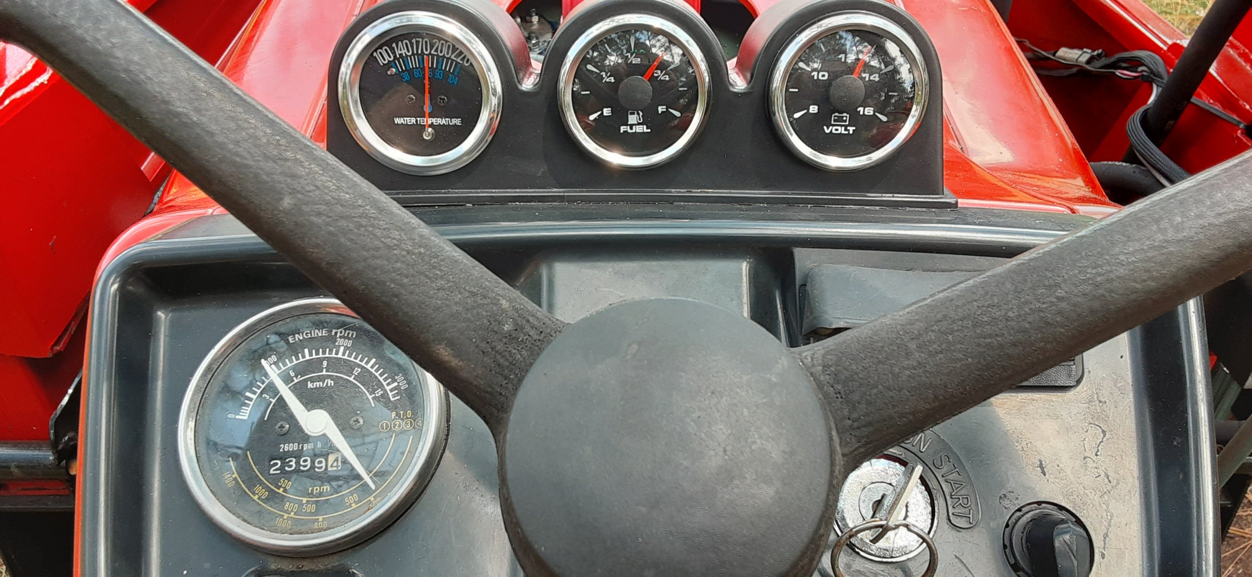

Yanmar 2610D
Finally finished my gauge cluster. If you look between the temp and fuel gauge you will see the fuel level sending unit mounted to the left of the fill port. Everything is switched and lighted. Did some brush hogging today in Florida and it was nice to see the temp never exceeded 190.
Links to parts used. I am not an affiliate.
Temp Gauge
Bezel
Volt Meter
Fuel Guage
Fuel Sending Unit

Oh my! Thanks for this posting! It looks SUPER!
I'm ok with the temp as it is on my machine, BUT the volts/amps and the fuel monitoring is EXACTLY what I need.
Sure, I have the fuel cap with the gauge, yet being able to sit in the seat to monitor it is more ideal.
OK, I bookmarked this thread. :) It's a keeper in my book.

I put the same 3 gauge pod on my JD4310 a while back. It's great to have working gauges in plain view. I did fuel, oil pressure, and coolant temp.

There is also a two gauge bezel on the same page. The fuel sending unit was easy to install.
