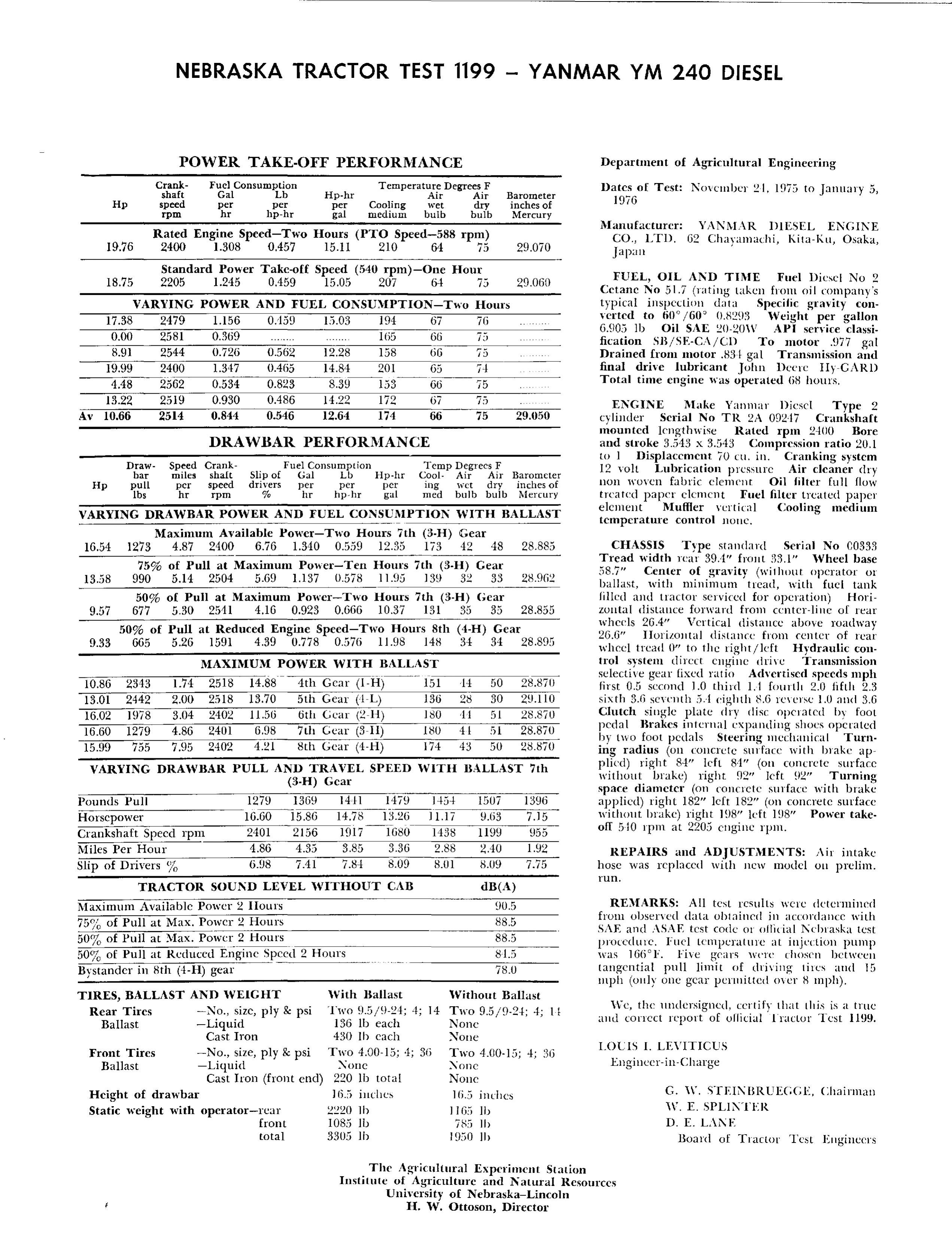

Spot on, brother! I had no idea such awesomeness exits.
   / YM336D fuel consumption
Thanks! That's exactly what I was looking for.

Huh! tractor data showed nothing for a 2cyl. Ym2000 I guess having to use a calendar is kind of hard to believe. I gave up on Time per Gal. Yrs. ago :D
   / YM336D fuel consumption #6
Just use the one for a YM240. ;)
The fuel consumption data are accurate for the tractor, but I don't think the absolute pulling power they describe is generally applicable. If you look, they added 430 pounds of iron ballast to EACH rear wheel, after putting liquid ballast in them to boot! However, the PTO output is not affected by additional ballast, of course.
For S Putnik: you may get even better results than the test data would indicate: In the "Remarks" section, the testers note that "One
scratch was found on the front cylinder wall during final inspection." I don't know how big the scratch in the #3 cylinder was, but it may have cost the machine power and thus increased fuel consumption for a given power output.
