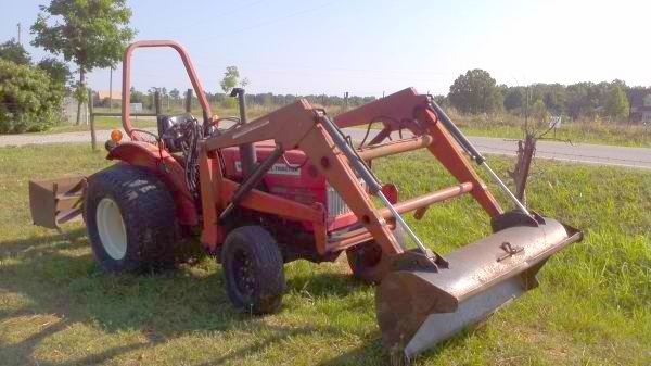

Hey Guys new here.
Just bought my first Yanmar tractor and it's a YM336D. So far so good. I will need to replace the tires real soon. It currently has turf tires, I'd rather have AG tires but someone said I'd have to change the wheels too.
The rear tires are 44x18.00-20NHS.All I could find on the front is 13-32.
Here are my questions..
What other size tires can I use on the rear wheels? I tried to find some rear tires the same size but that looks limited.
Do you know what size the front are?
If I want to put on AG tires, where can I get wheels to fit and what size do they need to be?
Thanks!

   / YM336D Tire Question #9
Can you post a picture of your current tires? I've never seen non-ag tires on a 336
Not a great picture, but only one I have right now. I just bought it last week. I really need some AG wheels, anybody??
