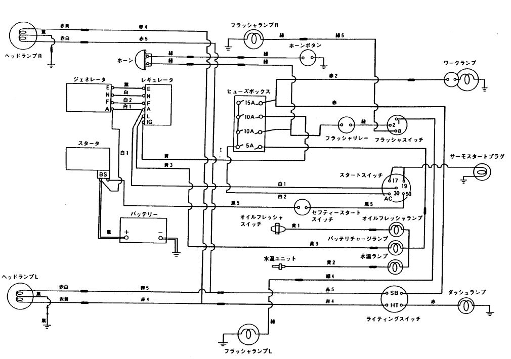

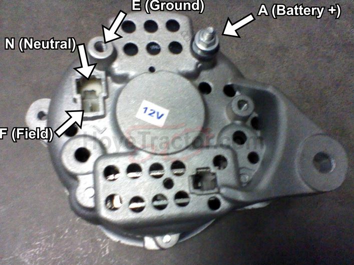

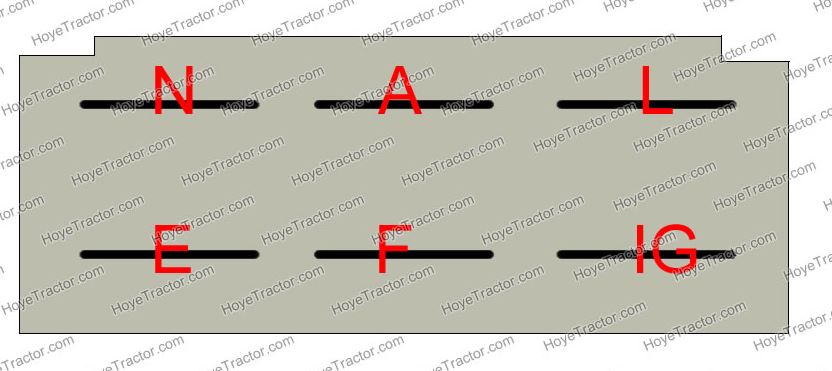

Need to know what actually needs to connect to my alternator (not the color of wire). I have a 'post', with nut, and a pair of male blade connectors ( have a matching blank plug.). Also have a new voltage regulator with pretty colored wires and a plug that actually mates to an existing plug. Main problem is that the entire harness has been cobbled so many times that I need to start over from scratch. Any assistance would be good.:confused:

Luckily those tractors don't have much for electronics and can usually be rewired pretty easily. I feel bad for the guy 10 years from now wanting to do this on a newer tractor though. :eek:
hope this helps.
Looking at the regulator plug- terminals facing you, narrow end (notches) at the top

Yea just buy some spools of wire. There is not much to these. Work one circuit at the time and replace one wore at the time. You will be done in no time
