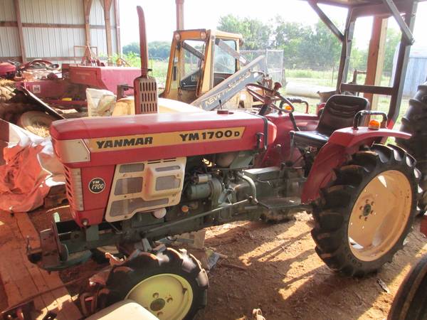

Well that's pretty much what I have ready & thanks for the replies. I talked to him tonight about the machine some. I asked him about how it started when it was cold & he said he only used it mowing in the summer, but it had glow plugs? I thought this had a decompression lever to start, maybe I read about a different model. He said it was nice, no leaks, headlights & everything worked with no issues. We will see what happens tomorrow on it.

I just seen the pic..that is a very clean 1700D..of course looks only go so far. I sold a 2wd for $2300 ..so that is a deal on a 4wd..you wait to long it will be gone.
If it starts easy..doesn't smoke like a chimney and the oil isn't milky you should be OK..check all gear ranges and ask him if it has ever overheated.. he may or may not tell you the truth..one thing is since it doesn't have a water pump it shouldn't have 50/50 antifreeze..more like 80/20..water/coolant. If to much coolant it will not flow well in the thermosyphon system..Google that to understand how that works.

Well it checked out great. I couldn't find anything wrong with it. All lights & turn signals worked. Someone had added a small gauge cluster below the instrument panel, I liked that also. oil pressure, amps, & coolant temp. A small home made weight on the front that was mounted up decent. I ran it around in all the gears, 4x4, hi lo range. You guys were right it steered really easy. Some small play in the tie rod joint, not major really the only wear I could find on it. He said it never had a problem with it over heating. I loved it, offered him $2400 & put it on the trailer. Its a little dusty from sitting in the shed, but hey I can clean that up. The home made canopy rattles a little at a certain rpm, but they did make the top fairly easy to take off, a couple bolts & pins & off it comes. He had a 5' finish mower & a 4' ford brush hog, which were not at the site of the tractor. Said he thought $300 a piece for them, I told him I was really interested in the hog, but needed to sale a few things first but would call him when some more funds were available. I am surprised you don't see more of these things around, a hole lot of tractor for the money!
