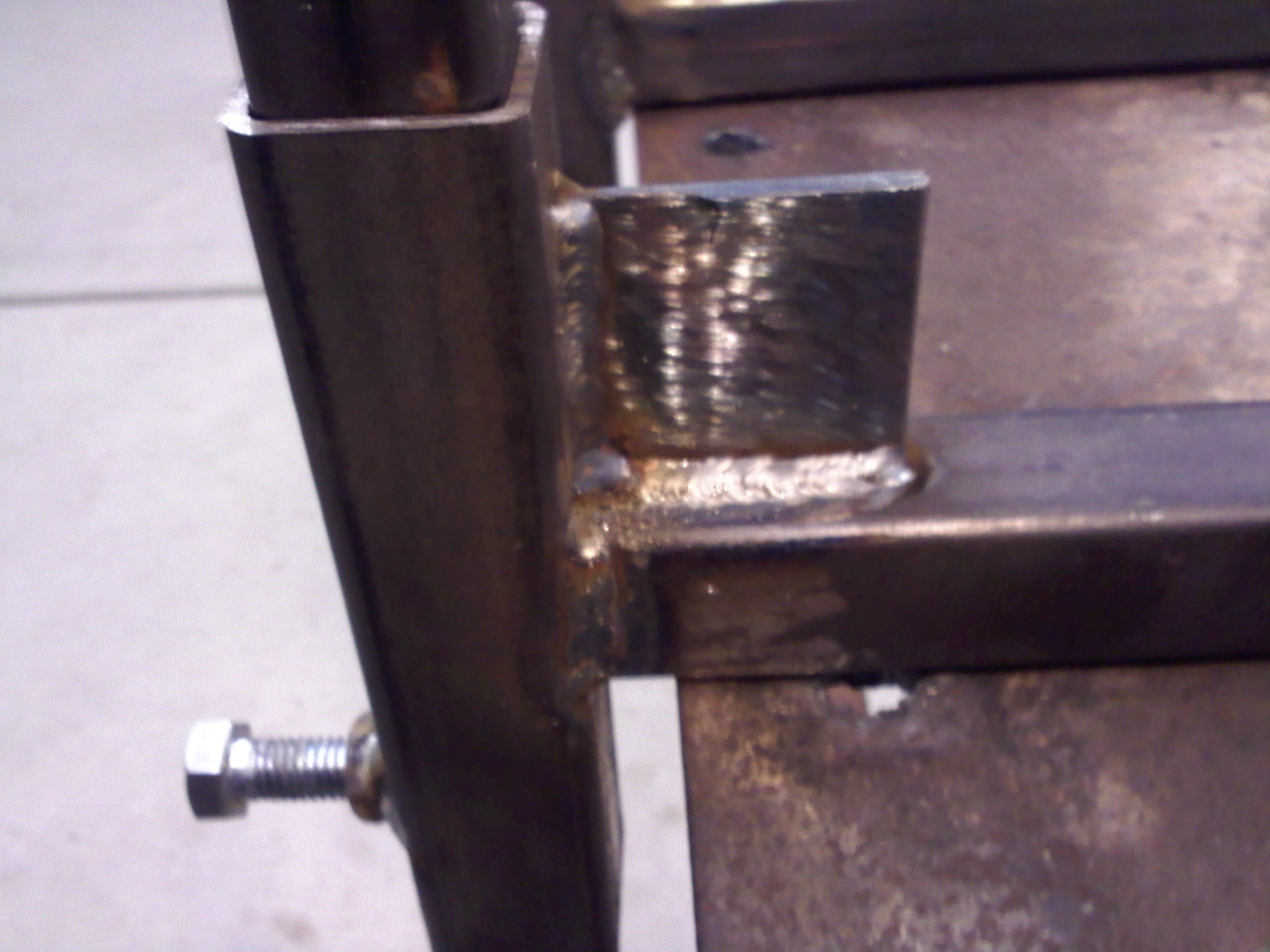

I want to add a pair of guide wheels to my york rake and i want to build them myself. I've searched the posts here and found some older ones that don't reflect todays supplies and prices. So my question is, has anybody recently added guide wheels and where did you get your supplies (wheels with zerk fittings) and what did you use to make them adjustable ? Pictures would be very helpful. I have a basic idea of what I want to do but there's nothing like prior experiance and pictures to get it right. I do have welders and plenty of steel stock but just want to get it right the first time. One problem I see already is where I want to weld the brackets on, the bolts for the tines are in the way. I know this is an old beat to death topic but a little help would be appreciated. I have a King Kutter 6' Rake.

Sounds like you have the skills and wherewithall so I think it is doable. Here are some gauge wheel photos on my 8' York RI. Notice the 1/2" plate anchoring the gauge wheel strut. The bolts are also holding the tines below in place. Drill your plate to match your bolt pattern. The tires are 13X6.50-6 2 ply rating at 14lbs psi. If you need any measurements, let me know.
If you go on the York Rake (a division of York Modern Corp) website you will find the gauge wheel accessory for sale, not cheap, around $500.00.
Good luck!

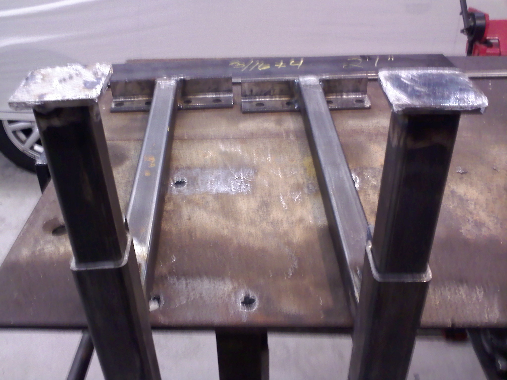

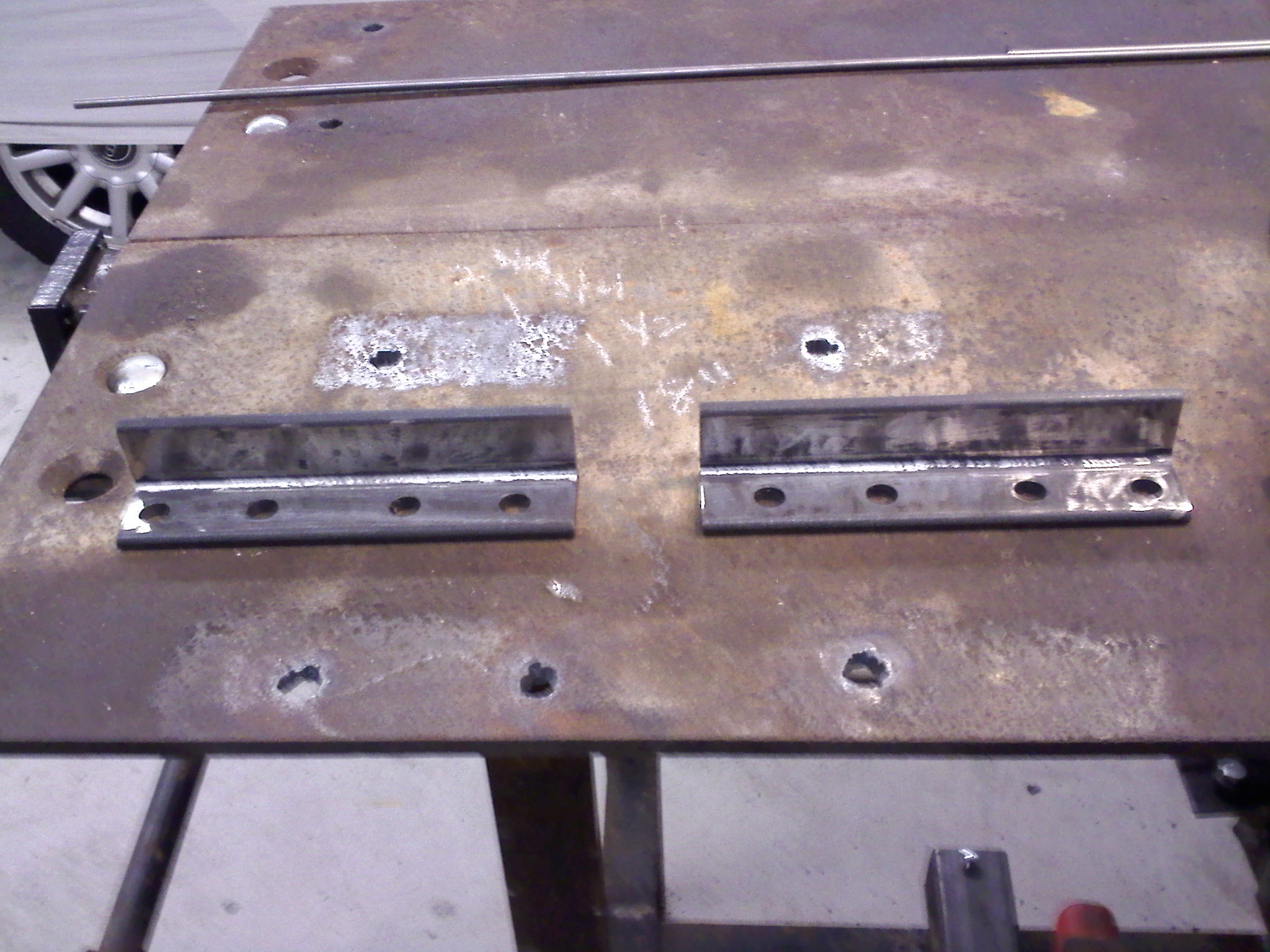

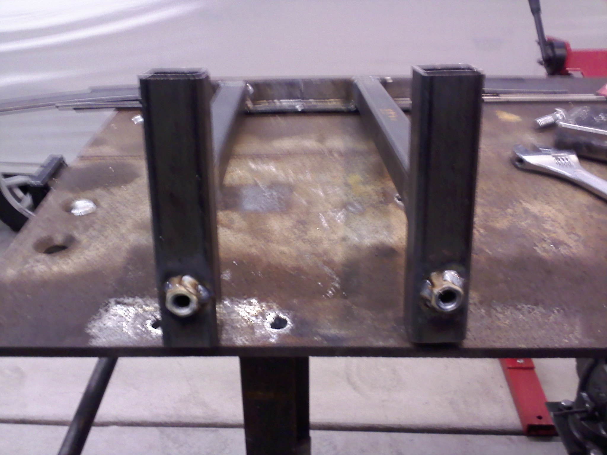

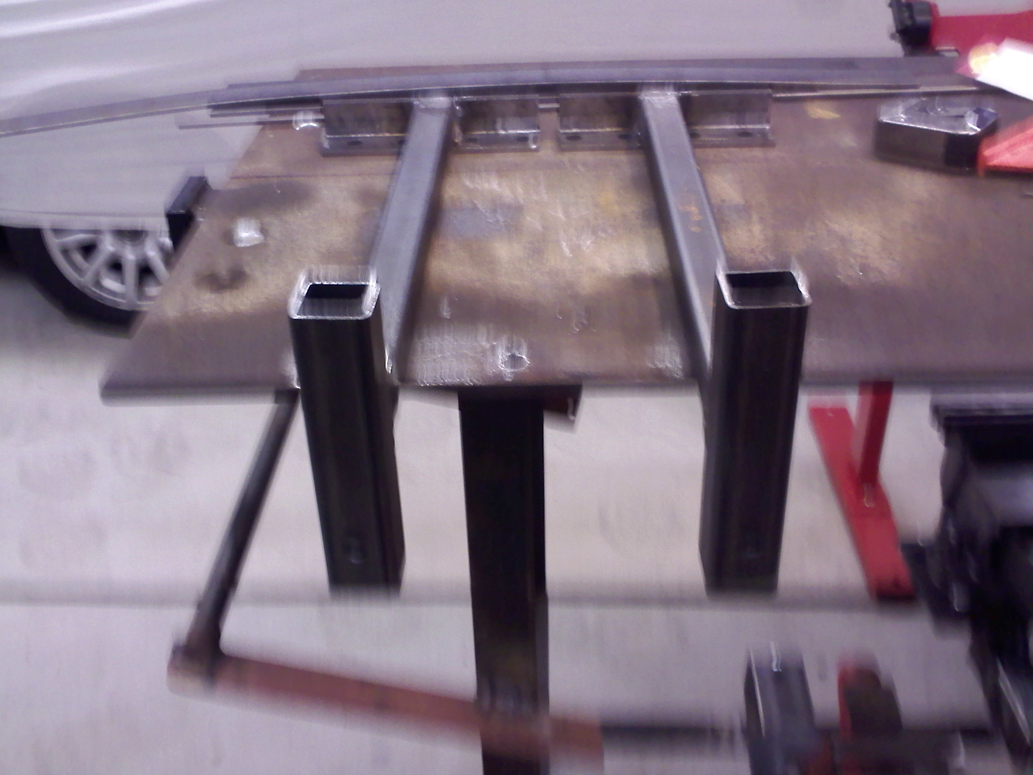

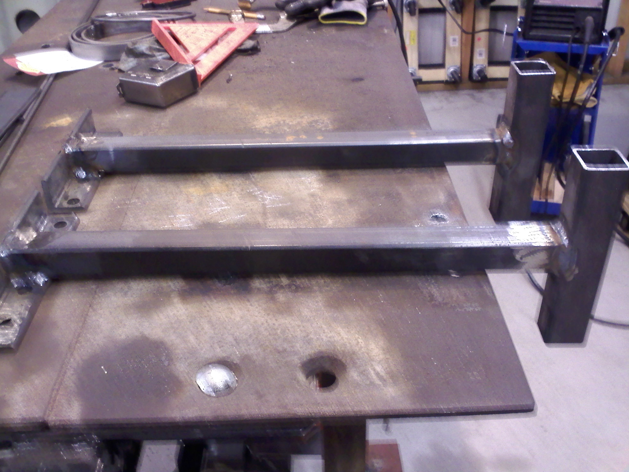

after a lot of help from TBN i started my build.
Picture #1 Brackets that fit the holes of the tines
Picture #2 Square tubing for over the tines support
Picture #3 Square tubing for legs
Picture #4 Welded up, Lincoln Mig .030 wire Argon Mix
Picture #5 1/2" nuts that accept 1/2" bolt to hold and adjust legs
Picture #6 Gussets for added strength when pulling forward
Picture #7 Caps to keep water out and stop the legs from falling through
Picture #8 Just have to buy some tires, wait for the mud to dry up and try them out
Thank you everybody for your input and help

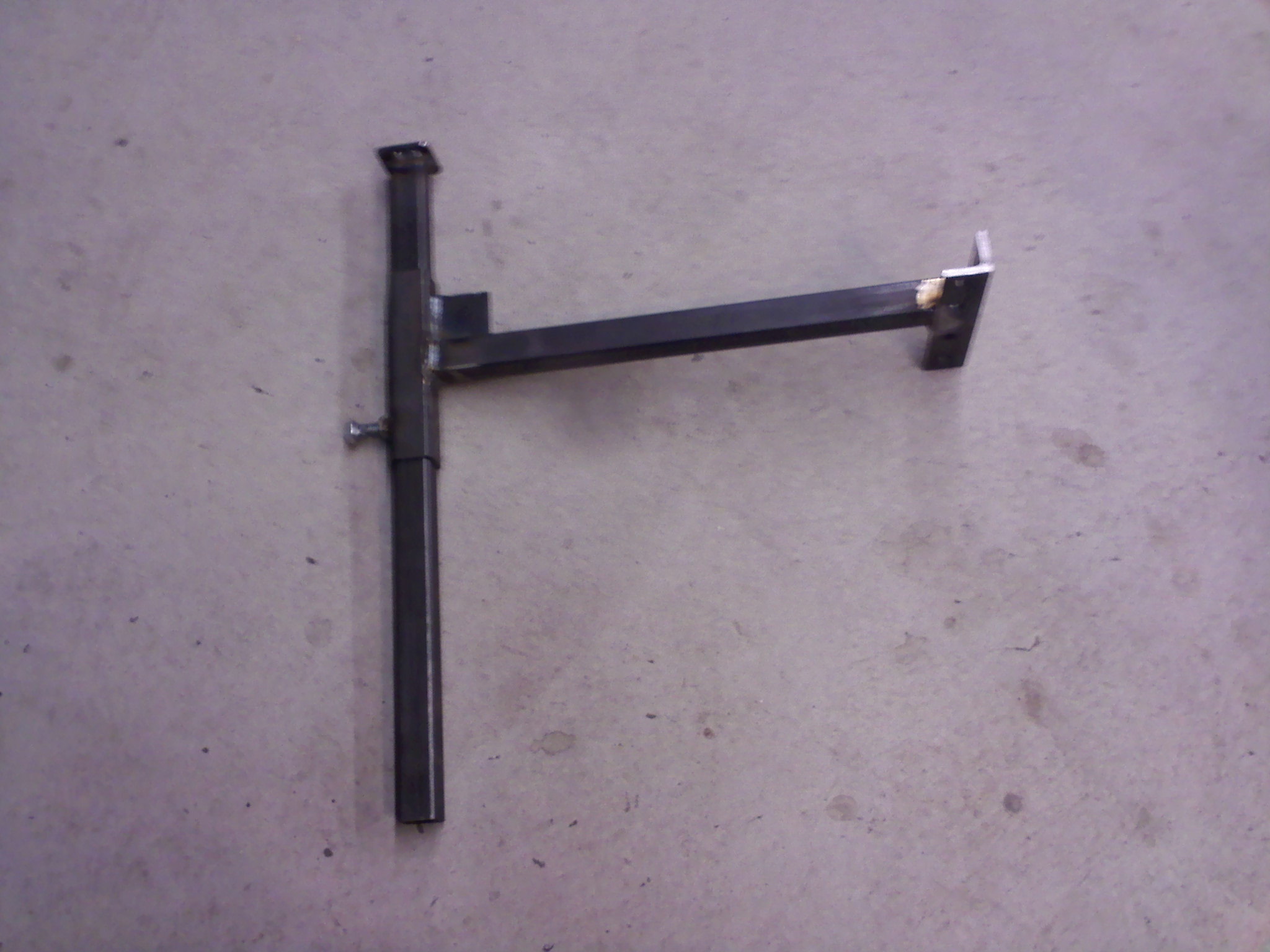

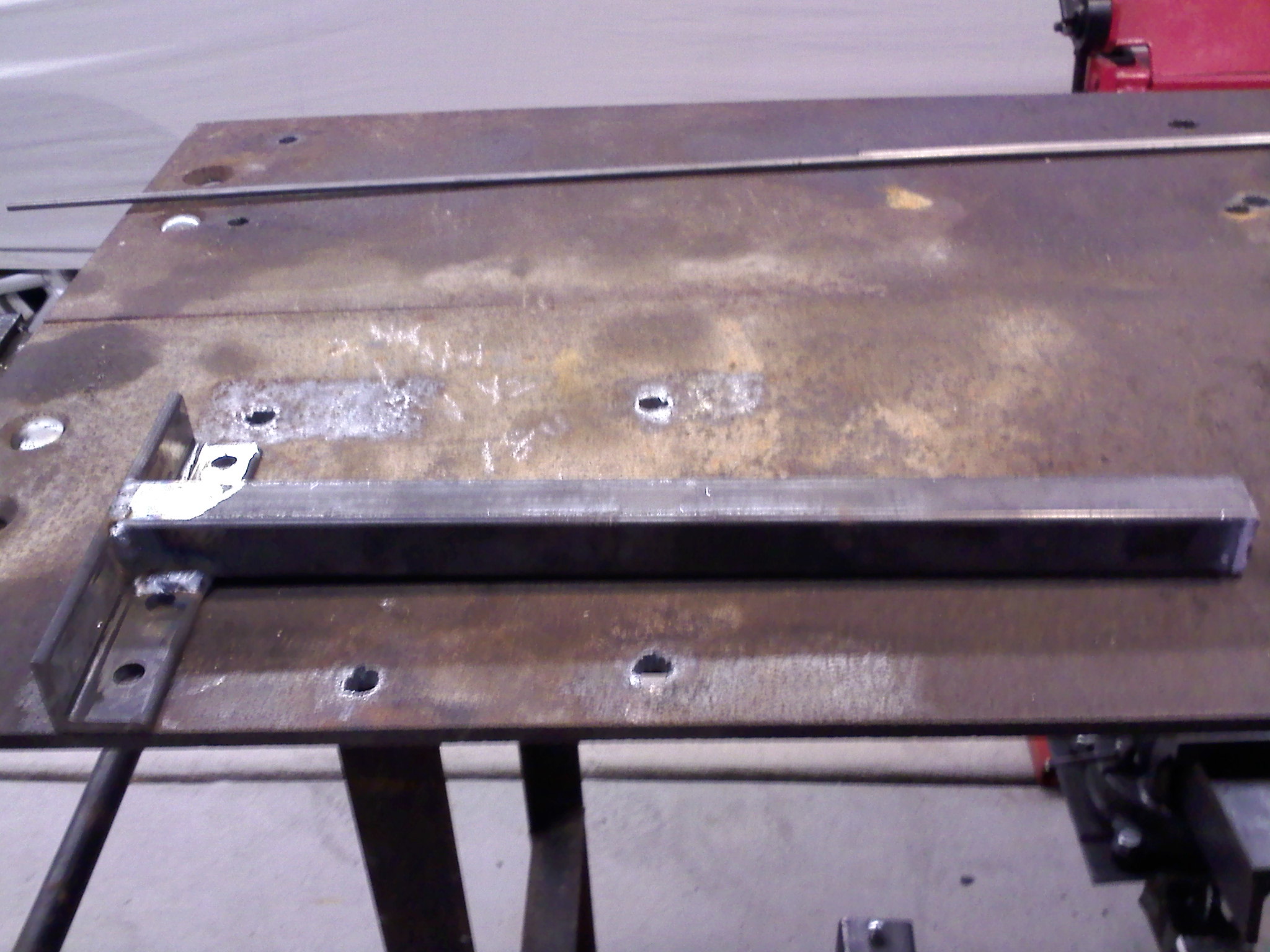

/ York Rake Guide Wheels
#15
other pictures

/ York Rake Guide Wheels #16
Wow JJ,
Nice work! Are you building the casters or buying? Whatever you do, post pictures when is done and painted. Those welds look mahvelous to me!
