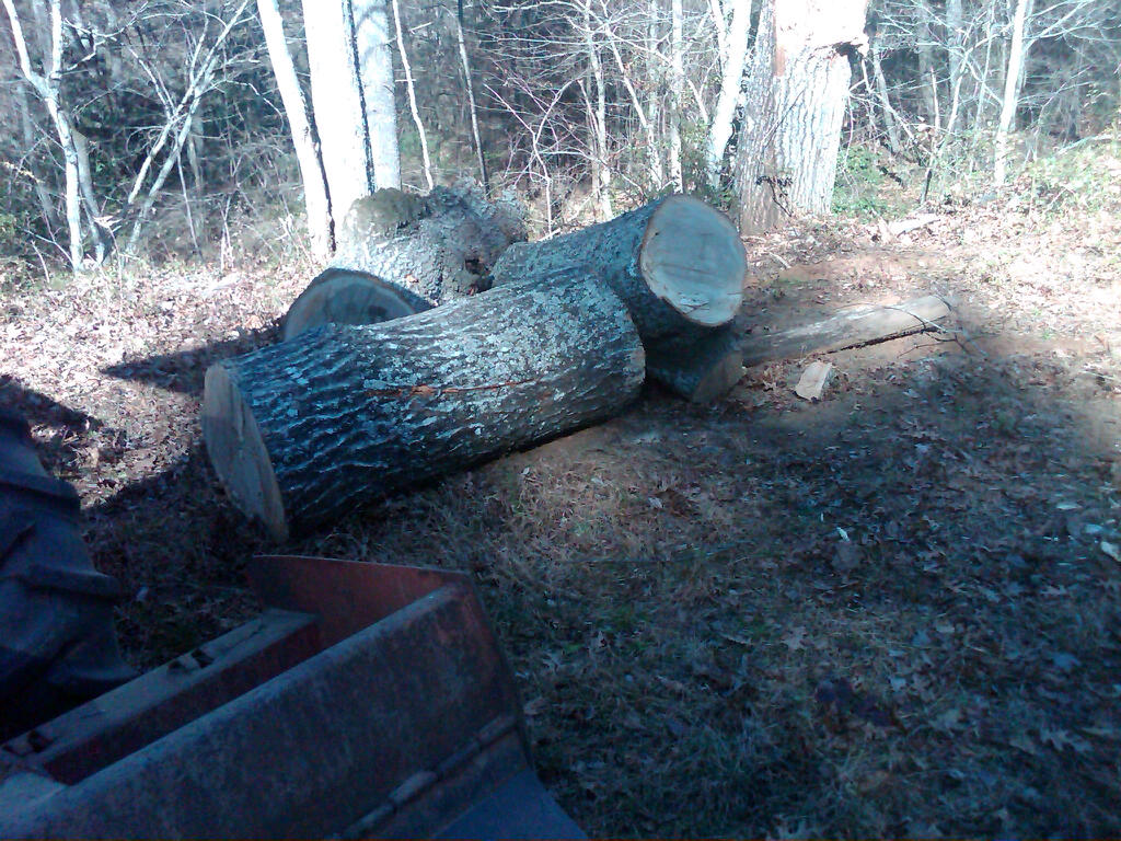

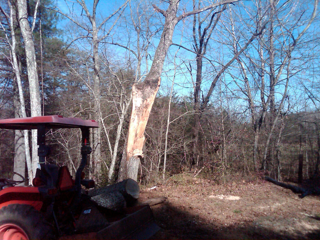

I have cut a lot of trees but wanted to get another opinion on this one.
A few weeks ago I have this large oak split at the forks and fall across the secondary road I use to get to my field with the truck. I have another access I use with the tractor and mule.
When the tree fell the top rested on a tall bank to the right, out of view in the picture. The lowest point where it was still attached to the tree was about 5' with the top about 8-9' off the ground. I was able to take a few large limbs off and cut the fork free from the main tree, then cut a few logs off. I was a little concerned about which way the fork would fall but it all worked out and I was extra careful, considering the size of the fork. The 20 bar on the Sthil would only reach about 3/4 of the way through. Gonna be fun splitting this up.
My question concerns the part still standing. You can see where the split happened and it took half or more of the total diameter of the tree. The lowest point where the fork split is about 4.5 off the ground and behind the tree is about a 10-12 drop off to a creek. The tree leans towards the drop off but I am going to try and drop it on the road bed.
The split is what concerns me. With the weight of the tree leaning and half the diameter missing I don't think I can cut the area that is split without the cut causing the tree to split or twist and splinter, if you follow me. The part below the split is around 40" across which will require notching from both sides, which will be difficult due to the drop off.
And I cannot cut at the split area without standing on something.
What is the best way to attack this?

Had a couple similar situations. I dropped them where they wanted to go and pulled them out of the creek with the tractor (or in your case up & out of the drop off). I certainly wouldn't cut up in the split for the reasons you already mentioned.
After notching, plunge cut & bore out the center leaving a hinge and trigger. Then cut the trigger & watch her go.

What you could try is preloading the tree with a rope that is strong but will stretch. A bungee if you will. Take your time and get the line as high as possible so you have maximum leverage. Next, make a shallow birds mouth cut on the uphill side. Now tension the line with a tractor that far enough away that the tree won't reach it. The idea is to start to pull the tree in the direction you want it to go. Pull as hard as you can. Here is the trick part: make a plunge cut with your saw a couple of inches away from the back cut. Bring your saw towards the back cut taking the time to make it parallel. Stop this cut about 1" from the birds mouth so you don't pinch your saw. This will become the hinge. Now with the saw WFO, cut in the opposite direction and out the side of the tree. This will release all the tension at once and hopefully give the tree enough inertia so it will swing in the correct direction.
With that much lean, I don't think you'll get the tree to fall towards you (in the picture), but maybe you can get it to swing to the right and land next to the tree line. Be careful because these leaners can barber chair.
This video parallels what I was trying to say, but I like the use of the wedges to stabilize the tree when the back cut is made. I would have tied the line higher in the tree so there was more leverage. https://www.youtube.com/watch?v=N_z9Lkw8sbI

I'd fill in the area around where the stalk could be flush with the road with fill or the cut sections to give you a place to cut from, and then cut it and let it fall the way it's leaning and wants to fall. Where it split is rotten, (blackish color of remaining stalk), and the mass of what's left wants to go to the creek, NOT where you want to force it to go.
You can cut up the fallen stalk after dropping it down the hill and winch the pieces. That stalk is too risky and too much mass, too high off the ground to try and force it to go where you want it. You want to be safe, then read the tree's position and act accordingly.

But you guys are thinking alone the same lines as I was. My biggest concern was the "barber chair" split. I will cut as low to the ground as I can with the birds mouth and do the plunge cut, I have done this before.
I am afraid to rope and pull simply because of the way the fork split off. I think the pressure would cause it to split in half. I'll stay low and use much caution:D.

When pulling on a tree, you run the risk of it barber-chairing if you put too much tension on it. A plunge cut with a holding strap can help this. Also consider wrapping a chain around the trunk above where you're cutting so if it does barber chair it doesn't vertically split & open up above your head.
Use wedges, cut strap then run and pull like ****.
