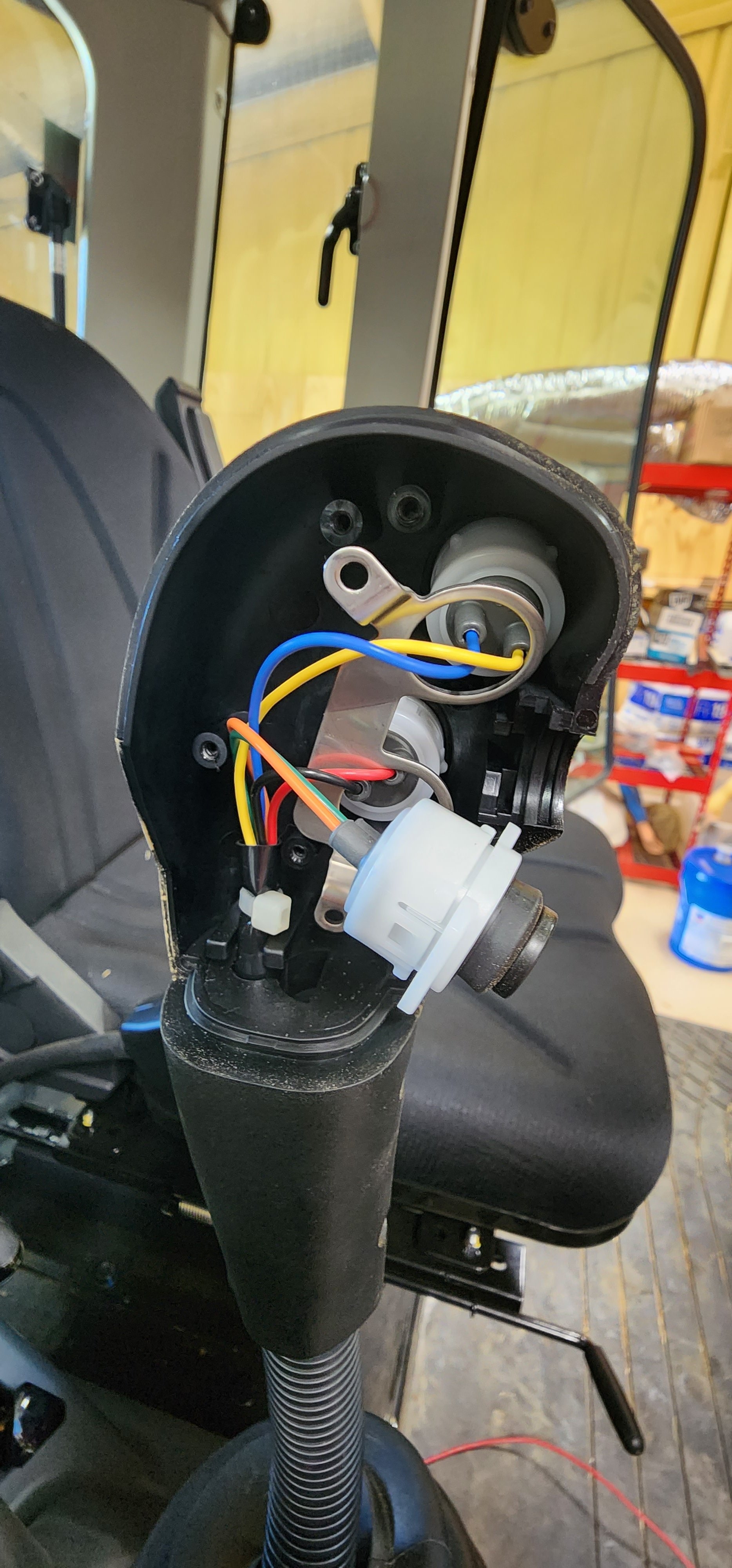

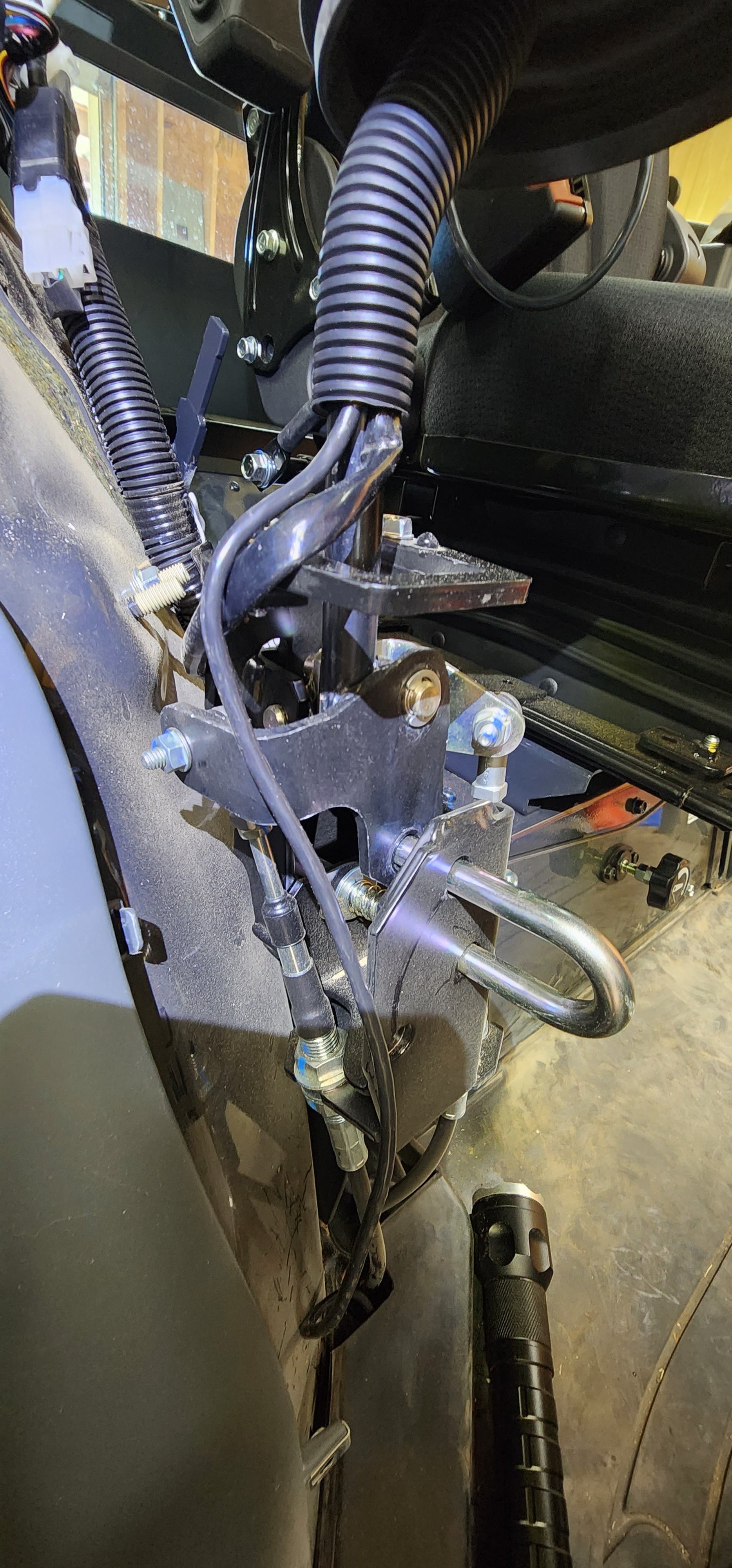

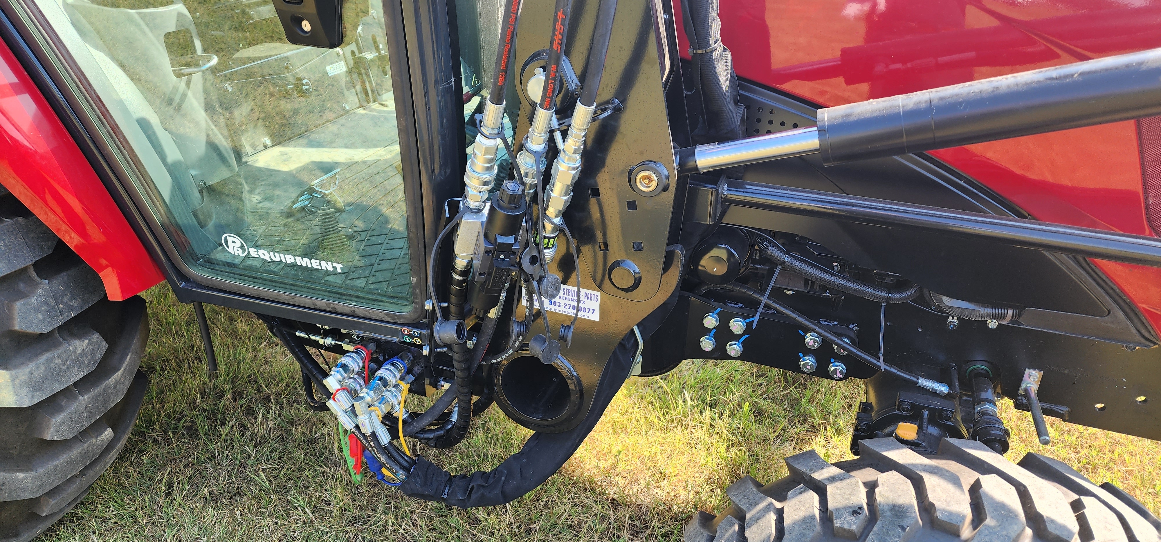

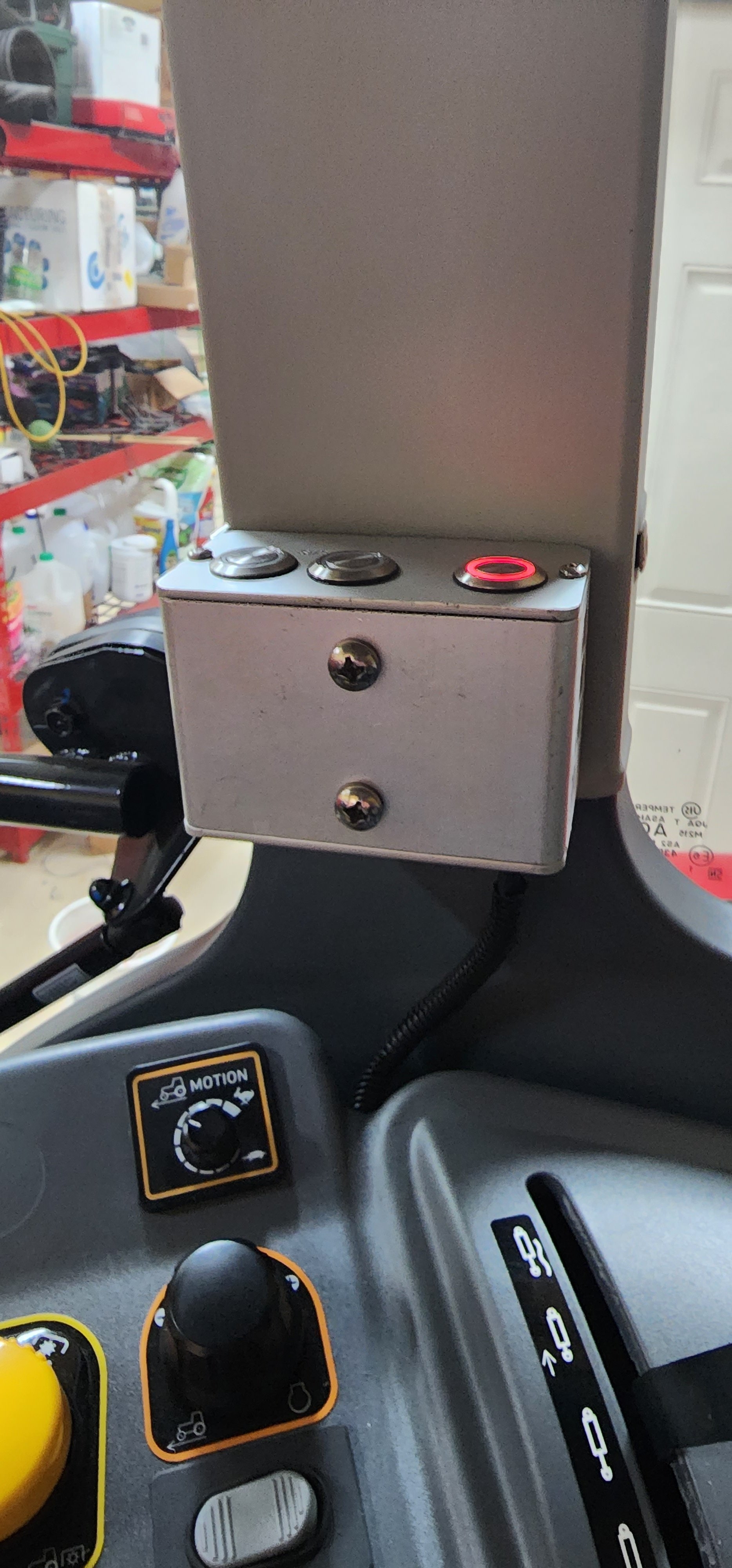

Having just purchased a YT359 two weeks ago, I went back and forth on this as well. Both dealers and the Yanmar EVO folks said the same thing as above, the WR Long is not as well integrated from the plumbing, to the handle, to the way it mounts to the corner of the cab above the loader connections. That pushed me toward the Yanmar 3rd function on mine. While visiting the EVO store, I got to see the WR Long on another tractor and it certainly sticks out. The service folks there also said you have to modify the harness for the loader handle to make it work.
There is a slick(er) implementation of the WR Long done by PR Equipment in Texas, they use the factory loader handle and install a custom switch where the diverter button is. You can see it on couple of their Youtube videos on the YT. Probably the best solution of all is if you're able to do a custom install of the WR Long with better placement, better plumbing, and a modified OEM loader handle. I'm still holding out judgement on how valuable that live 3rd function would be for me.
   / YT359 Third Function Options #5
I took delivery this week of a YT359c and went with the Long because of the buttons. Also read that the diverter style in general (overall not Yanmar) don't hold as well. The Yanmar setup is much cleaner and you can feather. Was a tough decision for sure.
This shows The Long on a rops model aroung the 1:15 mark
. Mounts the same on the cab version.
