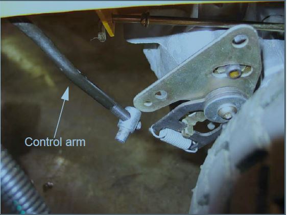

I've done mine back a year or so ago, and its pretty straight forward. Remove the deck, jack up the rig from the front and crawl underneath. You'll see hime joints (spelling?) at each end of several threaded rods. Each joint has a locking nut. Loosen both (one at each end) and then rotate the rod to lengthen it or shorten it to where you think it needs to be and lock down the nuts, Lower the tractor and try it out. If correct, reinstall the deck and cut grass. If not, go back under again and do some more messing around.

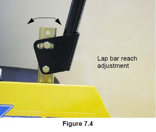

I have attached a couple of photos I got off other manuals which I believe are much older models.
The one that pivots (yellow photo) looks the easiest way so I adjusted it like that ( I didn't notice it at first because the washer covered the pivot slot but I figured it out.
So Gene are you referring to those Control arm Ferrules down on the neutral plate below, If so I don't see why you would need to remove the deck to do it that way? So are you out of room up above on the pivot slot?

The yellow photo is just an adjustment to position the lap bars forward and backward but has no effect on the actual drive. When the adjustment is made (found) to equalize the drive on both sides, then the lap bars can be adjusted to both be centered.
