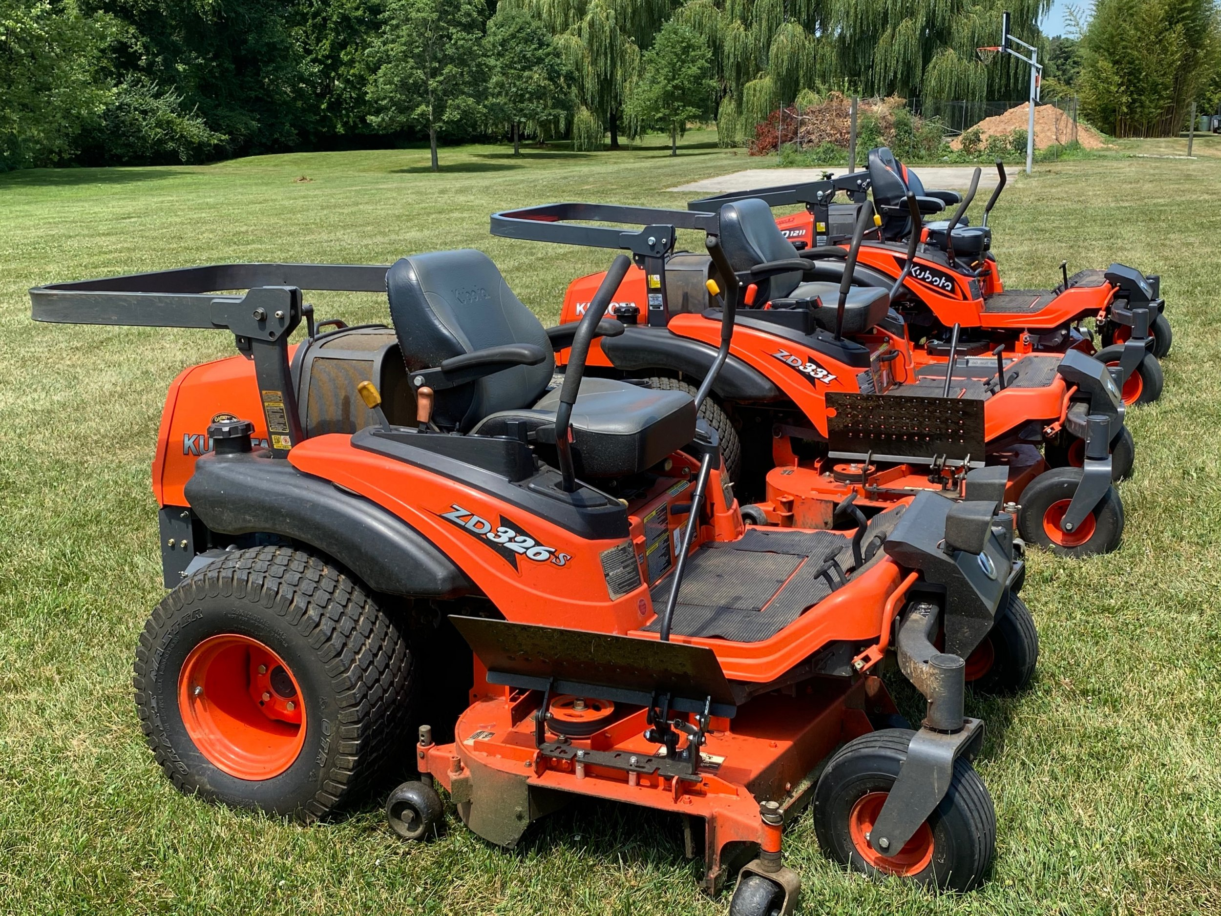

Here’s a photo showing the chutes on a 326 and 331. The 1211 in the background didn’t have one installed yet, but does now.

Does the lever get in the way? How hard was it drilling the holes in that thick deck?

The handle doesn't get in my way, but it would make it harder to get on the mower from the right side. The drilling wasn't particularly difficult, and the install takes maybe 60 minutes or so taking time to plan the holes etc...
I positioned the gate and spacers for best fit, then center punched through the spacers to mark the holes for drilling.
I will say that it's a long reach to operate the gate on my 72" deck, but I got used to it.

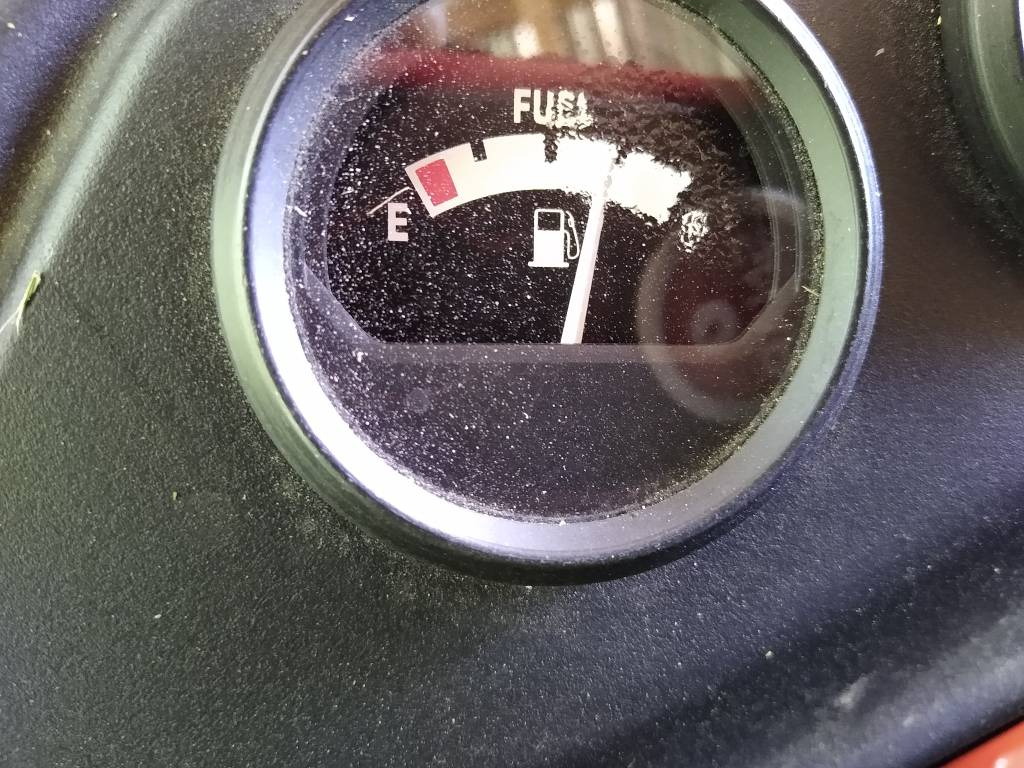

I was worried about not getting the dual fuel tanks at first. So for comparison on fuel usage. My Badboy had a 6.5 gal capacity and the Kubota has 6.1 gal.Normally I could empty a 5 gallon jug after mowing with the Badboy.. This is how much I used this morning mowing.
Pretty impressive machine.

I have no experience with Kubota's chute blocker, but the Advanced Chute Systems works great on my ZD326 and 1211. I wouldn't be without one.
Pros :
-I can close or partially close the chute to prevent grass from plastering objects, or getting into flower beds. Even with close attention to my pattern there is always the occasion where I'm throwing the wrong way.
- 99% of the time I'm mowing with the chute wide open, dispersing clippings better than with a standard non adjustable chute.
- They're great at mulching leaves in the fall
Cons:
- Not cheap!
- With the chute closed, they leave a noticable windrow, so I have to go back over the row eventually.
