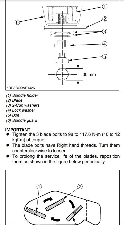

My ZD326 was laid up for a couple of weeks while I repaired the fuel gauge and with the hot weather and lots of rain we have been having my grass grew rapidly and was a lot higher and thicker than usual. I also have a mulcher on it which makes it even harder to cut tall grass. I bought 2 new cup washers for the blade and torqued it to 95# but one of the blades will slip and make a terrible racket when it gets in the tall grass. Anybody have a cure for this?

Just for reference here is a picture of the setup tallyho8 is describing:
Is your lock washer #4 in good shape?

Assuming the op has the bellview washers oriented correctly, I would be inclined to torque the bolts a little more. Perhaps add a 3rd washer and increase the bolt torque if there is enough thread (I've never added a 3rd washer).
I don't use a torque wrench on the blade bolts for my zd326 or zd1211, but I'm sure I keep them tighter than 98 ft/lbs.

I wire brushed my blade down where the washers connect to it and I tightened the bolt to 110# and tried it out and it is working ok now. My old torque wrench might not be too accurate anymore. Time will tell if this works.

Just the other day I removed my blades off my ZD1211 (I agree stupid overly complex design) to sharpen & balance. When I reinstalled them the right side blade screw would spin the shaft while trying to torque to 80 lbft & I’ve had them of many times with no issues. I removed it and checked assembly, it was proper & clean so I tried again to torque & once again it slipped so off with two blades to swap assembly’s with same results.
Had to touch it with the impact slightly before it would reach torque.
On my machine the cupped washers were assembled opposite from the drawing above.
When I removed them for the first time a couple years ago it was obvious due to witness marks how I received to machine so I reassembled the same way.
I just checked my shop manual & it is the same as thclimer.
Looks like I need to turn them around before damage is done.
