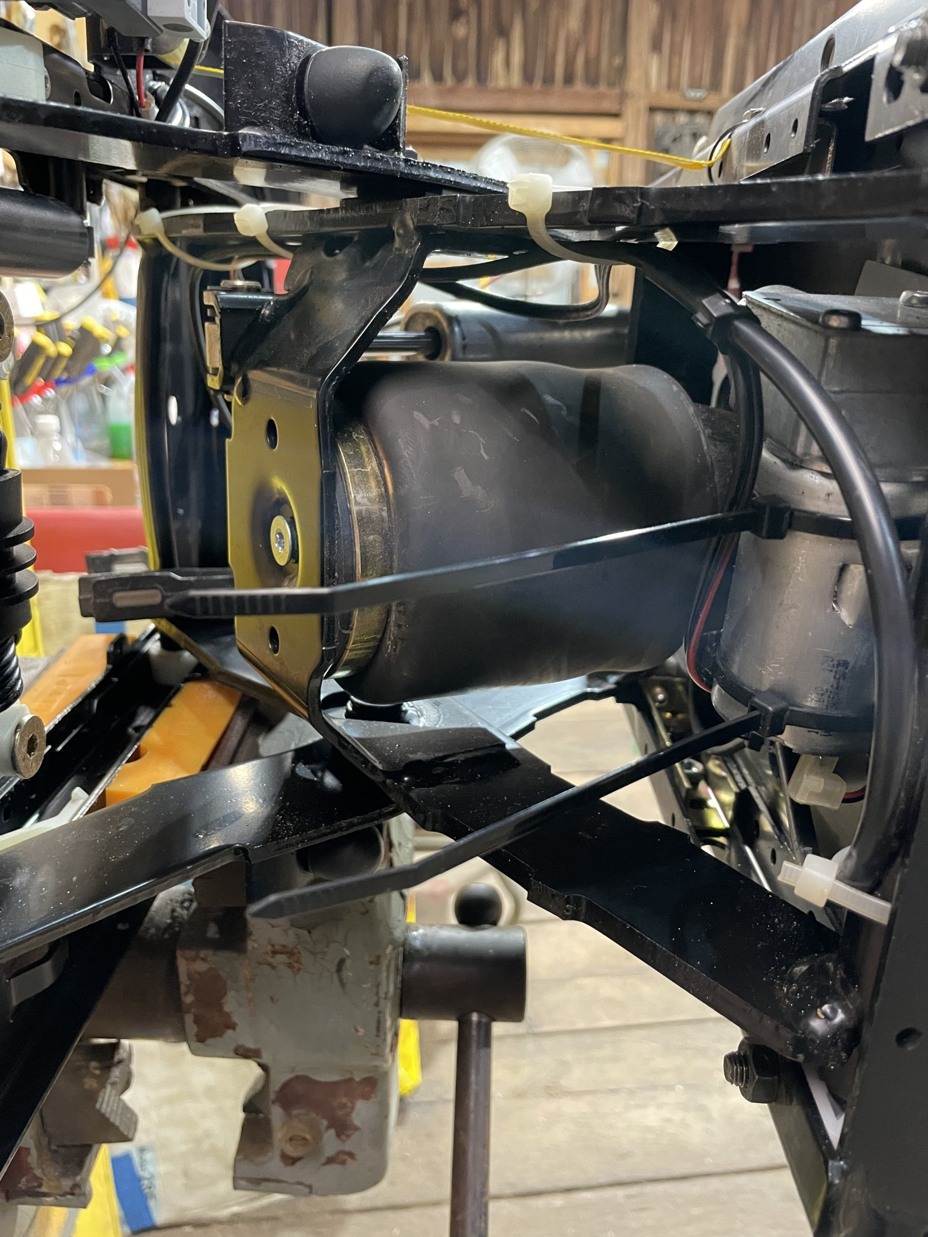

I was going to use the winter down time to retrofit an air suspension seat to the 331. The stock suspension seat is not very good and it slows me down during mowing. I am working on getting a Grammer seat base functional and using it on the mower. Turns out a wire was pinched inside the seat and that prevented the compressor from turning on. More to come on this
   / ZD331 air suspension seat
#2
IMG_0452.jpegHere is a pic of the suspension seat frame . The wire was pinched and the internal compressor did not come on. Connecting to the cut end of the wire makes the compressor operate just fine.

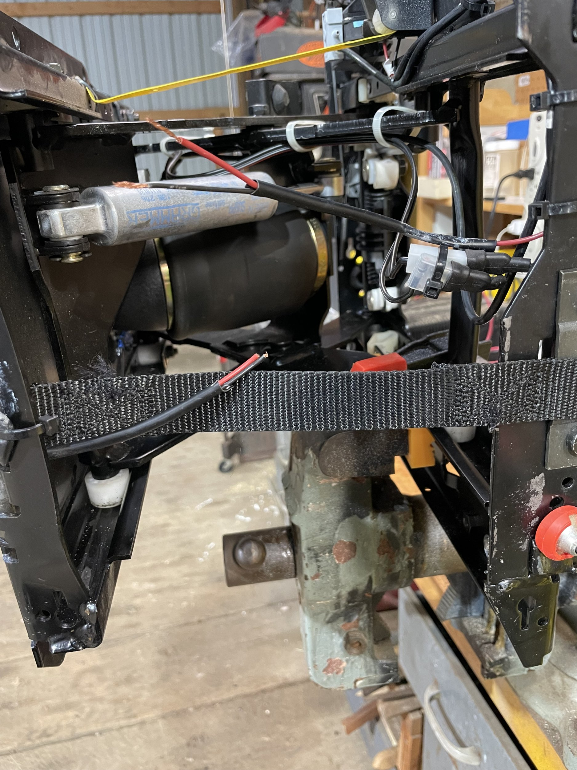

IMG_0453.jpegThe small compressor can be seen to the right in the picture

Hmm....somehow I expected the underside of a Grammer seat to look different from that photo. But that's just one view. How does the overall build quality look to you?

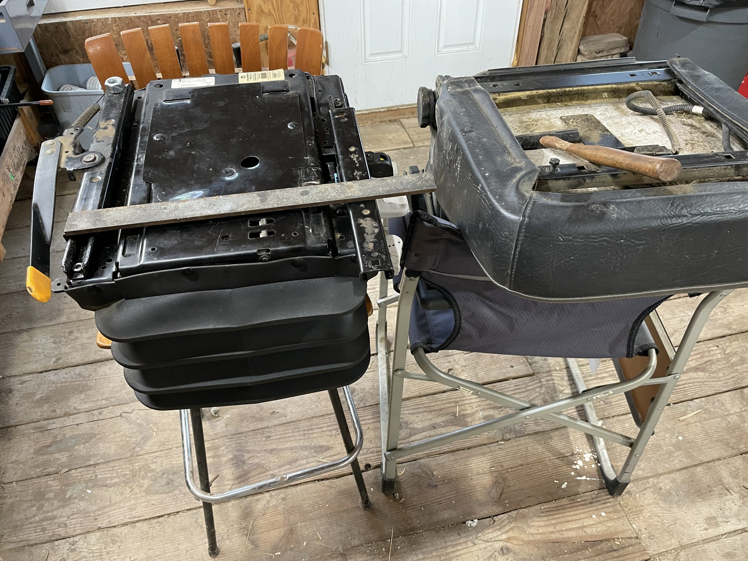

This is how it looks under the bellowing rubber cover. It is shown in the profile picture mounted in the cab of the M7040
The seat does not fit the bolt
hole pattern.
So next step is the make a couple of brackets

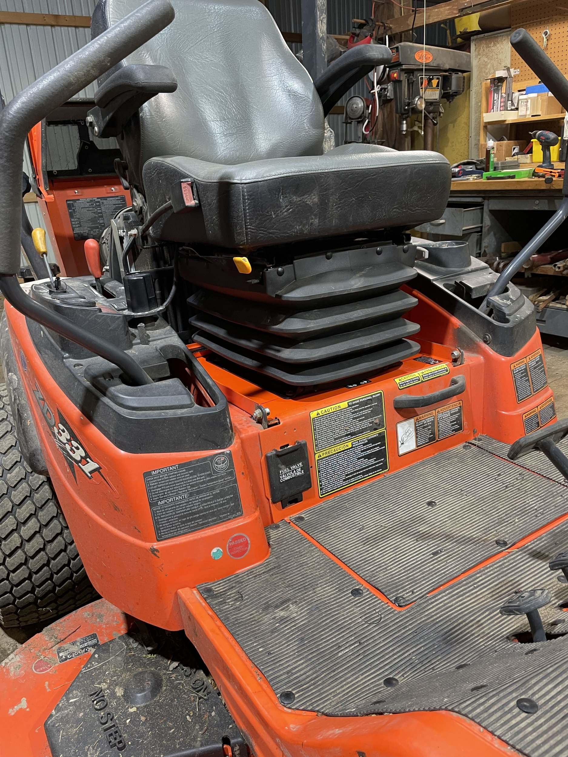

Was able to get the seat mounted to the Grammer air suspension base and mounted to the mower. The seat was tricky to fit but eventually I figured it out. The seat sits higher than before but the level can be adjusted with the air pressure to a comfortable level and good range of suspension

Thanks for posting your seat upgrade. I have a Great Dane ZTR that rides pretty rough. I have to go slower than I’d like due to the beating I take. Did you have the air ride seat on hand, or purchase it for this upgrade?
