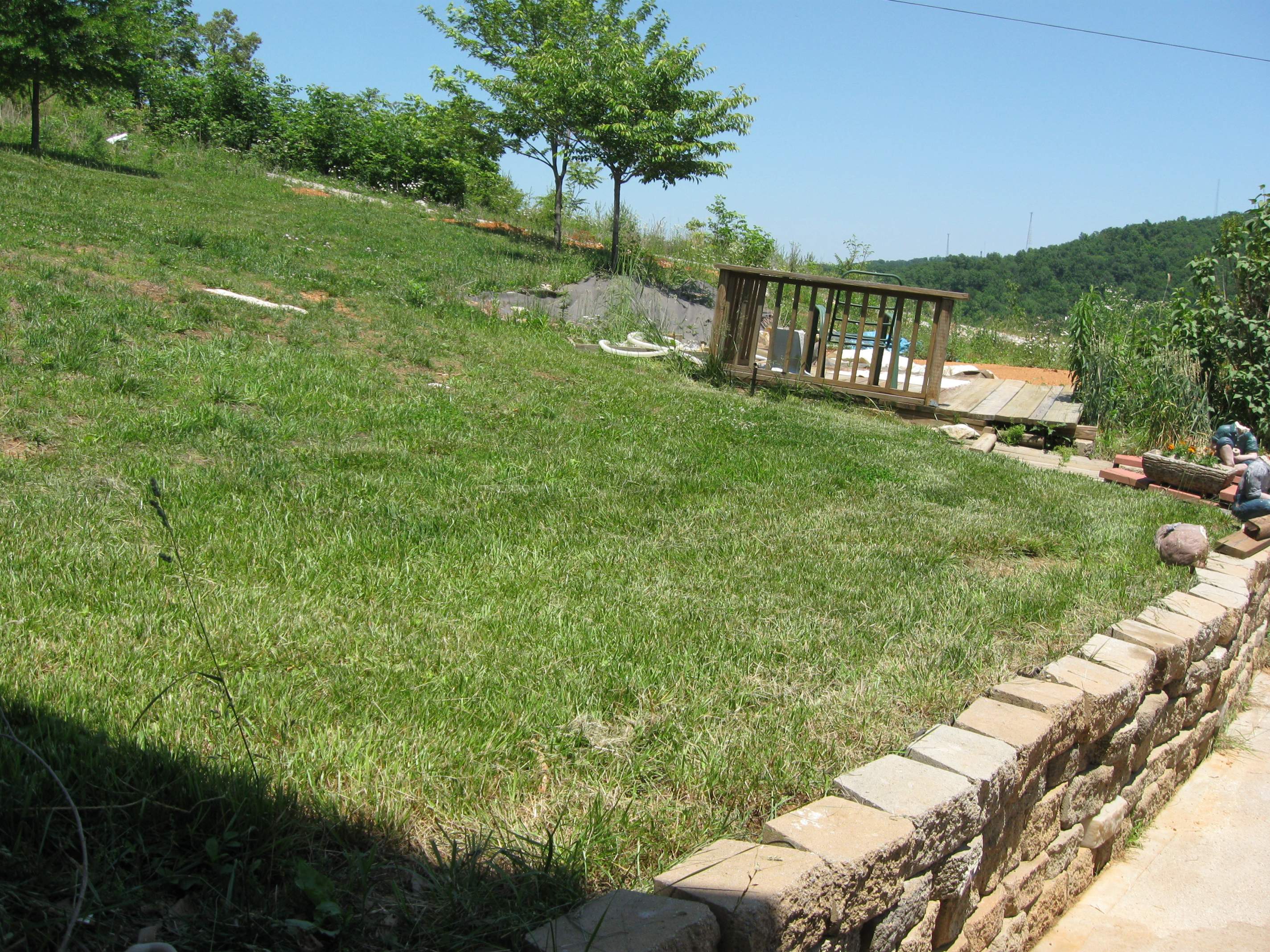

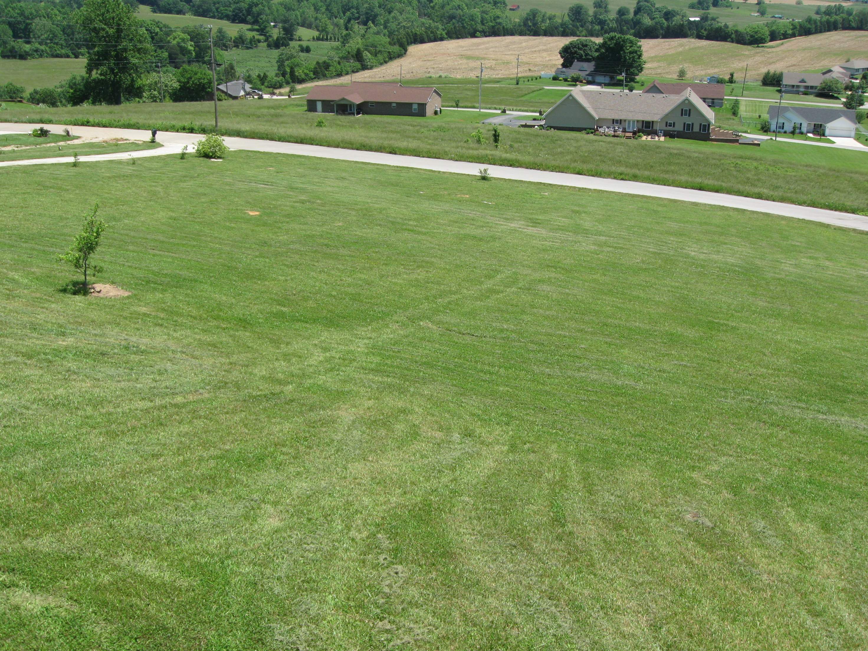

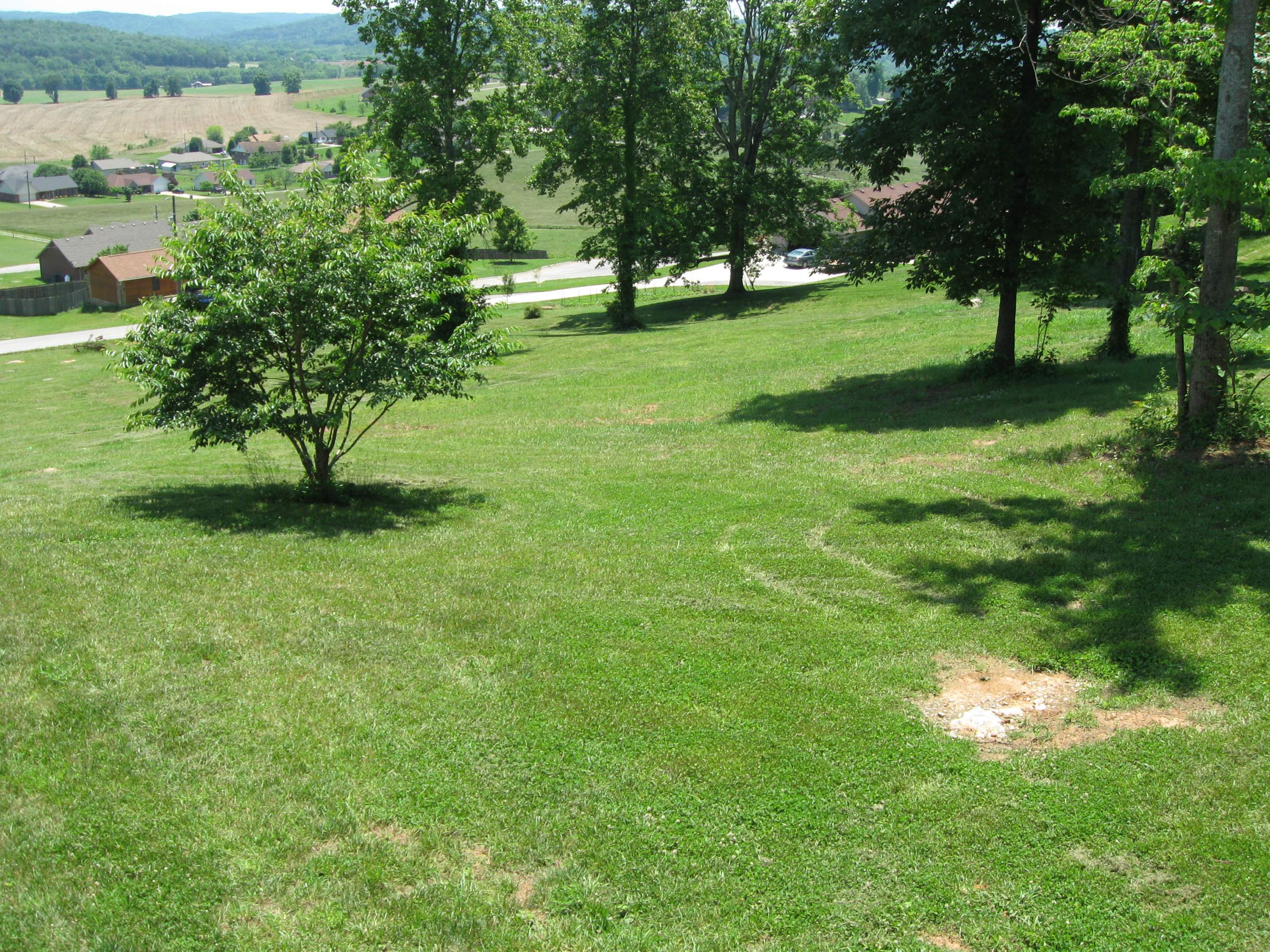

I mowed my yard yesterday with my F2680 with 60" Rear discharge deck. I had been gone and grass had gotten pretty high. Here is the way it looks with rear discharge after one pass. As high and thick as it was there would have been rowed up piles with a side discharge.
