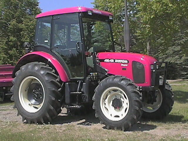

I own a 2004 Zetor 4341.1 tractor with cab, with 4X4, and with shuttle that I bought new this past February.
My question is this: My tractor operator's manual states that the large transmission filter located on the left side of the tractor under the cab can be changed without draining the gear oil from the transmission. Also, the tractor operator's manual says to put a 5 gallon bucket under the old transmission filter before it is removed to catch the oil that will come out before the new transmission filter is installed. Yesterday, I started to remove the old transmission filter, and oil came out so much that it filled my 5 gallon bucket full. I screwed the old oil transmission filter back on the tractor to stop the flow of oil, because I didn't have but one clean 5 gallon bucket. The transmission on this tractor holds 17 gallons of gear oil. I was afraid if I got the old transmission filter off of the tractor that I would completely drain the transmission, and I didn't have enough clean 5 gallon buckets to catch the 17 gallons of gear oil. I am wanting to know if anyone here on the TBN has had this problem taking the transmission filter off of a Zetor tractor like this one. I don't understand why the tractor operator's manual states that the old transmission filter can be removed without draining the oil from the transmission when oil comes out by the gallons when the old transmission filter is uncrewed. I am wondering if I did somthing wrong when I started to remove the old transmission filter. There has got to be some answer to this problem that I don't know nothing about.
If anyone here on the TBN has had this problem removing a old transmission filter from a Zetor tractor like this one please reply to this post. I am at my wits end trying to figure this problem out. I sure don't want to drain the 17 gallons of gear oil out of the transmission to install a new transmission filter, because this tractor just has 70 hours on it.

Well if you dropped 5 gals already your're pretty much committed. I bought a 30 gal plastic tub from a discount store to catch all the oils. Came with a cover which helped mitigate the mess when transporting to County oil recycling tank.
I recall about 15 gallons to refill.
Also replaced the copper crush washers on drain plugs - picked up at NAPA. Each drain plug has flat new style or button old style shaped magnet for shavings.
Note: there are different power steering filters - depending on metal or plastic oil tank, be sure to order the appropriate one the first time!

I e-mailed Laznicka Peter in Harrisburg, Pa about this Zetor tractor transmission filter question. This is his e-mail to me today 09/21/05 about this transmission filter question.
I realize that our procedure shoud probably say "have 3 buckets ready", we
will have to correct it.
The reality is though, that the filter should screw on the base easily and
quickly enough so no more than those 5 gallons will drain. Unfortunately,
there is no trick how to avoid the drain.
We have had this filter since 1998 and since it was (somehow) accepted by
our dealers and customers, it was not changed even for our new Proxima
series.
To be 100% safe, we should probably suggest to drain all oil. But who has 3
clean buckets handy on the farm, and who has some quick filling device, not
to have to pour 17 gallons of oil through the small neck in the bacK? So we
published this "shortcut", as developed by our service people.
As far as oil change, it does not matter if you change it now or later, at,
say 200 hours. Do whatever works for you better. If you already lost some
oil, do the change now and you will be done with it for several years.
Regards
Peter

I spoke with Peter today and he said the same thing. The filter housing was designed 7 years ago and they should probably change the manual to indicate the need to have more than one bucket ready, and maybe they should come up with something other than the small tube in the back where you check the fluid level by which to add fluid, especially if it is 17 gals.! He mentioned an electric pump to eliminate the pouring, but the tube will only accept so much per minute. I guess you just have to be quick about the change and try not to have all the fluid pour out.
