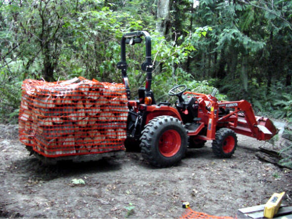

Another thing I would like to point out is the difference in the 3pt. lift capacity. That was one of the things that really pointed me toward the B7500. Notice that there is 50% more lift capacity with the B7500. I attached a photo showing what I do with mine. Palletizing my firewood is a real time/labor saver.
Aloha brings up another good option. I have a seperate riding mower for my lawn. I have too many tight places to get into to use my Kubota..... And hey, there's nothing wrong with having 2 tractors /forums/images/graemlins/smile.gif

The 3PH was one of the factors I considered - but seeing your picture - WOW! That's quite a load of wood! That picture alone may clinch it for me!

I showed my wife the picture that GregJ attached - with a huge load of wood on the 3PH - got to think that's impressed her on some level too.
