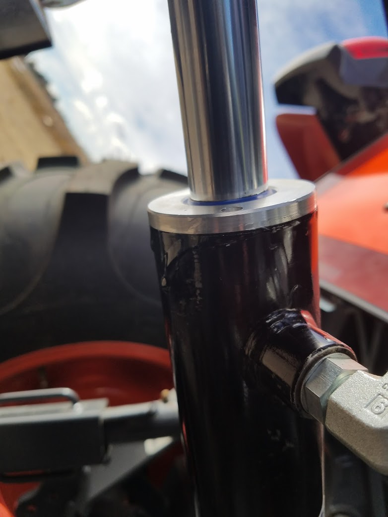

At the bottom you can see the PTO shaft cover covered in hydraulic fluid after a minute, the drawbar is completely covered as well. Also what should be OEM Kubota cylinders that don't come close to matching color & massively chipped up paint.
Actually looks like the fluid is coming out from behind that retaining nut rather than the seal.

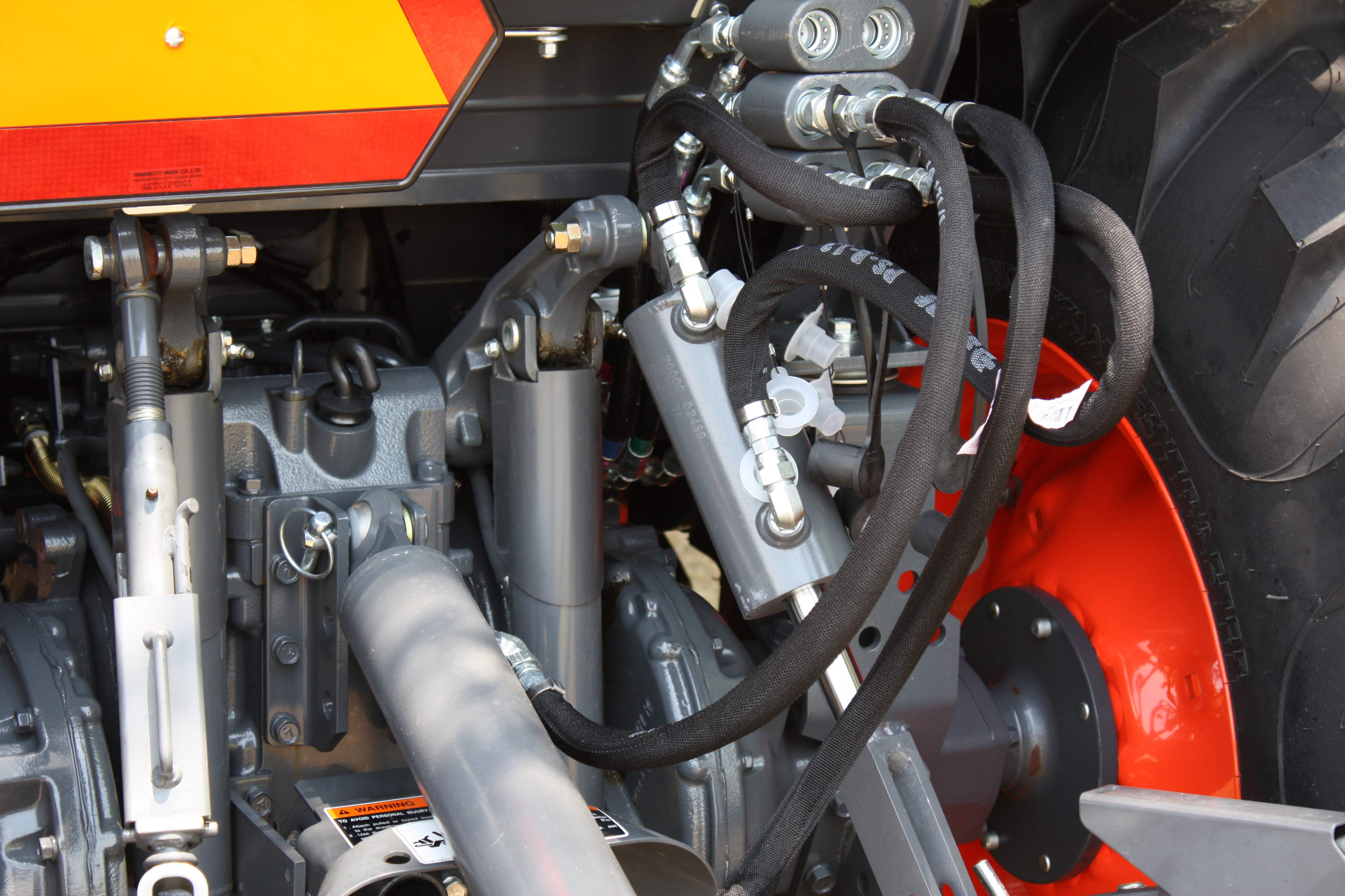

Leaky tilt cylinder fitting, drenched drawbar & a bit of the drenched trailer deck. Don't forget those ugly QC passed stickers on there.

Fallon, in your second picture where you say: "Actually looks like the fluid is coming out from behind that retaining nut rather than the seal", you could be right. The "O" ring seal on that cylinder end cap may have been pinched when it was initially assembled. I had the same kind of leak from one of the cylinders on my FEL on my L4200 Kubota when it was new. Replaced the damaged "O" ring and all has been good ever since.

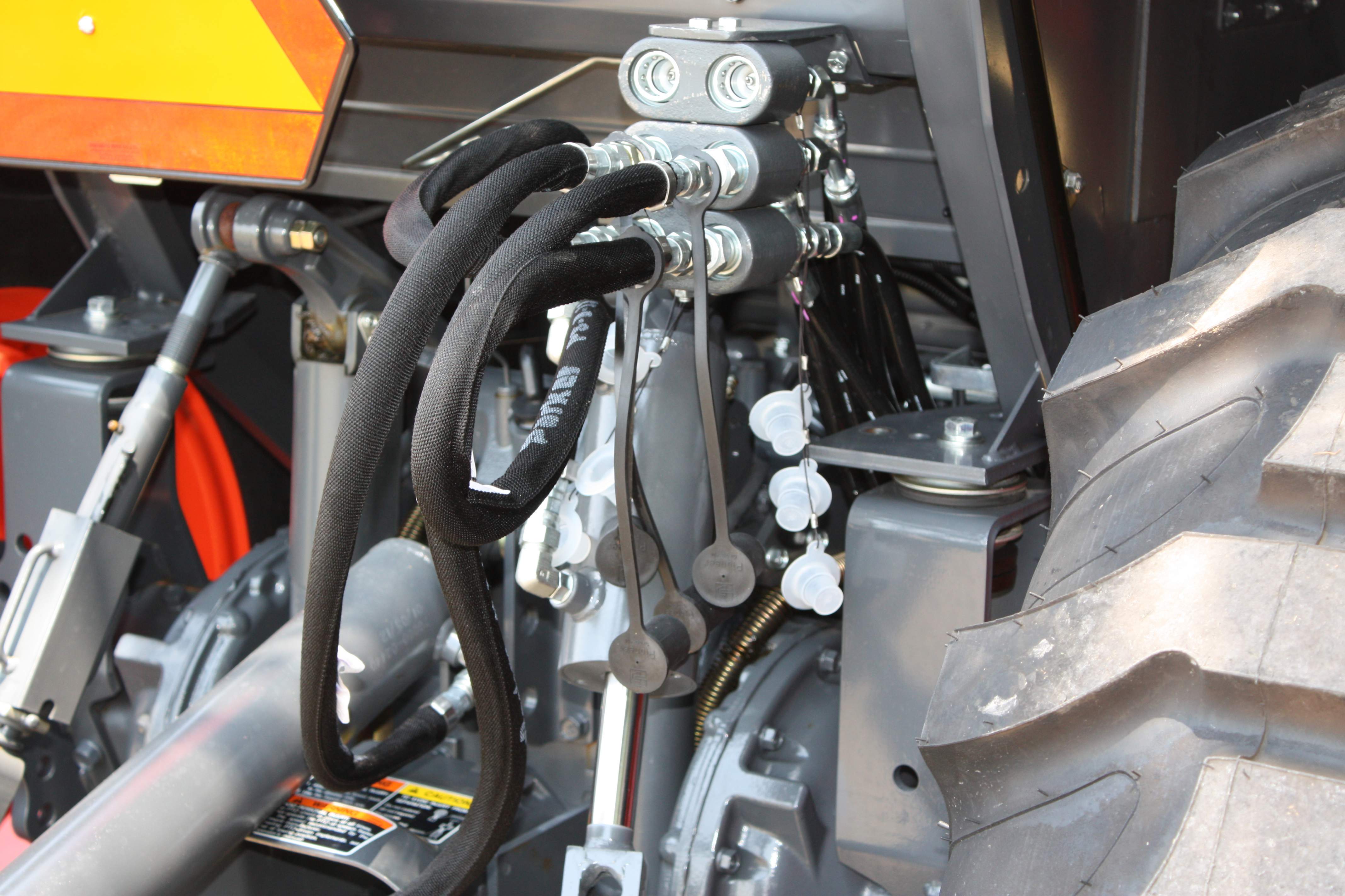

Those look nothing like those on my TnT, but I got mine several years ago. I also bought a top link from Fit Rite and both look pretty much the same. I've had no problems with mine, but anything I buy in the future will be Fit Rite.

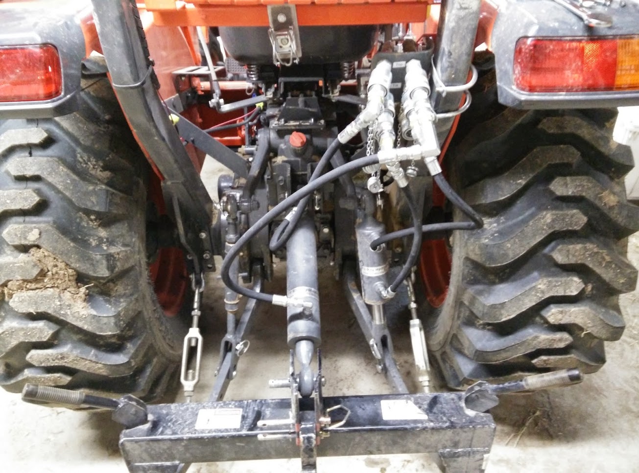

Looked through my old E-mail & I had the choice of 2" or 2.5" cylinders for the L3200 & went with the 2.5". Definitely beefier & better engineered than the excessively long rod on my Kubota cylinders. Did you intentionally match the paint on my L3200 cylinders to Kubota grey, or was that just coincidence?

lol & I'm complaining that mine aren't bulky enough. TripleR, are your's OEM Kubota TnT cylinders? They look beefier than mine more like 2.5" like I had on the L3200.
Other than my not so great hose routing, my L3200 TnT looked great. In retrospect the grey isn't a perfect match to OEM Kubota grey, at least in this photo, but it's close & orders of magnitude better than what I have now.
