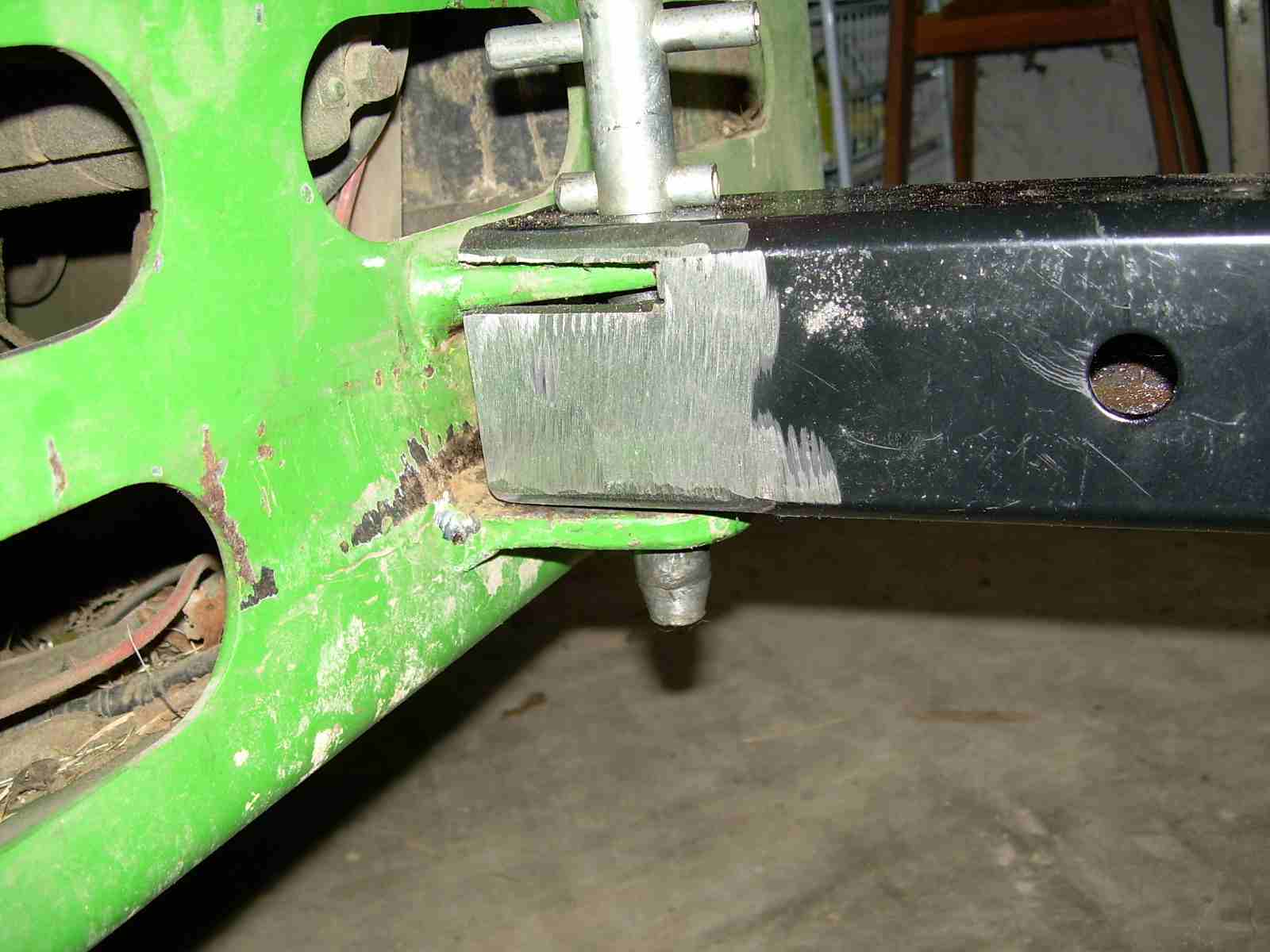

I have wanted to have a 2 inch receiver on my PT 422 for some time. My main reason was to be able to attach a boat winch to it for vehicle recover. I wanted something reasoable strong, but with the capability of being removed and to have little if any changes to my PT. (no welding to the PT, but a few holes would be alright. I have attached a picture on the modified receiver. I have cut a slot on each side so it can slide fully on without being stopped by the existing hitch points. I do not feel this is rigid or strong enough by itself.

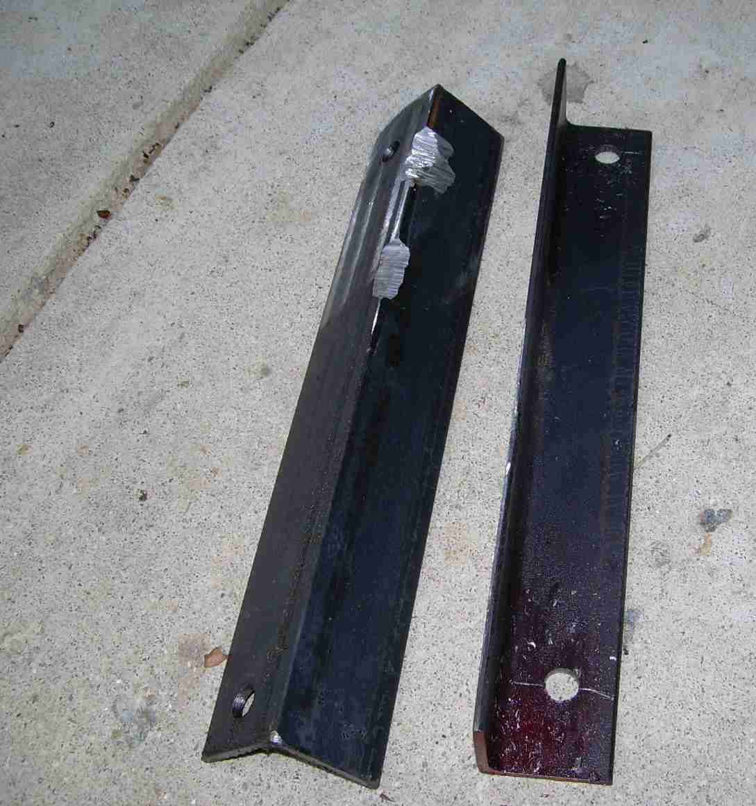

I cut two 1.5 inch angle irons about 10.25 inches long and drilled a couple of holes in each for 3/8 inch bolts which will be attached to the PT. I may add an additonal bolt in the center of the angle irons if needed.
I also ground some metal away so the the PT hitch brackets would not interfere and the angle irons would be flat against the PT.

That isn't going anywhere. If you are not sure, just weld a small section of tube or similar bracing to each side to make a T out of it for side bracing.
