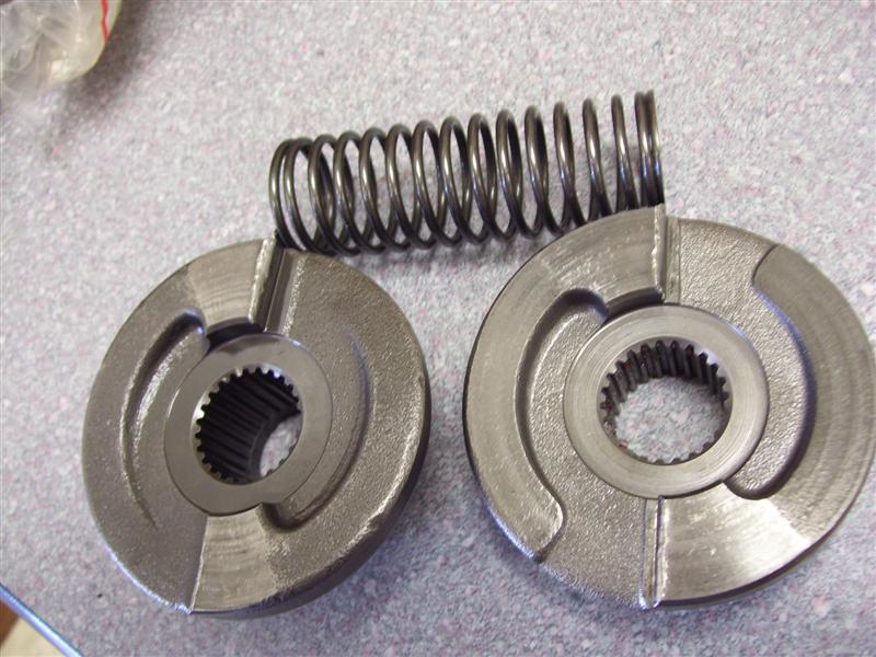

He gave me his therory of why the roto tiller was giving me problems. It is alot harder on the PTO and places much more torque on the system. When the PTO is engaged on the L2800 and L3400 tractors it is done so by two slant cams with two locking lugs that connect that powers up the out put shaft. One of the cams is spring loaded. The springs pressure pushing the one cam into the other is what keeps the two cams engaged. He said the shock from the tiller is causing it to probably increase and decrease the amount of torque causing, not a constant amout of spring torque that will hold the two cams together and that without it that the two cams are overnning their locking lugs. I agreed with him , but ask why would Kubota do this. They have different types of PTO's that do work with a roto tiller why not use it in all there tractors. He said they have used this type of PTO systems in several previous tractors and didn't have a problem. I ask if the previous models had an over running clutch like my L2800 he said no they didn't. All L2800 and L3400 owners have heard the clacking of the overrunning clutch. This noise is made by the two locking cams that are still held together by the spring, but tuning in opposite direction. I ask him about the oil level in the hydro transmission recall and if it had anything to do about PTO problems, he no it was to quiet the clacking noise. I told him that it was probably used for lubrication, as before it was metal to metal when the cams were clacking and now that they were imersed in oil it had to help wear on the cams. He never agreed or disagreed.
I just so happened to have my trusty didgital camera while there and no matter how long it takes me to figgure it out I will get the pictures posted so you all can decide on this PTO system. I thought that the locking lugs would have been cleanly sheared off I was wrong. The damage to the lugs is noticable but not near what I thought it would be. It doesn't take much to put the PTO out of opperating condition and requires the tractor to be split . I think the service manager said the labor guide gave 16 hours of time for the repair. While looking at the close up picture look at the damage where it makes the 90 degree and notice that it's not much, but when I engage the PTO with the condition of these cams all that it would do is clash and not mesh up. I could hold the PTO output shaft on the rear of the tractor and it would stop turning.

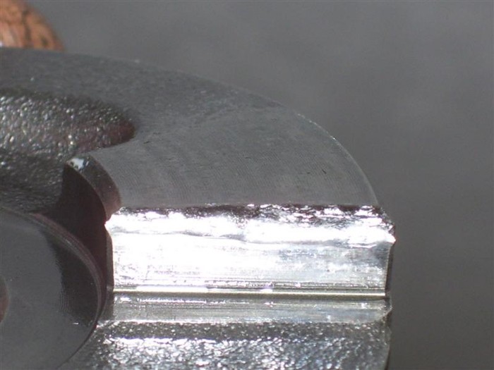

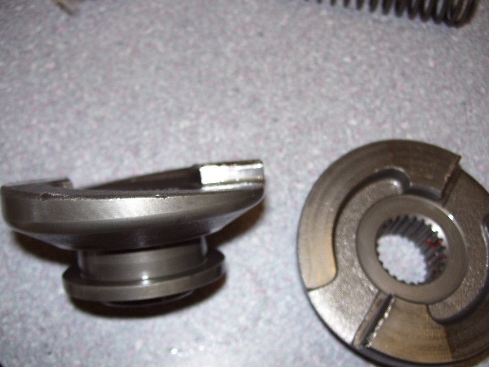

I hope this works, but here are some pictures of the damaged PTO locking cams and pressure spring that came out of my L2800 the second time. These cams are about the diameter of a Coke can. The last picture is a close up of one of the two lugs that when meshed together transfer power to the output shaft that powers your implemnt. Theres not that much damage to it, just enough that the cams will not stay locked and enough to wipe out the use of the PTO.

Thank you sir. I appreciate your post and your information. I was also looking at L3400 and L4400 with more leaning toward L4400 for the fact it has hydraulic independent clutch for the PTO. it does not have a double stage clutch like 3400 or transmission driven with internal overrunning clutch like L2800.
Good luck on your next purchase:)
by the way, I just noticed you posted the pic. Great pics and very informative. I think there may be shock loading involved here. Did you fully clutch befor you engaged the PTO cam? if you did, then may be the spring presure keeps the cams from fully engaging and it jumps the tooth since it does not have much of a gripping edge. At any rate, I would think they would put a more robust coupler of sort, may be with square peg same as a closed coupled pump and motor to remove the slippage chance. Considering the equipment( roto tiller) you use, it most likely has slip clutch or a shear pin. did you have a slip clutch on your tiller? and did you verify it would slip at a shock load? if your tiller clutch did not slip, then the PTO cam experiences sever shock load. That may be the cuase of your problem.

When I engage the Pto on the L2800 I always did it at idle and then released the clutch. After it was engage and the tiller turning, I would then throttle it up to the propper RPMs and start tilling. To disengage it I would just flip the lever with the pto turning at the same RPM's as I was running while tilling and I would then have to push the clutch in before it would disengage. If you decrease the RPMs the overrunning clutch starts making the loud clacking noise until the implement and the PTO RPM's are the same. Most of the time, and I don't think this should be, but I would sometimes have to push the clutch is as many as 5 times before the PTO would disengage. The dealer adjusted and lubed the cable that is used with this type of PTO to engage and disengage the PTO and it helped it, but it started doing it again in a couple weeks. The Rep I talked to today told me that tension has to be released from the implement to the locking cams before the cams will disengage alowing the cams to seperate. I don't think this is good at all. Once I was using it to till the front yard of a lawn install I was puttng in and they had put in a irrigation system and the PVC pipe that is used to hook to the sprinkler heads were only burried about 4" deep. I got into a section of pipe and it was quickly wrapped arround the tillers tines, it pulled close to 40' of the line up out of the ground. I guess I paniced when this happened. I fliped the PTO lever and it stayed engaged ripping the line out. I pushed the clutch in several times trying to get it to disengage, but the only way I could get it to do so was to shut the tractor off and after about an hour of pulling and cutting the line from around the tines on the tiller could I get it to finally to disengage. I was glad it was water line instead of an arm or leg. Having to release the tension of the implement to the cams and shoving the clutch is several time before the PTO will disengage seems should be a safety consern. Alot of damage can be done to what ever is caught in the PTO and that is causing this tension that will not let the PTO to disengage.
AS far as the tiller, It's a series 1500 Land Pride with forward rotating tines and it does have a slip clutch It was used on my old B2910 that had over 3000 hour of running time and probably a 1000 of those hours was using the PTO running the tiller or my 4' bush hog and it never seen any down time with PTO problems and it was used to do the same kind of work of putting in lawns.
If you are going to be using your new tractor with ground engaging PTO driven implements, I would go for the independent PTO system on the L4400. If not you will be just like me and looking for a new tractor when either you get close to 1500 hours on the tractor or your 24 month basic warranty is about up.

I do agree with the Kubota Rep. I didn't realize how the PTO worked when I got the L3400 either. The problem is that the Over running clutch and engagement clutch are one in the same. I think that the tiller causes chatter that hammers the slant cams (Kuboto term) to death.

You are right about the slant camns and the overunnning clutch as being the same. When they turn one way they will mesh together and lock giving the PTO output shaft power. When you suddenly decrease your throttle and the Pto is engaged it turns into an "overrunning " clutch and that when you get the nasty clacking sound. Every time it does this it has to be doing some kind of damage to the cams. I think thats why Kubota came out with the Hydro oil increase level campaign that imersed the cams in oil hoping some lubrication would prevent wear to the cams-clutch and preventing these problems. You can see in the last picture that it really don't take much to put the PTO out of commission. Probably jumping out one time and it rounds the 90 degree angle on the cams and then it's done. The second time mine went out there was no catching and holding for awhile. The first time it didn't hold the PTO was done and the sound it made was exactly the same sound that the overrunning clutch makes, but it is constant and power to the tiller quit. If you can I would never let the overrunning clutch start clacking because its is doing damage to the cams. It may be protecting the transmission as it is advertised to be doing, but it is hurting the PTO. I hate to say this, but In time I think all Kubotas with this system will have problems unless you never use the PTO, or let the overrunning clutch do it's clacking. My problem I was told could be that I use my PTO more the the average person who only uses it to till his garden once every Spring. I didn't think me using the tractor to earn a living would have any bearing on the PTO.
