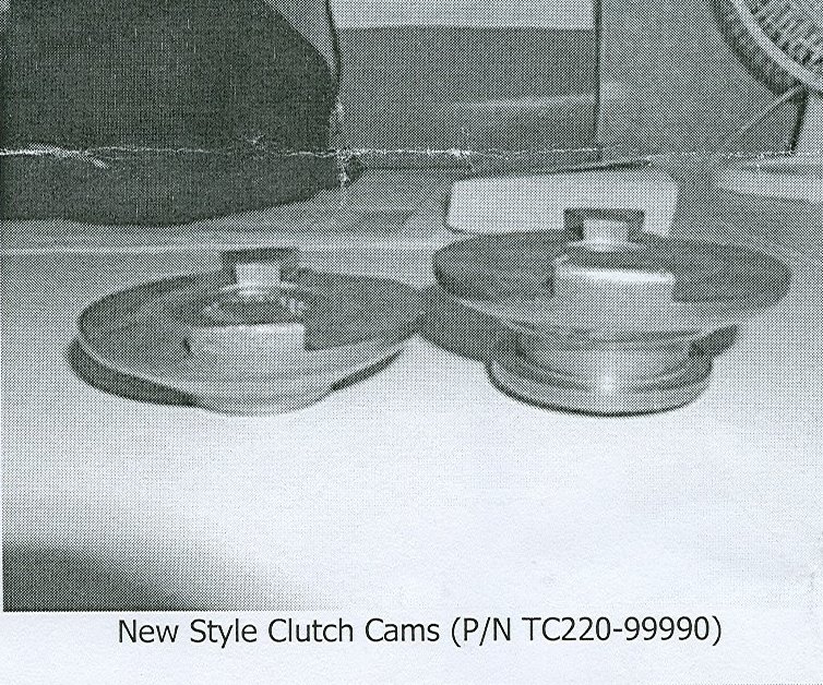

   / L2800-L3400 PTO Making the right choice #294
First, make sure the cable has not stretched or broke. This happened to mine around 350 hours.
If you need to have the PTO cam gear replaced make sure they install the new one.
Rototillers are very hard on this type of PTO. The new cams are supposed to be much better for tillers.

   / L2800-L3400 PTO Making the right choice #295
Tonight, I can look up what serial number the switch from the original cam to the "new" cam was. Even thou you bought your tractor in 2006, it might have been old inventory. Do you know your serial number (at least the first 3 digits).

I'll check the serial number tonight, IIRC, it was above 60K... so you have the original cams (like mine).
