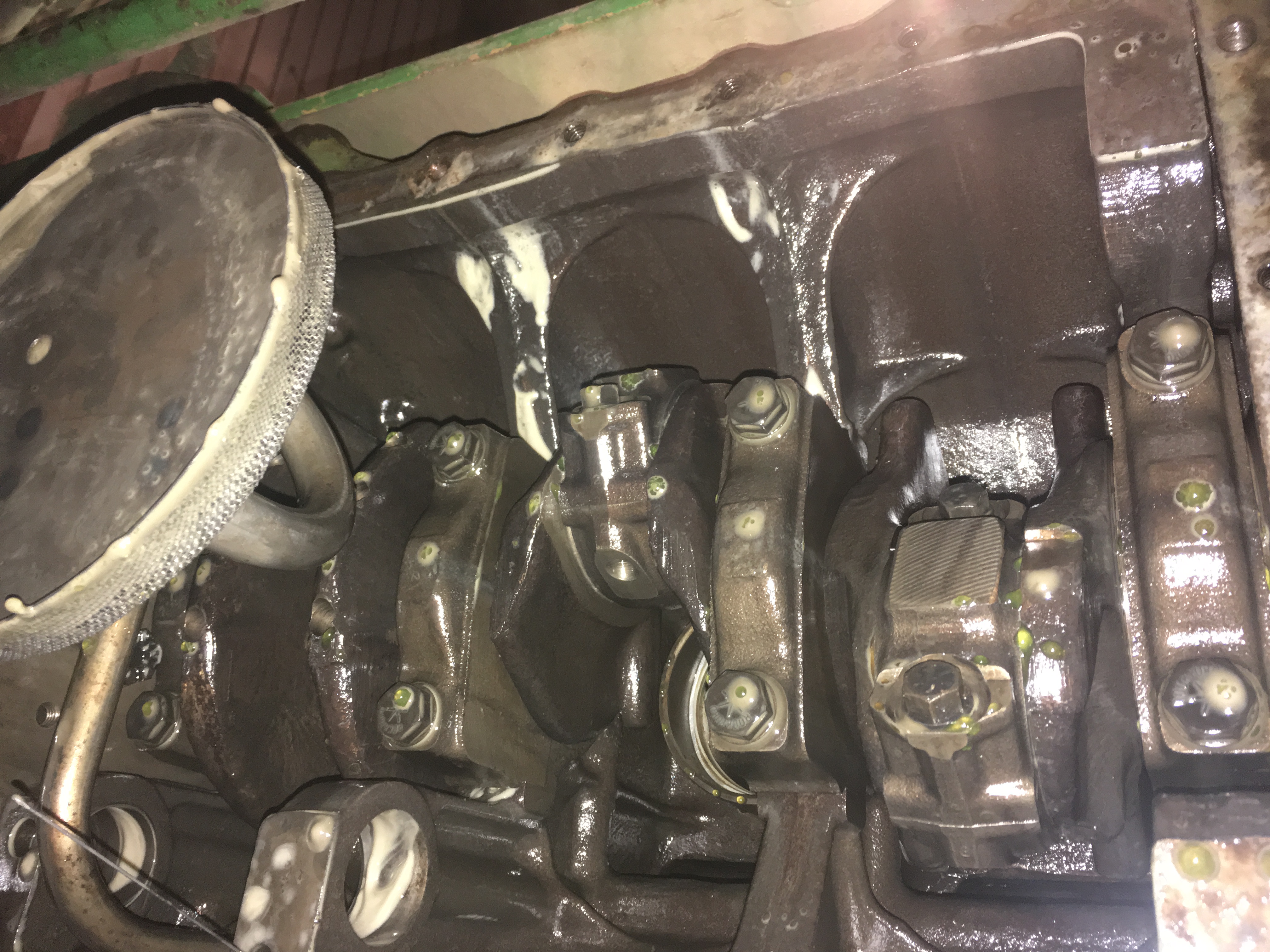

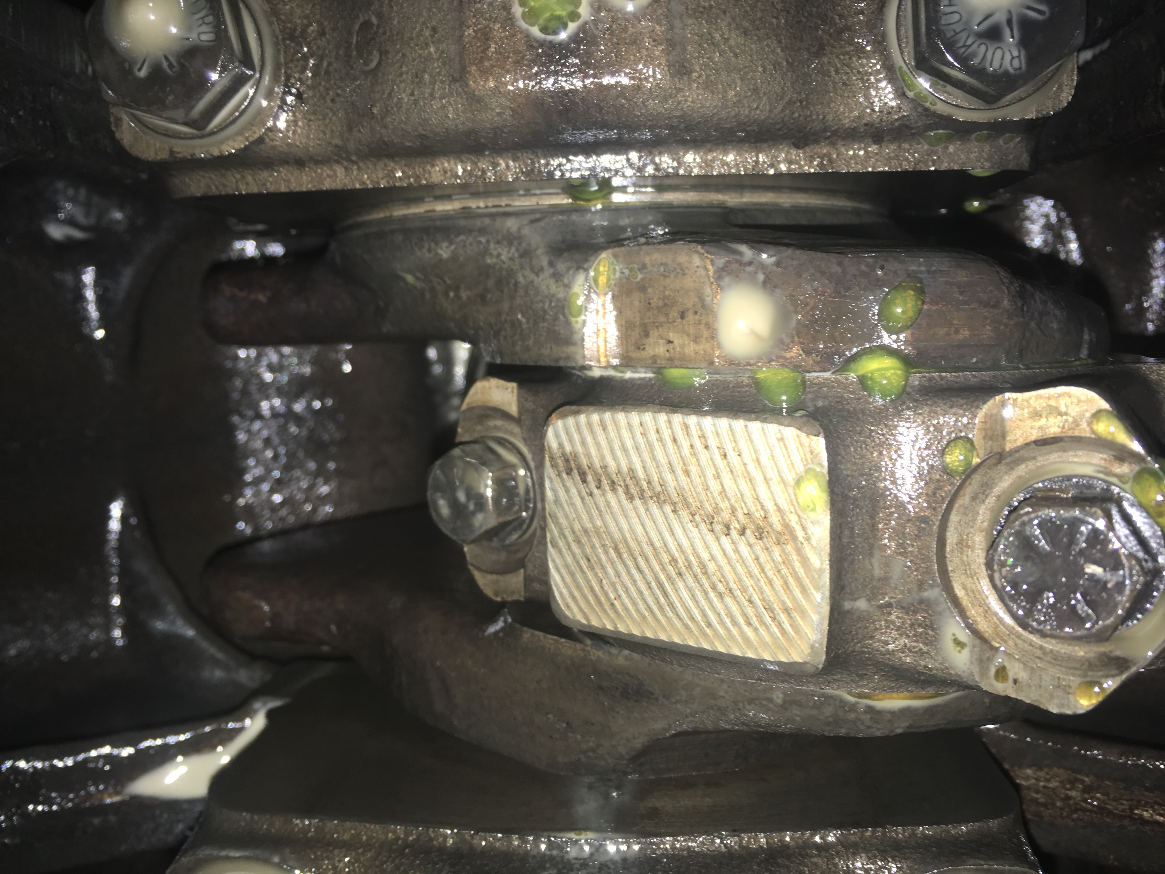

I have all three pistons removed.

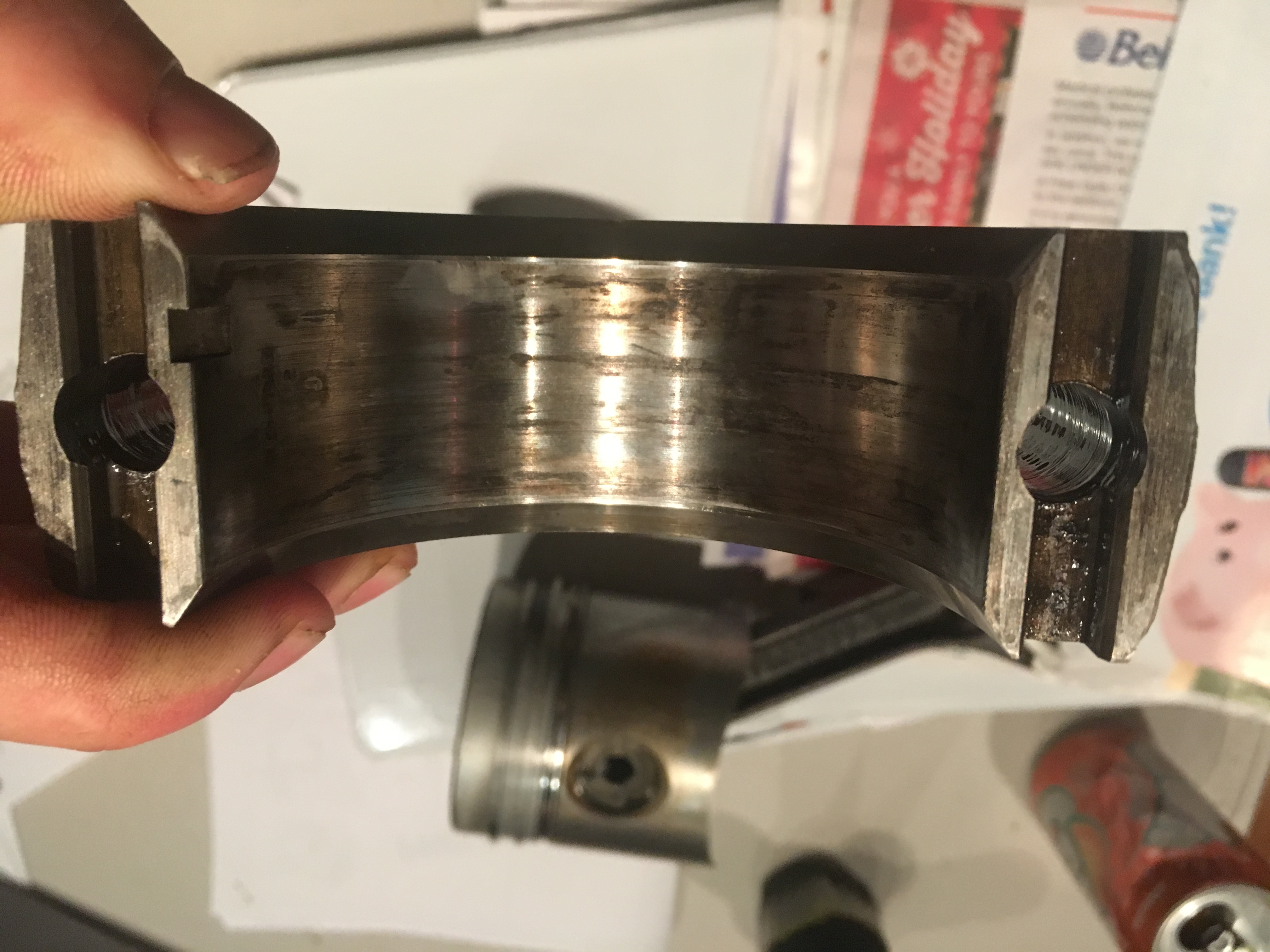

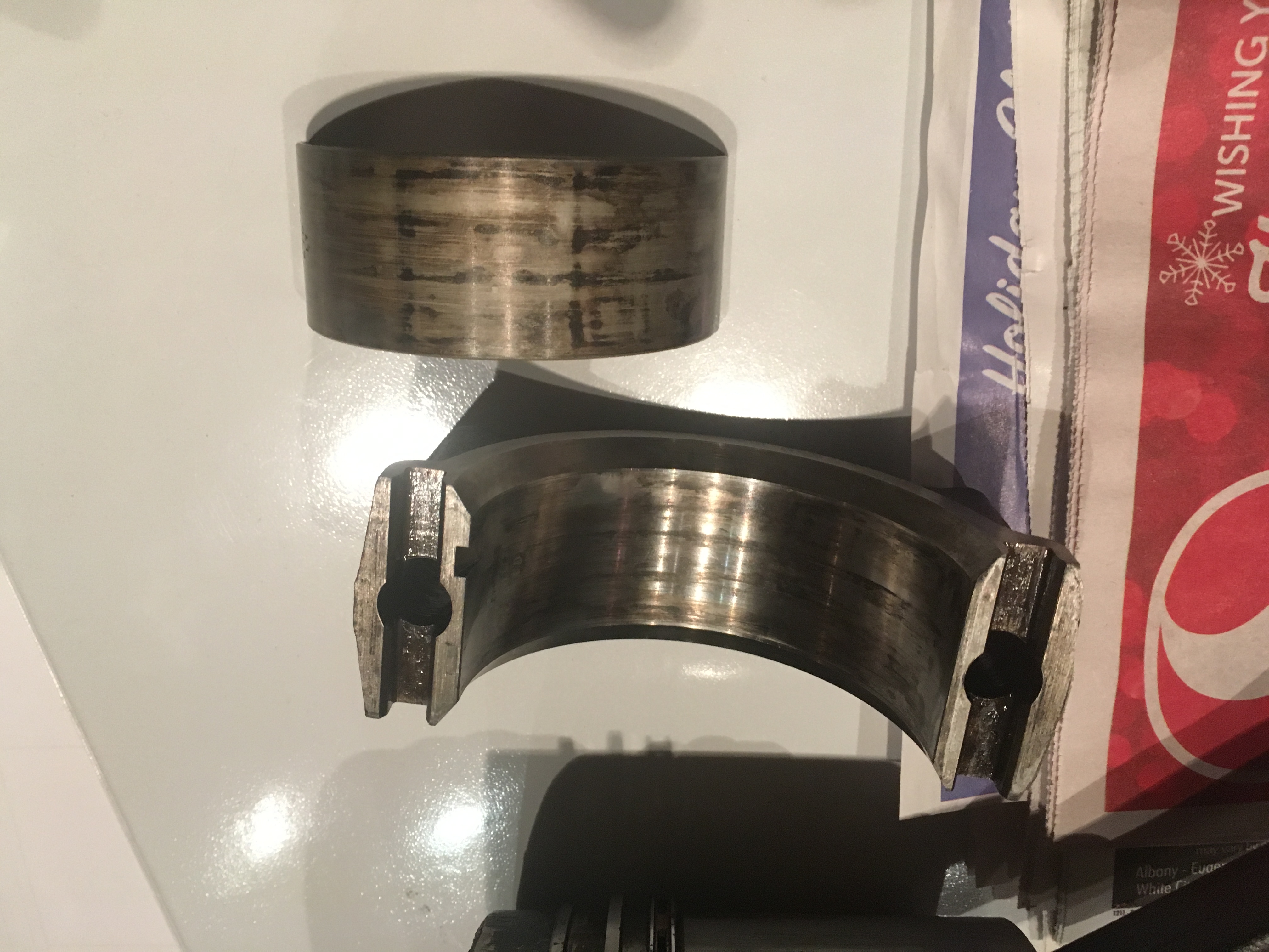

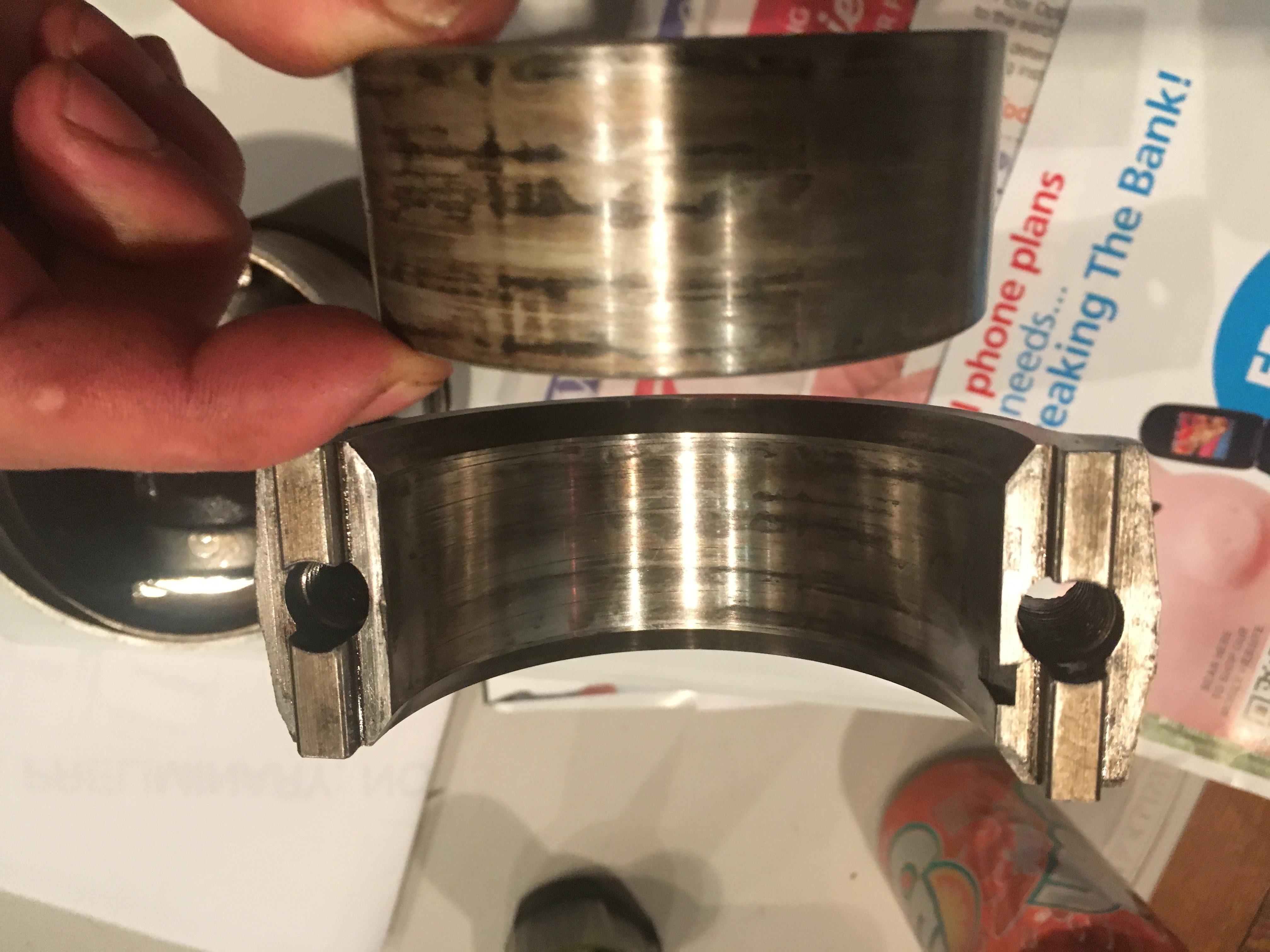

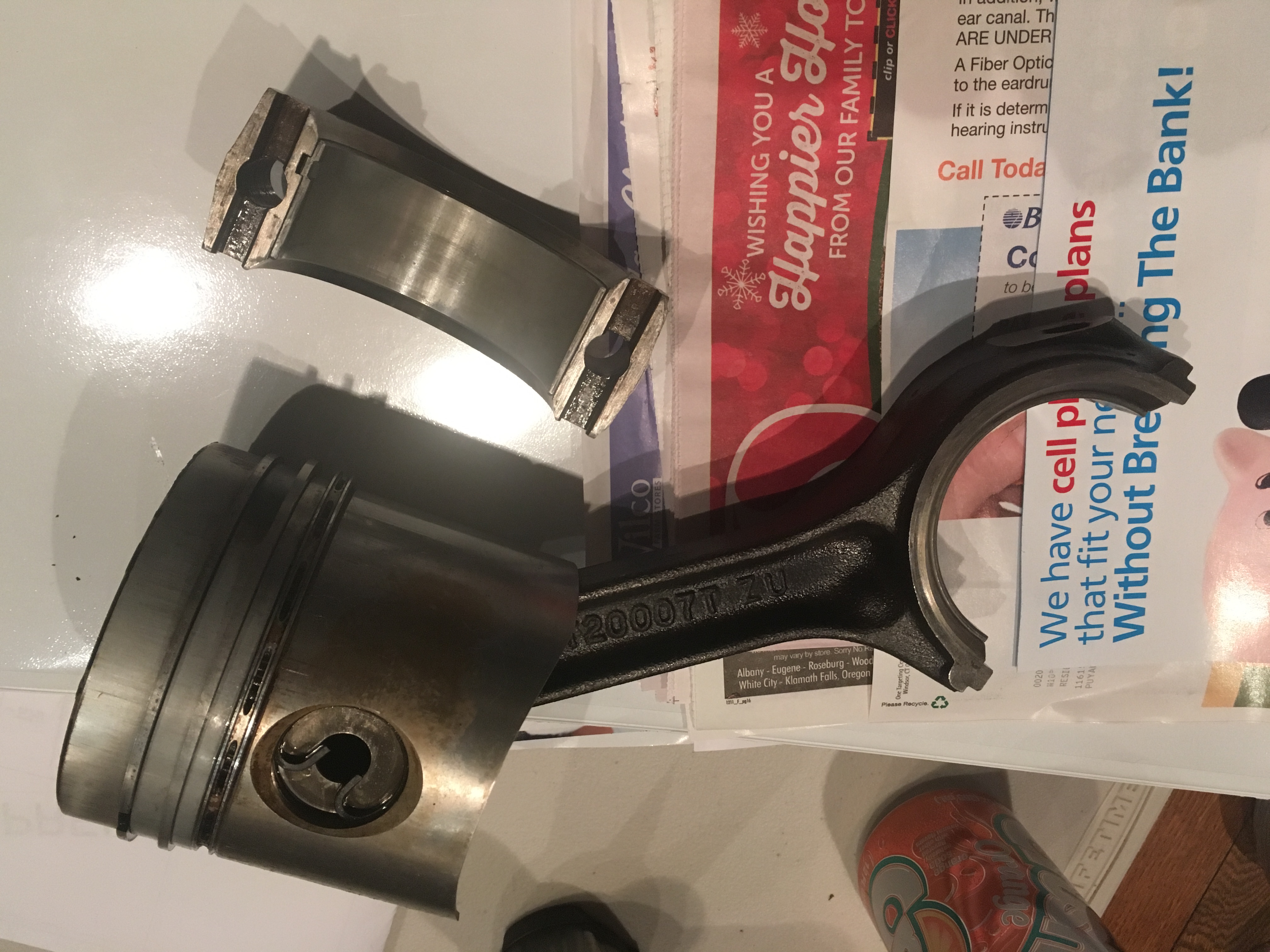

The back side of the bearing halves for each piston are tarnished and brown? But are not warped and fit seamlessly into their respective places.
So am I looking at new rod bearings? The kit that I was looking at from YD Tractors does not include bearings.
The crankshaft doesn't appear to have any scoring what so ever.
I am now looking at three liners that are still in the block. The more I look at them the more I feel I should get them out with a proper puller.
I just don't see a way to get a good bearing surface on the liner from below to enable me to push it up and out with a bottle jack.
So...
Please correct me if I am wrong,
But I would need to remove the old pistons from the rods, install new pistons on old rods, replace rod bearings.
Then remove the old liners, replace with new liners and install my new pistons into new liners. Questions is, how do I compress the new piston rings that will come already in place on the new pistons from YD Tractors to fit them into the liners?

And here are some photos.
IMG_0050.JPGIMG_0051.JPGIMG_0052.JPGIMG_0054.JPGIMG_0055.JPGIMG_0056.JPGIMG_0057.JPGIMG_0058.JPG

The pistons/rings into the liners, go to your local auto parts store and buy a piston ring compressor tool. Should be less than $20. They are simple and work well. If you are in this far I would replace the bearings, no point in skimping on one of the most important parts.

Ok, so replacement of rod bearings will happen.
To extract the old pistons from the old rods, and install the new pistons I will need a press huh? So when I take the head to the machine shop I will also bring the pistons.
It better not "drink" any effing water. :laughing:
Unless there is a crack in the block, it is either the head gasket or the o-rings in the liners that would cause coolant in the crankcase.
Therefore I am replacing both possibly culprits.
