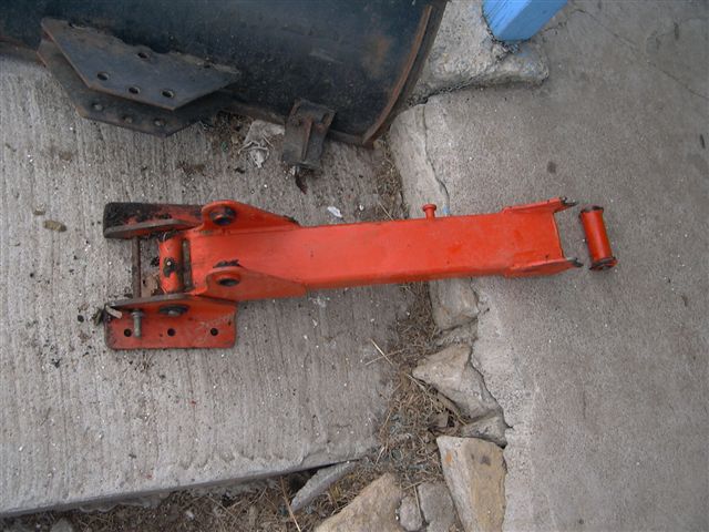

/forums/images/graemlins/frown.gif my backhoe is out of commission again. that last time it broke it was the dipper arm at the pivot. this time it is the left stablizer arm. broken at the pivot. the metal is too darn thin. 1/4 inch. it needs to be THICKER.
We havn't used it much since the last time it broke. We don't raise the back end of the tractor much either. The TRACTOR is great but I'm a bit leary about the backhoe at this time. thankfully it is still under warrenty.
I sent the pics to my dealer last night. will hopefully hear about it in a few days.
I spent to MUCH money on the backhoe to have it break all the TIME.

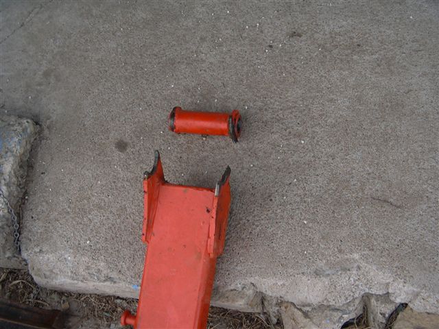

here is a close up view of it. I wish kioti would do something to make it stronger.

How old and how many hours.
   / 2375 backhoe broken again. #4
Looks like the one side the weld let loose then broke the metal on the other side
I bought the tractor and hoe the first part of june of 2005. the First New tractor I've every had. tractor has 275 hours. maybe about 70 hours on the backhoe. and that may be pushing it. it gets fed grease every 10 hours religously.
kioti just needs to make the 1/4 inch thick metal a THICKER metal at least 3/8 inch thick.
from readying some past posts, It sounds like there is another guy or 2 that has had a few problems also.
I know it will get fix but it is just a bit upsetting. mark

I agree, the metal seems a bit thin. I talked to my dealer after the second break and will wait till I am out of warrenty and have some extra weilds and metal plates put on in the areas that need beefing up. After my first break, I notice Kioti did exactly that with the new backhoe they sent.
