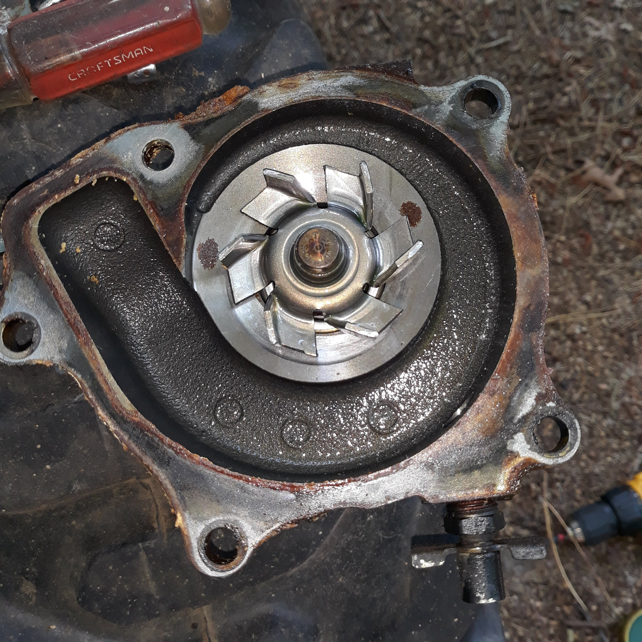

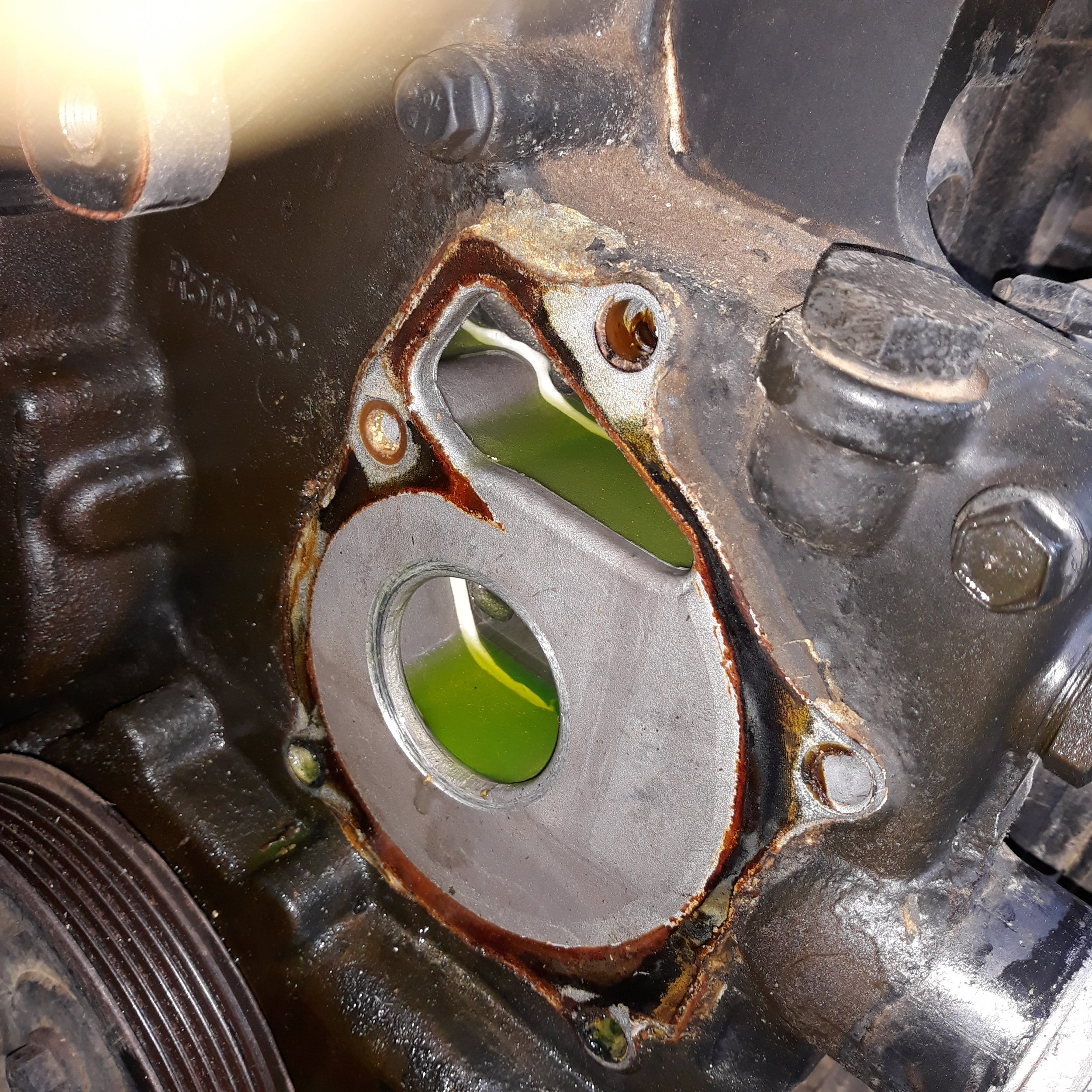

I have a 05 4320 and i think i caught mine just in time.

How many hours on your tractor? For everybody's information this forward end cover is made of aluminum. It also houses the engine oil pump. Another thing is that Deere did make a high volume water pump for the 2.44 engine. Not sure if they still do. The impeller dia. was larger on the high volume water pump.
   / 4320 water pukmp failure #18
One other thing is that the scoring is on the input side of the of the water pump. Early forward end covers like your's were as cast with a slight crown in that area. Later editions were machined in that area.
   / 4320 water pukmp failure #19
My 4320 has 1450 hours. It started making noise last week and i was not sure what it was.
