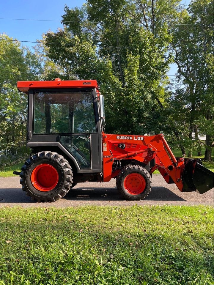

youre right !!I never thought of that I have cat2 ,Buch hog is 5ft which is ok for a 35 but the blower is 8ft, 2 furrow plow the main thing is the snowblower. either sell it or .like you say. look for a little bigger HP. I just missed a 1085 with FEL cab heat MFWD. Theres a Ford 5610 also but I heard the cyl become porus after a while so Im staying away from fords now.Unless you intend to replace your snow blower and rotary cutter with lighter, narrower models you will need at least 55-horsepower at the PTO to replicate the performance of your open station MF 255 in a cabbed tractor with air conditioning.
A cab weighs 700 pounds. Cab A/C requires 4-5 horsepower to power in hot weather. You may wish to consider 55 to 60 PTO horsepower.
Are your existing implements Category 1 or Category 2 at the Three Point Hitch?
It was used as a stable tractor by a horse lady, so either its been meticulously maintained or not maintained at all. used for snow clearing around the barns and riding stable , 3000 k hrs since new in 1998.3000 hours should not be a big deal, what matters is how was it used and serviced!
IE. Has it been it abused & worn out or is it well maintained and not abused?
Go look at it and look it over good and see how it runs. I wouldn't worry about the 3000 hrs. Looks like a nice taken care tractor from the picture.It was used as a stable tractor by a horse lady, so either its been meticulously maintained or not maintained at all. used for snow clearing around the barns and riding stable , 3000 k hrs since new in 1998.
I have cat2. Bush hog is 5ft which is ok for 35-horsepower but the blower is 8ft. The main thing is the snowblower. Either I sell it or look for a little more HP.
Yeah you’re probably right and it’s the catching up with all the implements too, they ain’t cheap. Thanks for the logical advice.How far do you need to throw snow? A 35-horsepower, pre-Tier 4 tractor will have approximately 24-horsepower at the PTO, only 1/2 of the 50-PTO horsepower of your MF255.
A 35-horsepower tractor weighs only 1/2 of the weight of your MF255. Traction on snow will be less.
I think you will be underwhelmed with a 1/2 power, 1/2 weight replacement tractor.
I would also add that today’s small compacts with 3,000 hours on them could be well worn.Im shopping around for a replacement for my good old MF255 (open station). Im getting to be over the hill and Id like some comfort when snowblowing or bush cutting.
anyways to make a long story longer Ive been looking online for a good used tractor, researching different models obsessing like anyone does.
Ive been looking at some smaller 35 HP kubotas but when I research the models everyone is saying 3000 hrs is wayy too much and the tractor is worn out. My old 255 has 7000hrs and still runs strong starts well, shes a gool ole girl but no 4x4,no cab etc etc.
would I be smart and look for an older pre-electronic tractor or are these newer machines with plastic hoods good for more than 3K hours?
If I should go older which years would be good to look at?
thanks everyone
PS I can fix basic stuff myself but i couldnt rebuild an engine etc etc
