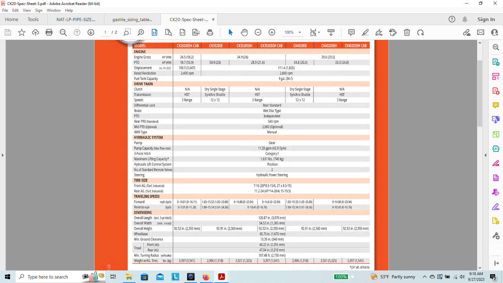

The Kioti "20" series is interesting when you start comparing the specifications,
especially looking at the HP and weights of the 25 hp, the 35 hp and 40 hp.
