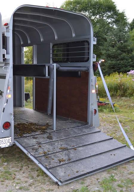

We have a two horse Valley trailer. steel. Nothing fancy and it came with a steel ramp. It has springs to make lifting the ramp easier. However, my wife can't lift it, and I find it difficult to do so. So I installed a winch to lift the ramp. The nylon strap is out of the way when I use it, and my horses are quiet and unlikely to get tangled. (If you do make a ramp, don't use a pick-up bedliner spray to coat it - much too slippery. Horses go down on it.
This trailer has the spray liner- since replaced with Hawk Trailers flooring - much better and secure.) DSC_0014.JPG
New flooring - slippery ramps are not good. This is the ramp using the Hawks Trailer matting (ordered from their website). 3/4" plywood on top of the steel, with the matting screwed down on that.Kalli a at Robins 8 5 2015.jpg

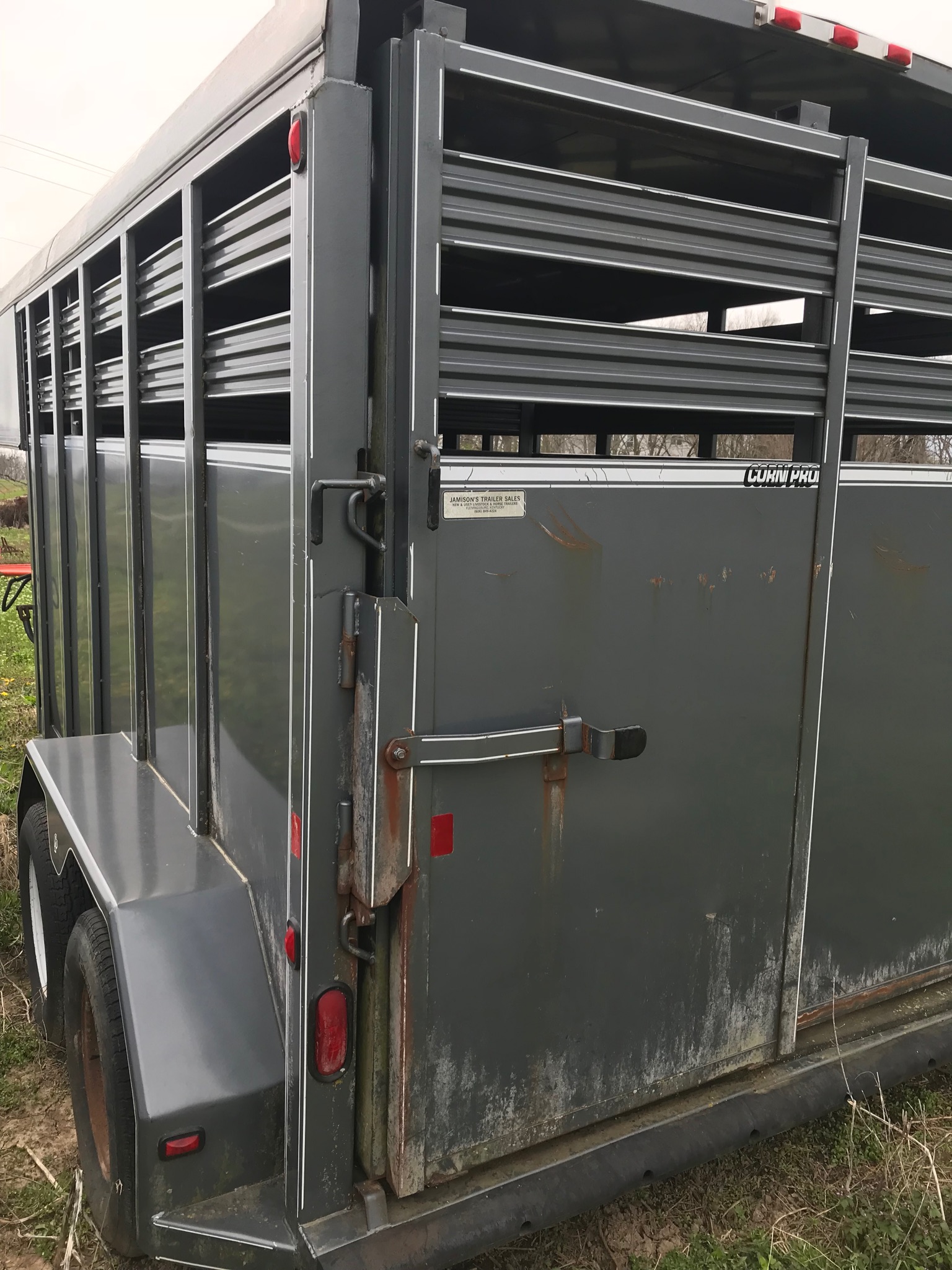

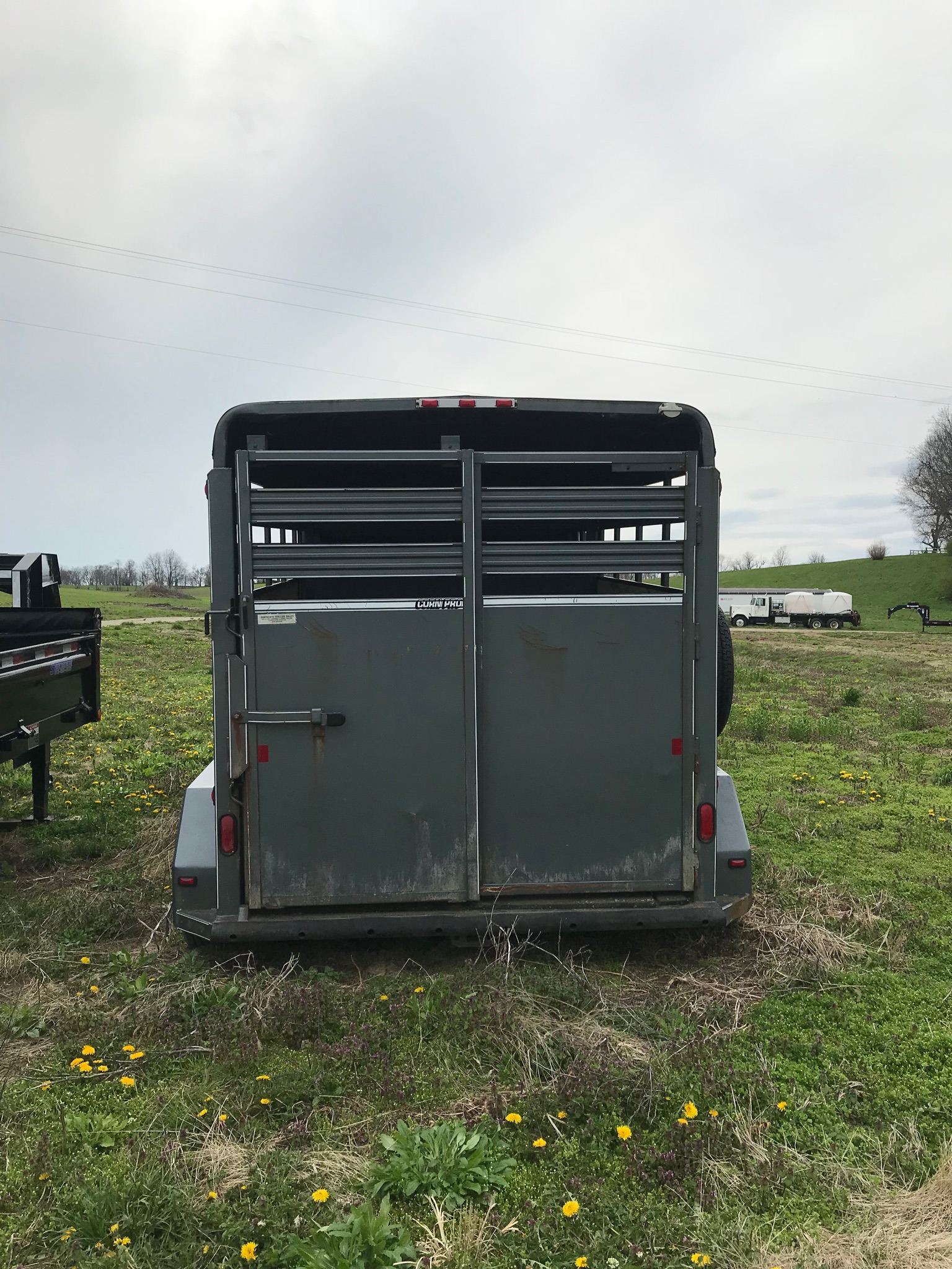

Post pictures of the back of your trailer. specifically the rear bumper area and the current door set up

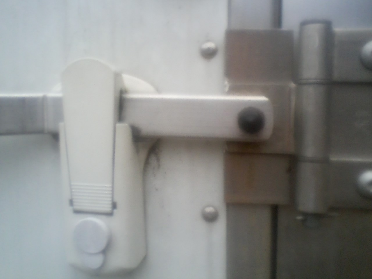

This is the back end. The left 1/2 of the door slides to the right. Also, the entire gate swings out, unlatching at the left and swinging the entire back gate, on a right hinge.

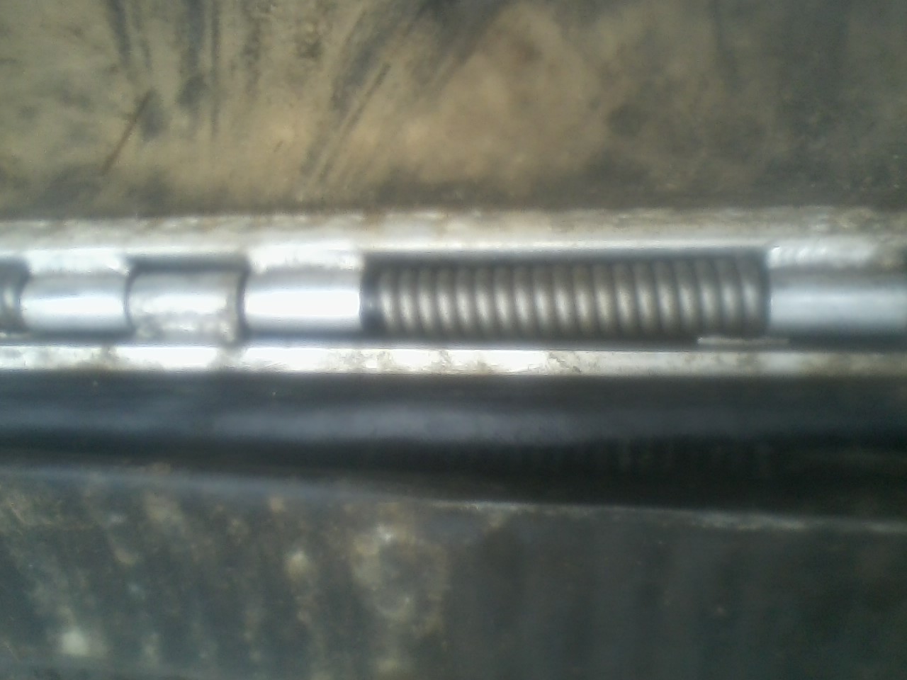

Here's some pictures of my trailer ramp the pin and springs run the width of the ramp 0406181215-00.jpg0406181217-01.jpg

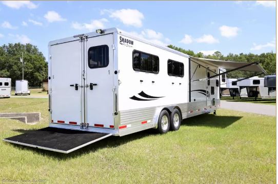

This is an interesting approach to adding a rear ramp - It is an accessory for this company. Looks like it is aluminum - 1200. - But doing the same thing in steel and welding it in place, while leaving the doors that you have may be an idea to consider. Also you might get away with a shorter ramp.
Rear Add-on Ramps
