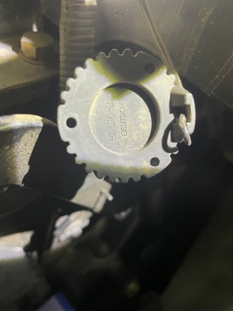

The two photos below are from my 2016 NH Workmaster 33 (same as LS XG3032). BTW I bought OBD2 converter cable "CAT Industrial Female to OBD2 Female Adapter (catobd2)" and it DOES NOT FIT.

Here's the one I bought that does plug into the port. See this thread too. The plug is unkeyed.
   / Diagnostic port and diagnosis #10
The cable in your post is the "catobd2" which is what I purchased for my 2016 HW Workmaster 33 (same as LS XG3032). From the pin picture I posted above, the pins on a catobd2 adaptor are different than the 4 pins shown in my picture. Also, the catobd2 adaptor did not fit on my odb port.
