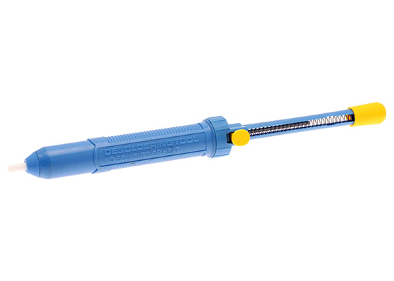

Speaking of Dinosaurs, I started my Electronic Technician career working on first generation computers in 1962.
Most people nowadays don't know what a vacuum tube is. :(
Everything was fixed at the component level. I still have my solder sucker, similar to this one: :thumbsup:
