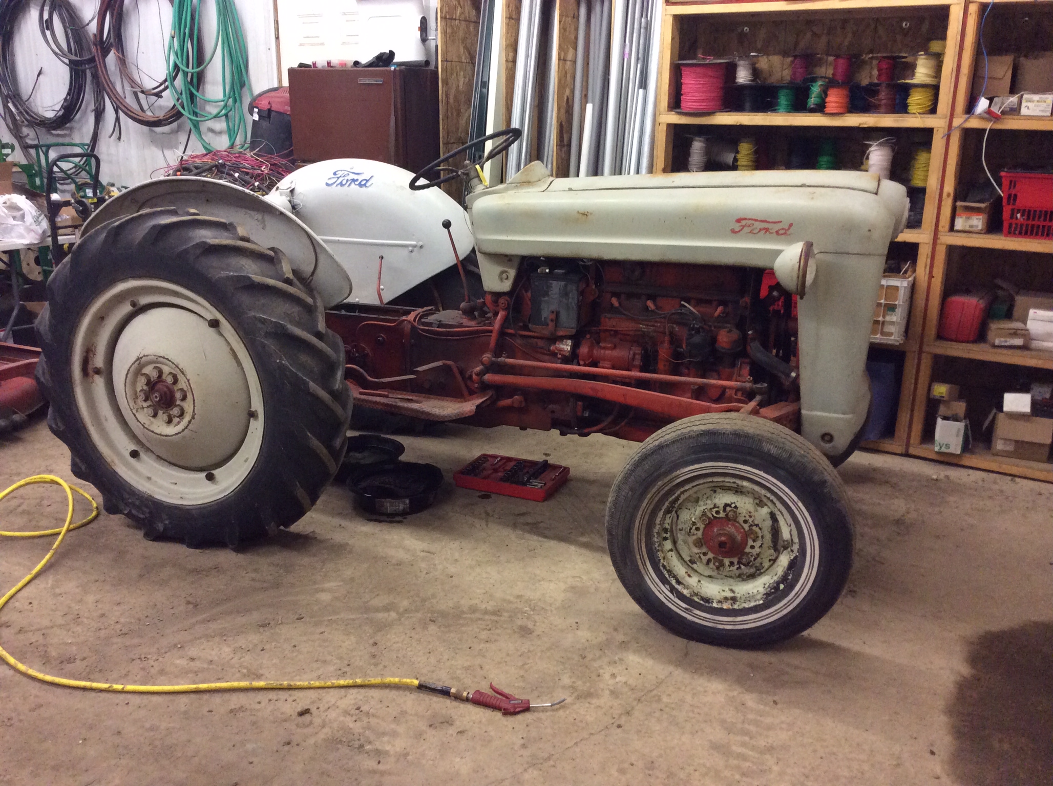

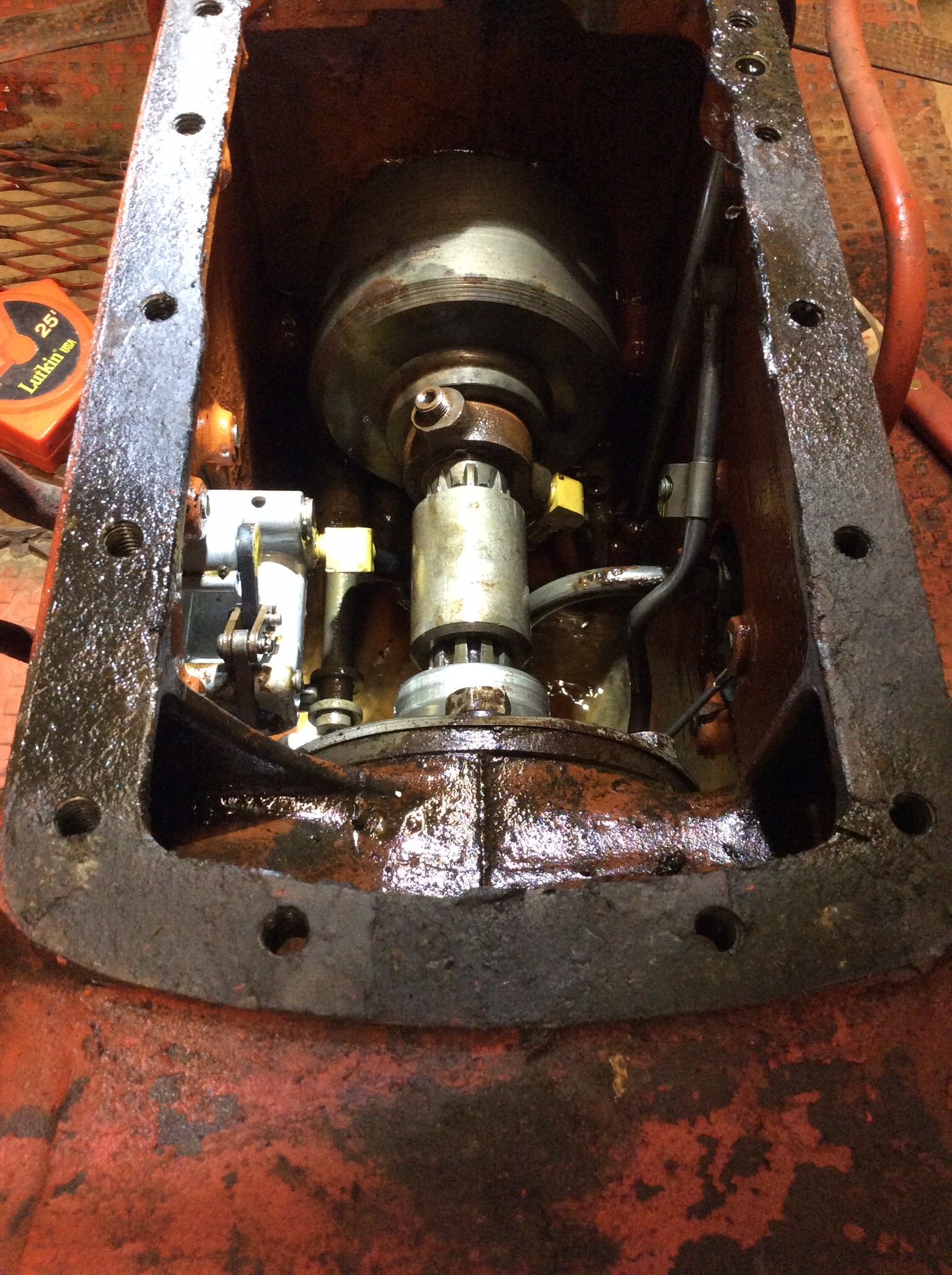

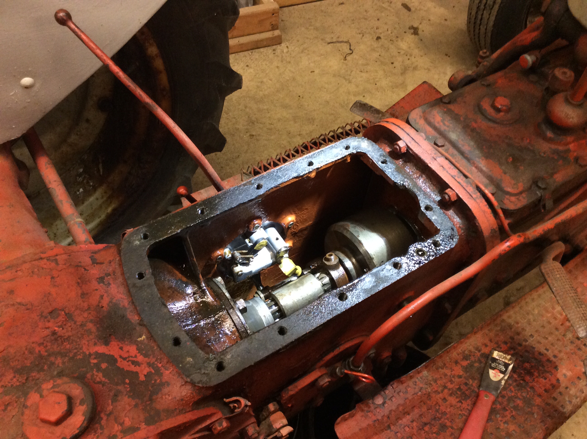

Hey guys. I just bought what I think is a Jubilee with live PTO. The tractor runs well but the three point does not work at all. While looking for more info on how to service the hydraulics I started noticing some extra parts on mine compared to the others I was seeing online. Here are some pics.
Here you can see the second and much smaller hydro pump.

The extra lever by the PTO engagement lever.
The hydro valve that is controlled by the lever.
I think this collar on the driveshaft must have oil passages in it that ultimately control the PTO or rear axle? The hydro hose goes down from the valve via a 90 degree fitting, under the shaft and up and into a 90 degree fitting on the collar.

On another note, I need some help diagnosing the hydraulics. The hydraulic pump is working and is primed but I have not done a pressure test. The hydraulic valve and piston work when I apply air pressure to the the oil inlet. Since these two major parts of the system work I am thinking it is the pressure relief valve or something along those lines. Any help would be appreciated. Thanks!

My understanding of what a live PTO is that you can depress the clutch and the PTO doesn't stop. I thought I knew this, am I wrong? Often times the TPH not working on a Jubilee is from a bypass valve sticking or I think a seal blown. I have not worked on a Jubilee for 35 years so my memory is a bit foggy. Ed

the live pto on a jube is mor elike a 2nd stage clutch.
you have a main foot clutch.. then there is the add in pinion clutch. on the jube, the pinion clutch is hydraulic. on an 8n, it is mechanical.
throwing the lever clutches the drivetrain at the pinion, but not the pto, because you have not stepped on the clutch. thus think of this as a separated 2 stage clutch.
need to check that lift cover .. unloader valves stick.. sometimes you get backpressure valve problems. did you remove he acorn nut and back the back pressure valve off before disassembly?
