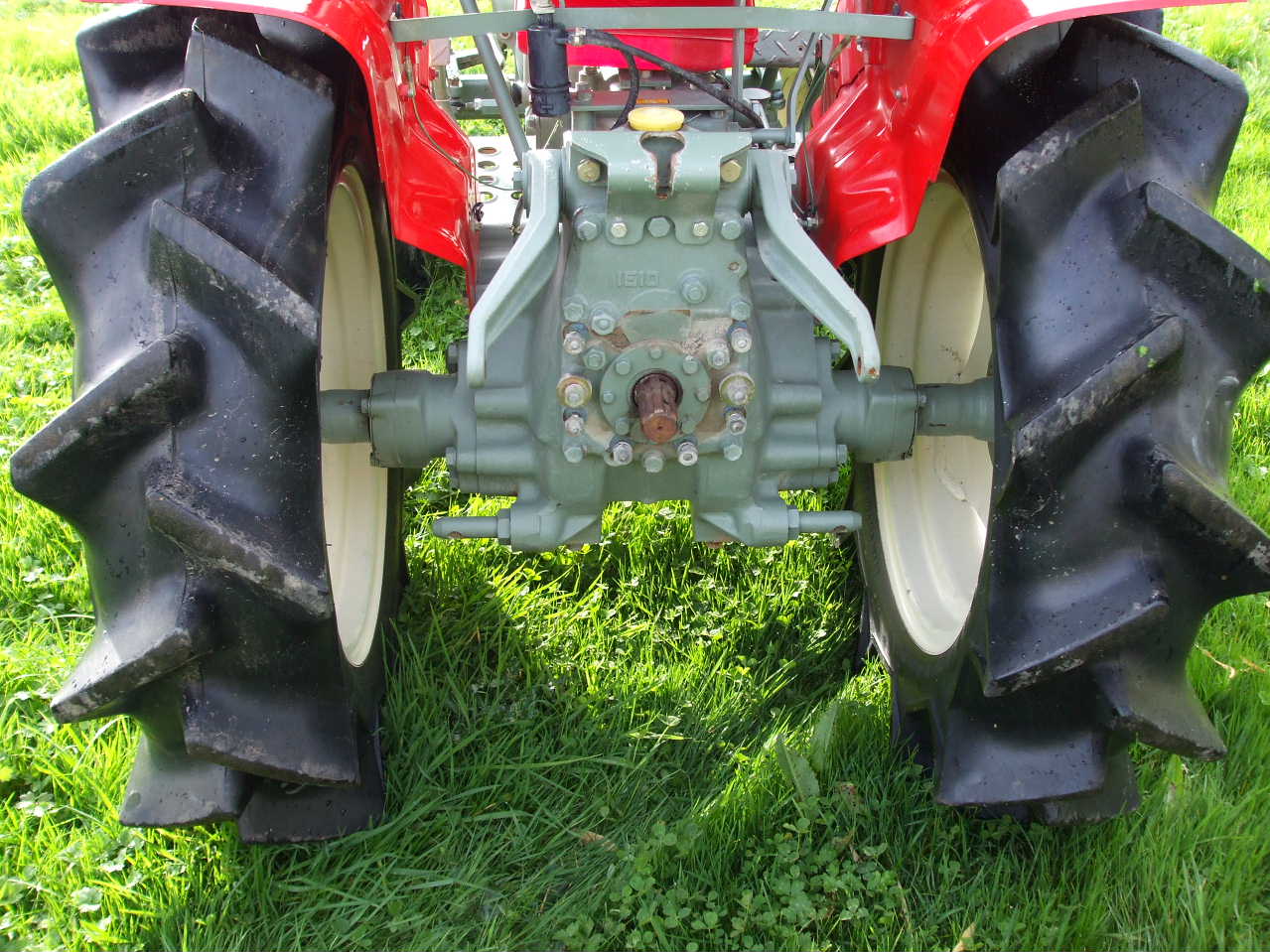

I'm 99% sure the tiller intended for YM1510 fits perfectly on YM186.
YM186 is a little beefier. The pins that hold the 3-point arms are part of a bolted-on assembly - see my photo below. I've seen pictures of YM1510 that show the hinge pins for its 3-point arms are screwed directly into the sides of the transmission.
The upper link bracket is bolted to both the back and to the top of the transmission housing. I don't know if YM1510 uses this same bracket.
Both tractors are built to the universal Cat 1 standard so the 1510's tiller should fit your YM186 fine.
You might sketch your top bracket, with measurements, and take that along to be sure the dealer's top link matches to it. I can't think of anything else that might be a problem.
Photo: YM186D 3-point details. Can someone with a YM1510 describe any difference they see?
Here is a picture of the back of a 1510.
