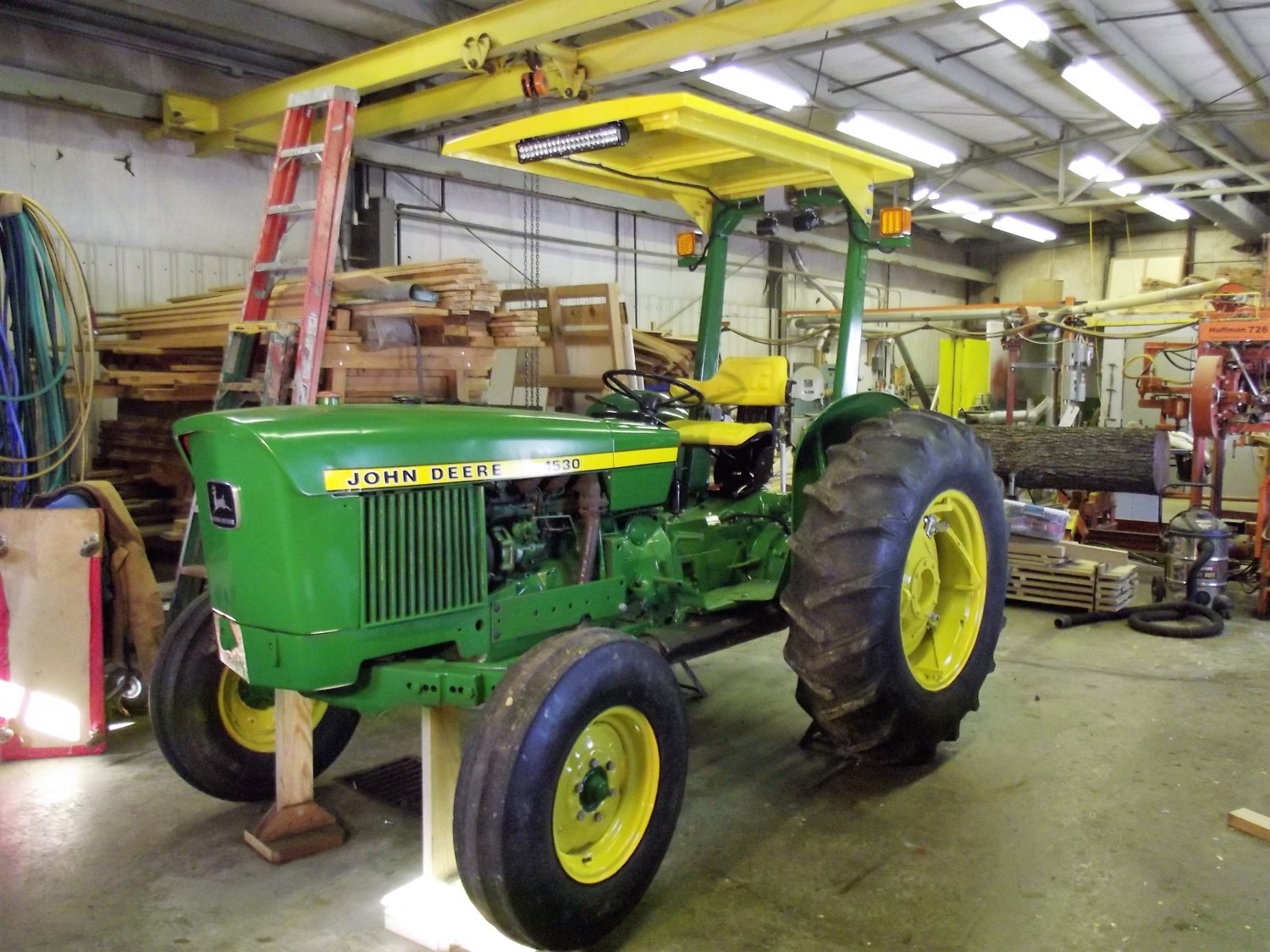

Thanks for the reply. The shift is manual. I can engage reverse gear (sometimes with difficulty) and operate the tractor, but it will not stay in gear. Holding the lever back manually will keep it engaged.

I bought this tractor from a dealer in 1975. It was used in light farm work, then completely restored in 2016 including engine rebuild. Total hours are less than 2500. I have never had any transmission issues until a few weeks ago. The tractor is used now as a loader tractor, very light work, never kept outside. Yes, I do as much mechanical work that I am capable of or understand. Thanks for your reply.

Thanks, she's a beauty.
May be it is something simple, but I'd think worth a look-see into the top of the tranny for anything obvious. Then try to assess any wear that can be fixed without opening up the tranny.
For only the cost of the cover gasket, you can check out how the forks slide the gears around. May be it is just something not sliding and only needs some penetrating oil or brake cleaner to loosen it up. Or some condensation has caused some rust that inhibits sliding forks. Hope for something simple.
