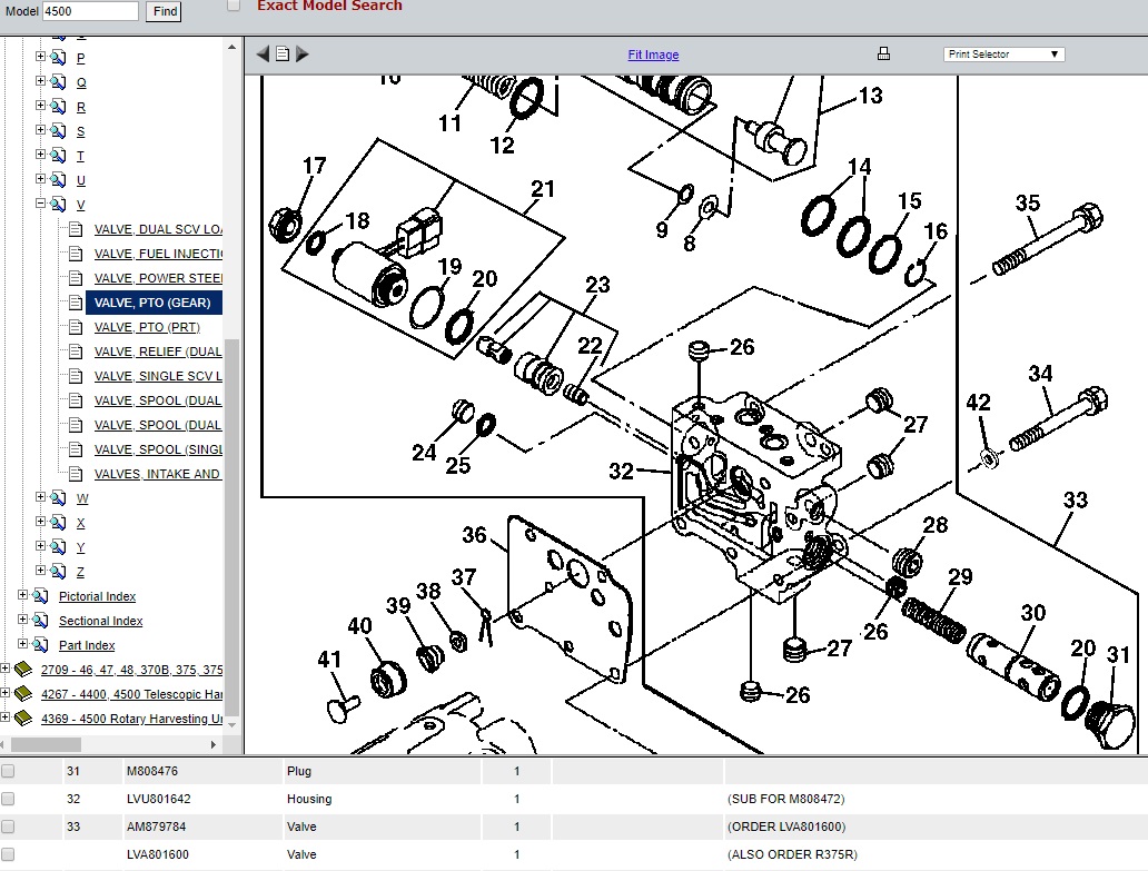

Sep 4, 2018 / John Deere 4600 pto not engaging #22 B beenthere Super Star Member Joined Aug 16, 2001 Messages 18,093 Location Southern Wisconsin, USA Tractor JD_4x2_Gator, JD_4300, JD_425, JD_455 AWS, added JD_455, JD_110, JD_X485(sold) Joe That # appears to be the housing.. item key #32 in the schematic.. also shows some of the parts associated. From jdparts John Deere - Parts Catalog Attachments 4500_PTO_valve.jpg 263.5 KB · Views: 158
Sep 4, 2018 / John Deere 4600 pto not engaging #23 J Joe12 New member Joined Sep 3, 2018 Messages 3 Location Alabama Tractor 4500 beenthere, Thanks I will look at this and see if I can take it apart.
