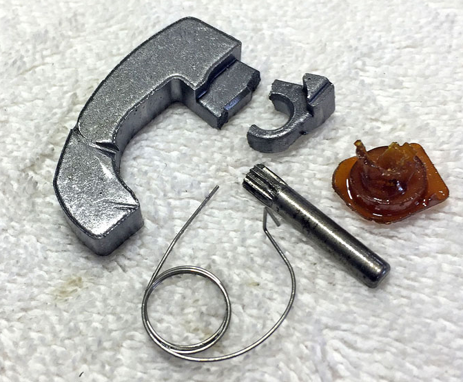

Should I be heading at the camshaft now at 570 hrs as a preventative? What fails on the camshaft on these, I saw something about plastic... they could not have a plastic camshaft?
   / John Deere LA125 Lawn tractor 21HP B&S single crankshaft Oil Seal needed. #7
The compression release arm breaks off. They are all metal, but hopefully yours is good for the duration. Just a poor attempt of a gentle ribbing. Sometimes the best the best laid plans don't go as they should!
There is nothing preventative you can do. The automatic compression release mechanism on the camshaft has a bad habit of breaking on the B&S 31000-series engines. I have an Ariens with the same engine and I've replaced the camshaft three times in 7 years. B&S knows about the problem but refuses to do anything. As you can see below, the ACR components look like something that belongs in a pocket watch, not an engine.
   / John Deere LA125 Lawn tractor 21HP B&S single crankshaft Oil Seal needed. #10
The 21xxxx.28xxxx,31xxxx,33xxxx all use the same camshaft part number so not limited to just your engine. But the main reason Briggs doesn't fix it is because it isn't as widespread as people think. Even if 100K fail every year compared to over 10M engines.
