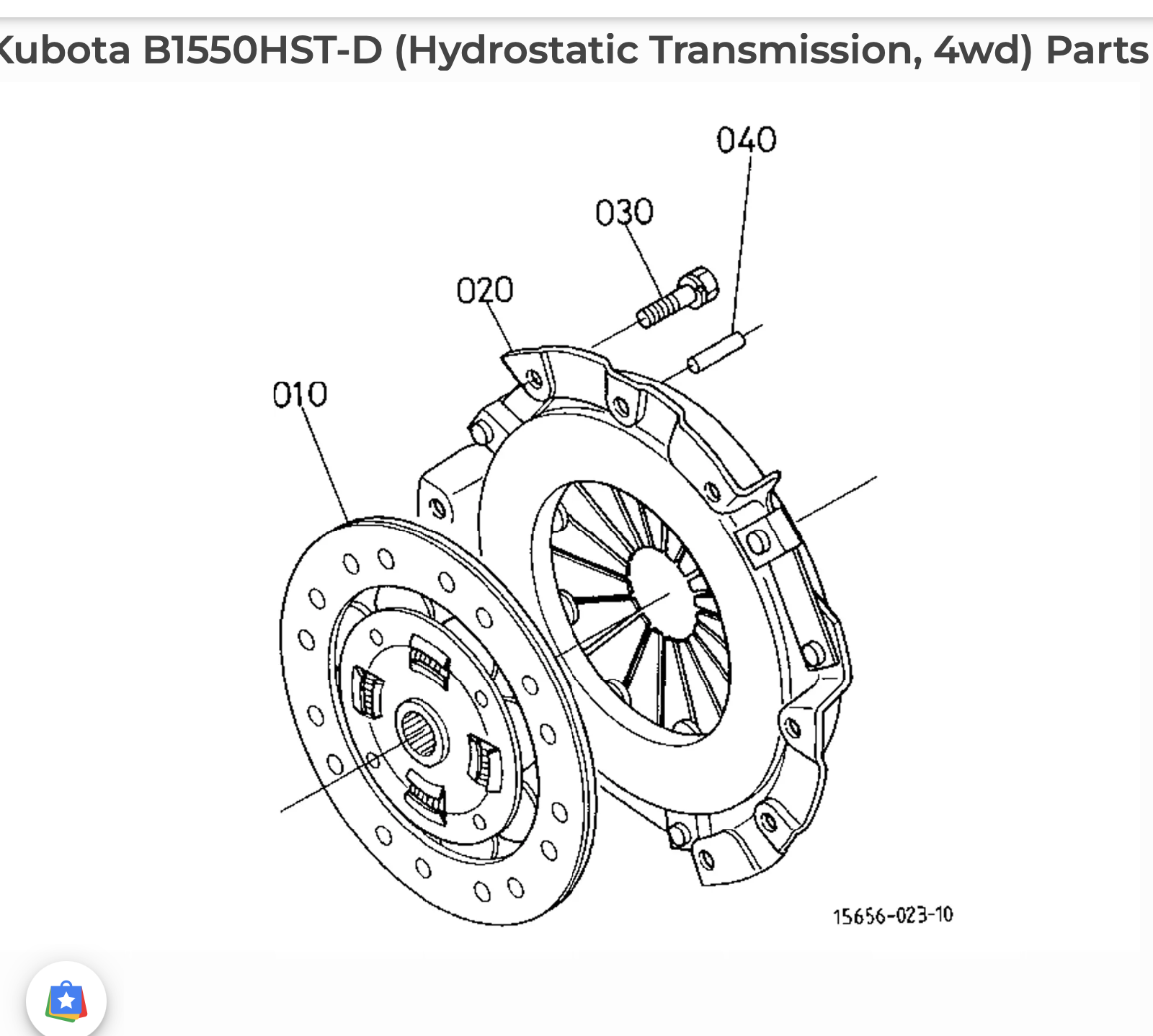

Sold a truck and took a Kubota B1550hst in the trade. Several bolts between clutch housing and flex plate were broken off,flex plate cracked,pilot bushing wallowed out,pilot shaft damaged,clutch and pressure plate damaged by using fel without having frame braces. All new parts on hand and reassembly underway. Through research I found several tractors that suffered similar damage from blower,hoe and fel use but noone addressed an issue I have. After clamping new flex plate to housing (plate not bolted to engine) there's a gap between plate and housing from 10 oclock to 2 oclock. 1/16" at 10 and 2 with 3/32" 11 to 1. Flex plate confirmed flat laying on test plate so apppearantly housing is bent. No way I'm going to heat or beat housing in attempt to bend back and I believe pulling it togeather with bolts can crack flex plate or at best preload stress on plate and operational stress would cause plate to crack. I've considered shims so that bolts can be torqued down but my concern is prop shaft running out of alighnment. If I had some way to referance where shaft is alighed i could shim to maintain it. I'm away shaft only spins inside bushing when clutch pedal is pressed but misalignment undoubtedly has an effect,how much is the question. Oilite bushing turned 0.130 oversize od to compensate for wear in crankshaft.

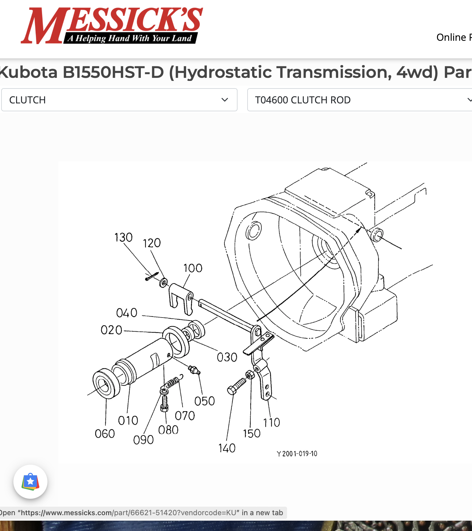

Hmmm.... I may be offbase, because I don't know the B1550. I'll go take a look at the parts book on Messick's site and see if I come up with any thoughts.
   / Kubota B1550hst clutch install #10
Any of this look familiar? Is your "flex plate" what I would call the "Pressure Plate 020"? Screenshot 2023-11-23 at 9.32.32 AM.pngScreenshot 2023-11-23 at 9.33.49 AM.pngScreenshot 2023-11-23 at 9.30.38 AM.png
