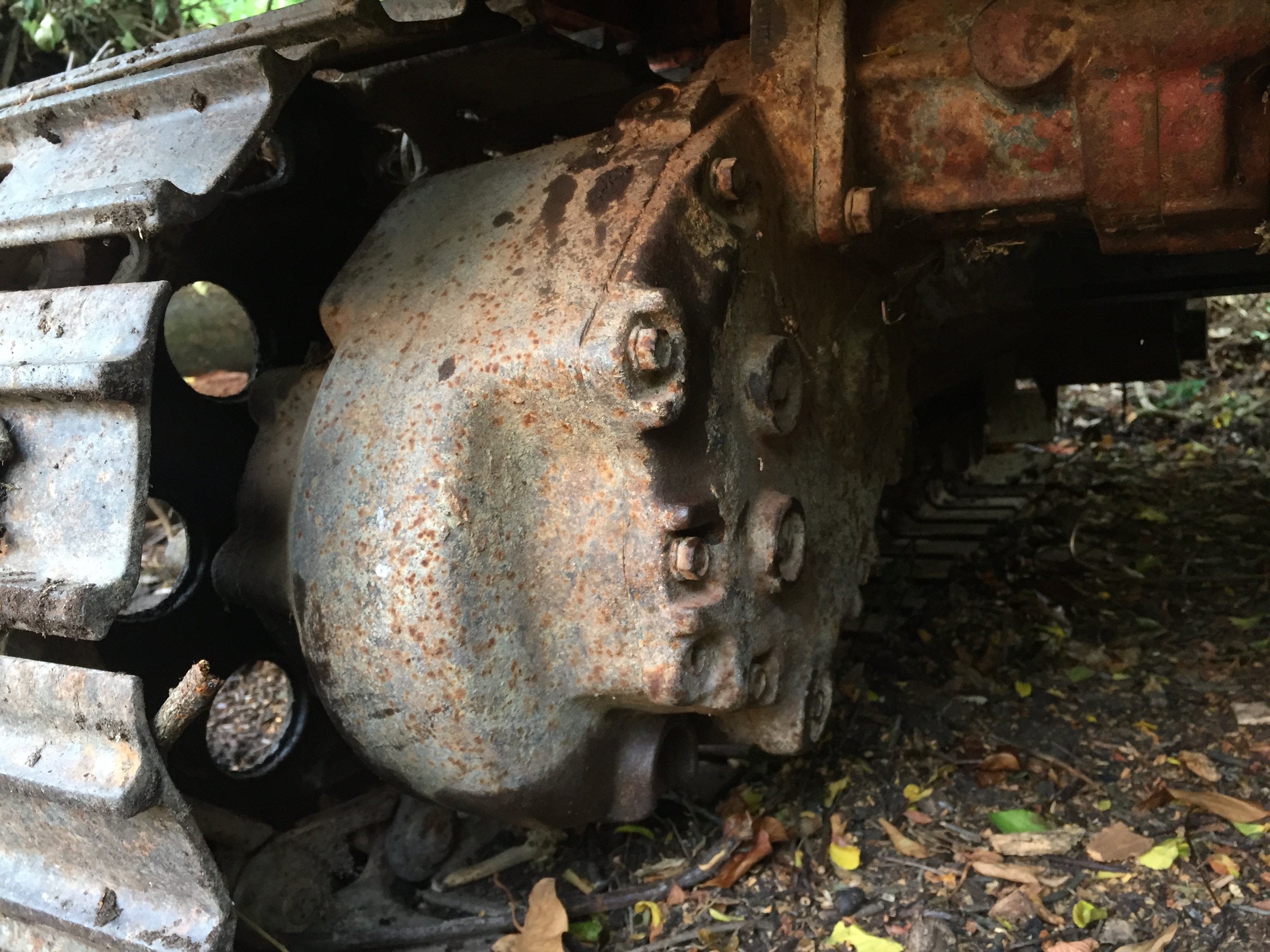

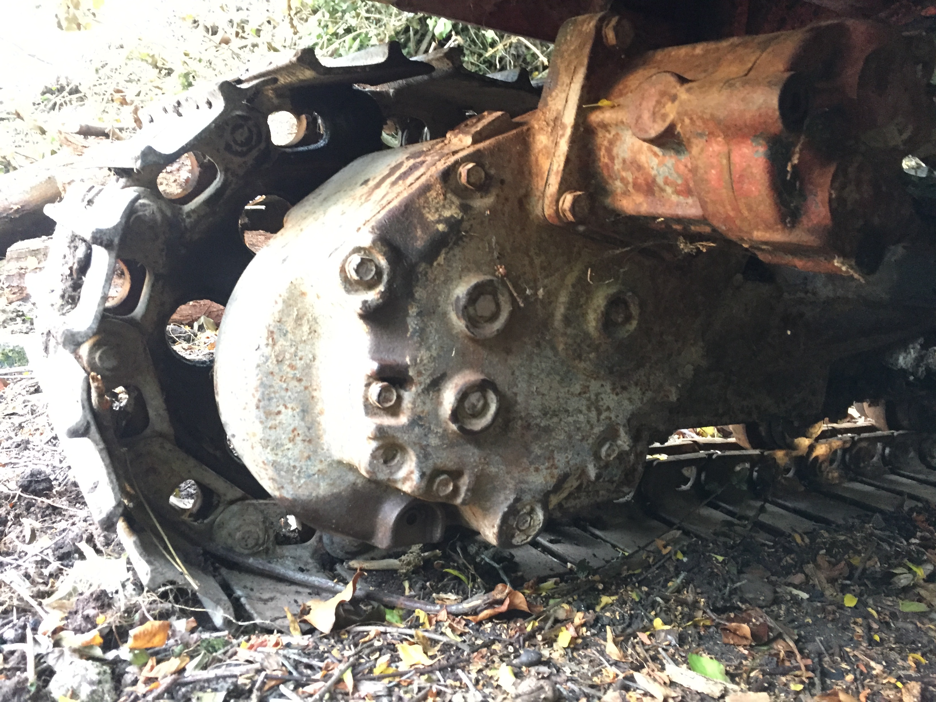

Im stuck with the oil level.
The fill and drain plugs are top and bottom. But what about the fill level? Alot more oil than i anticipated came out (3-4 litres).

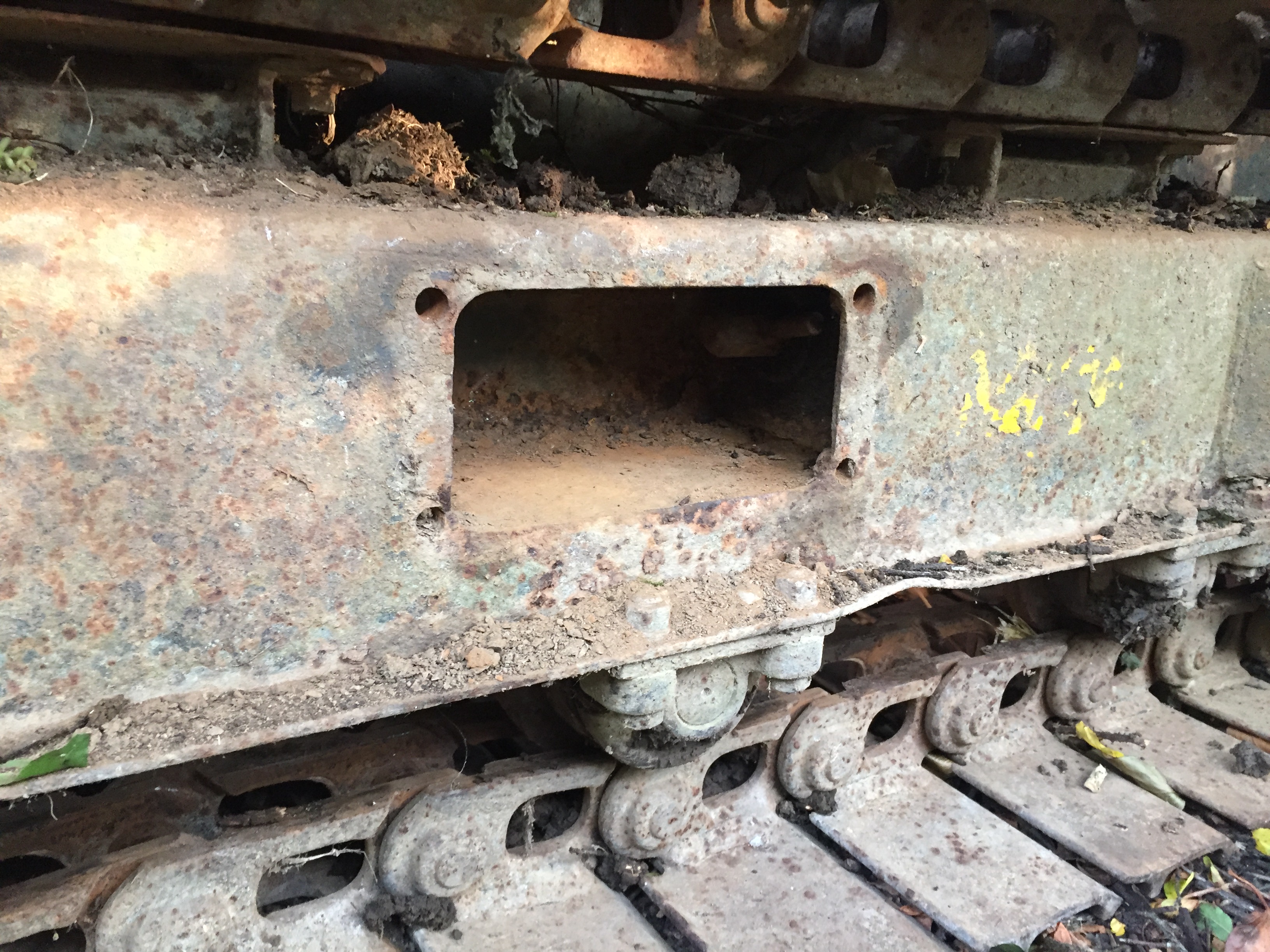

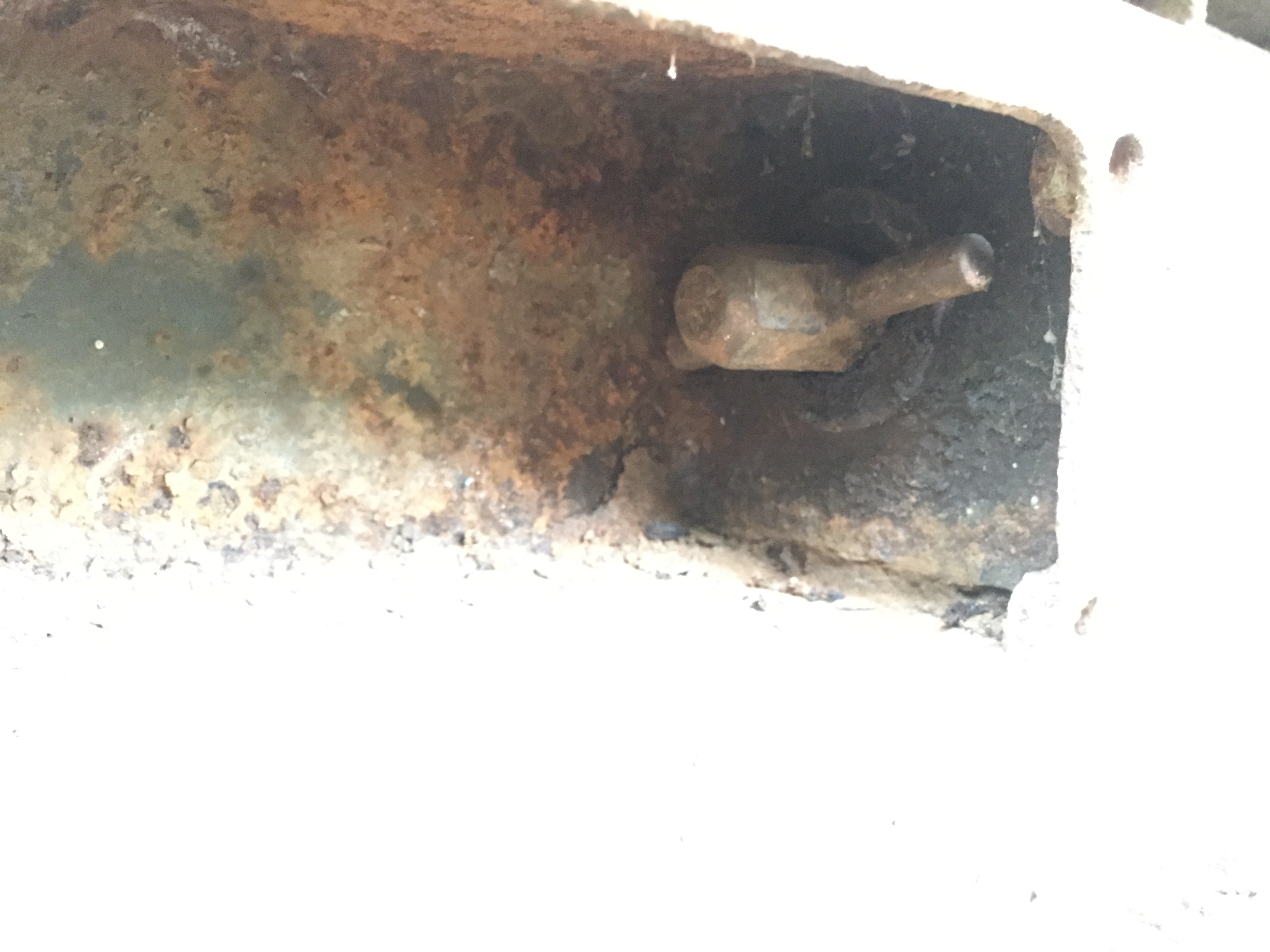

Track tightening appears to be a manual screw ?

That is a lot different than the newer models..... The newer ones use a grease nipple for the tracks and grease pressure holds everything in place. Very simple and works great.
Manuals - may want to try this place, seems to have a lot of older ones:
Kubota - PDF Repair Manuals | Johns PDF Service/Shop Manuals
Here is a video on final drives that may help you out a bit
Excavator Final Drive Motor - How To Check Gear Oil Level - YouTube
mostly fill in one hold to the oil level hits the other hole but not positive on your machine. It is a great idea to change that since you are a new owner of that machine, who knows if and when it was changed. Sorry I can't give you more specific information

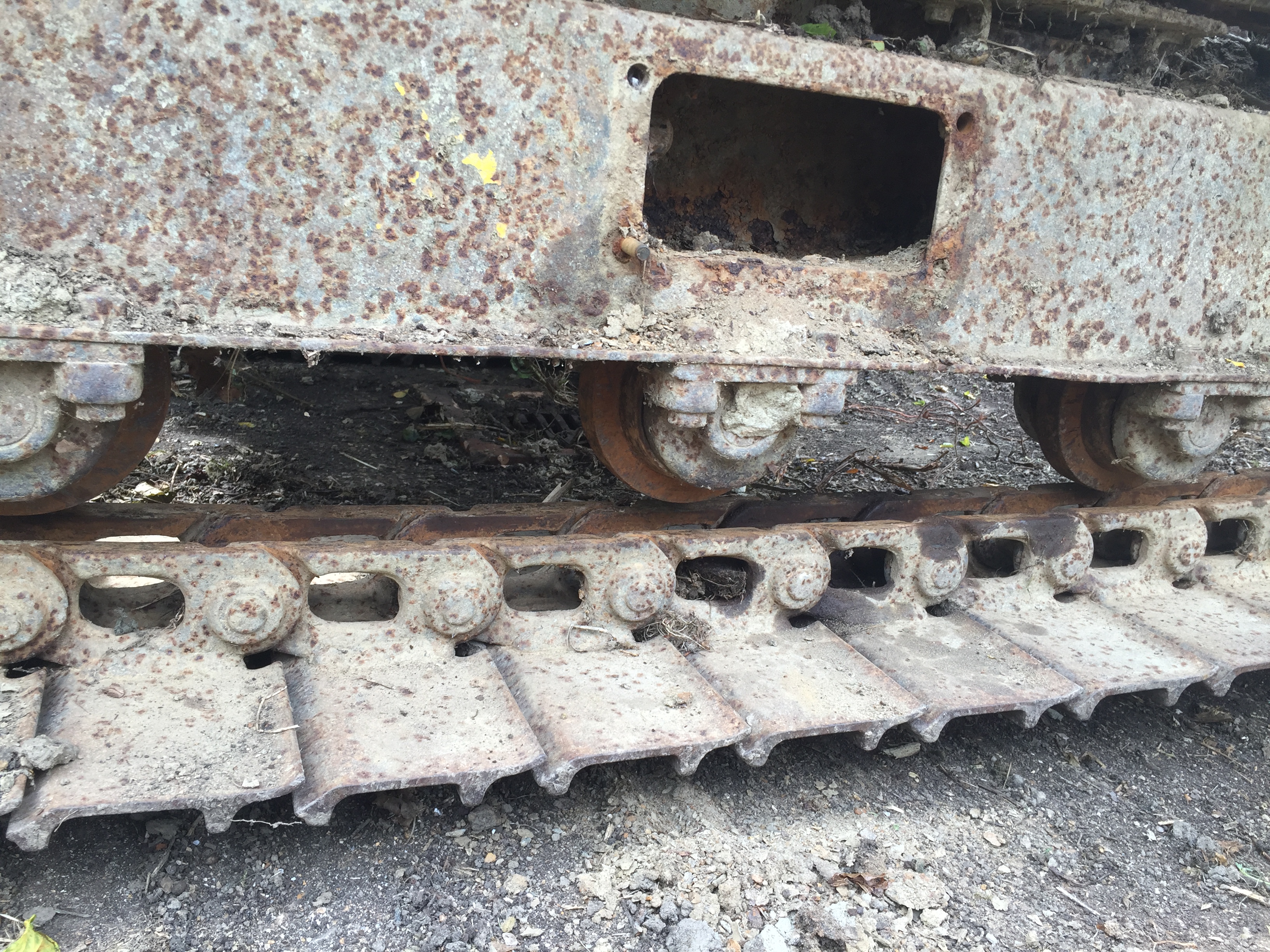

Today i managed to tension the tracks. Does this look reasonable? i set them to sit 1.5" below center roller.
Also lifted the seat out and floor panel to check the swivel motor.
The gearbox for that was dry :-/
