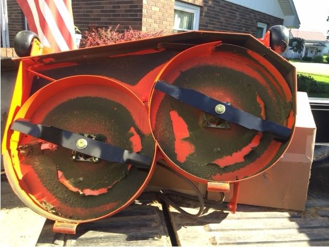

The directions with the kit are simple to follow. I'm not going to get too detailed because there isn't much to it. I took pics also but seriously.....nothing to it!! Feel free to PM me for questions.
1-Remove deck from mower.
2-Remove blades from deck.
3-Remove discharge guide, bolts and nuts from deck. I had an issue here. Rounded off the nuts (12mm) on #1 in diagram see pic. Remove anti scalp wheel (9/16) for easier access. Ended up grinding off bolt head and touching up with some Kubota Orange paint.
4-Install baffles and use correct hardware in designated places.
5-Install new blades. Align them as Owner's Man directs.
6-Install deck back to mower.

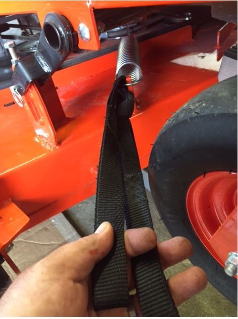

7- Belt on pulley!!! Take tension spring off first......place belt on drive pulley.....then use strong strap to loop in spring to install spring on deck.
I know this isn't much.....but I hope it helps somewhat.
