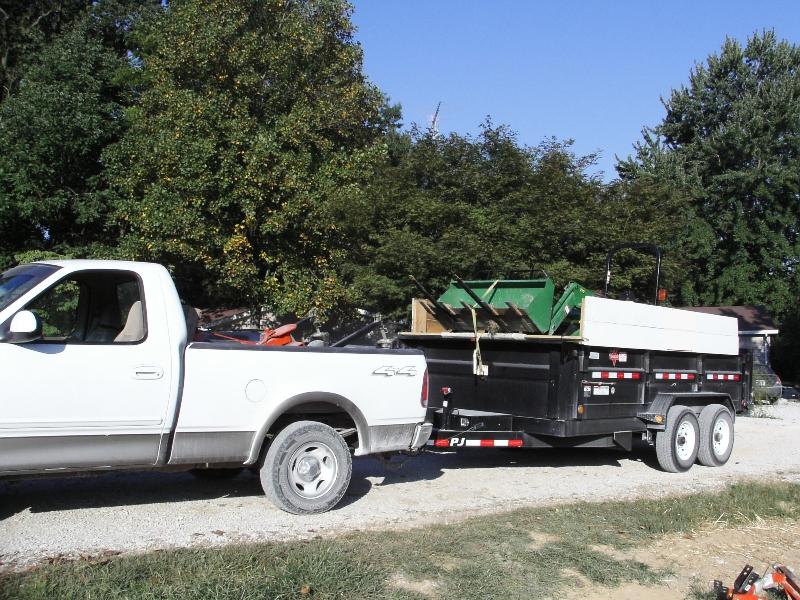

I have had a small landscaping business for several years and lately I have been becoming more and more serious about purchasing a tractor.
I have been spending $600-$800 a week on labor costs that could be, for the most part, replaced with the purchase of a tractor. I also frequently rent equipment to do tasks that a tractor could do.
I will be using for many things:
1. Moving material (stone, mulch, plants, dirt etc.)
2. Digging out patio and retaining wall footings.
3. Drainage lines.
I have decided that I definitely want to get a bucket in the front and a backhoe.
My other problem is money, I know that I could save up enough cash to purchase the tractor in about a year but I do not want to miss out on all of the money that I could make in a year with that tractor.
So here are my questions:
1. Is it silly to buy a tractor new? (I am leaning towards new because of the 0% financing.)
2. What would be a sufficient amount of horsepower for the tasks I have in mind?
3. I do not have a trailer that can haul a tractor. I am however looking in to buying a large 6 or 7 ton dump trailer with loading ramps. Does anyone have any thoughts about this?
4. Any suggestions as to what models I should be looking at?

On the dump trailer as tractor transport. It should work. You just need to get a small enough tractor to fit in the trailer. Most 14k dumps are about 14 foot long. With the tractor in there, there won't be too much room for attachments.
Have you checked for input on places like www.lawnsite.com?
