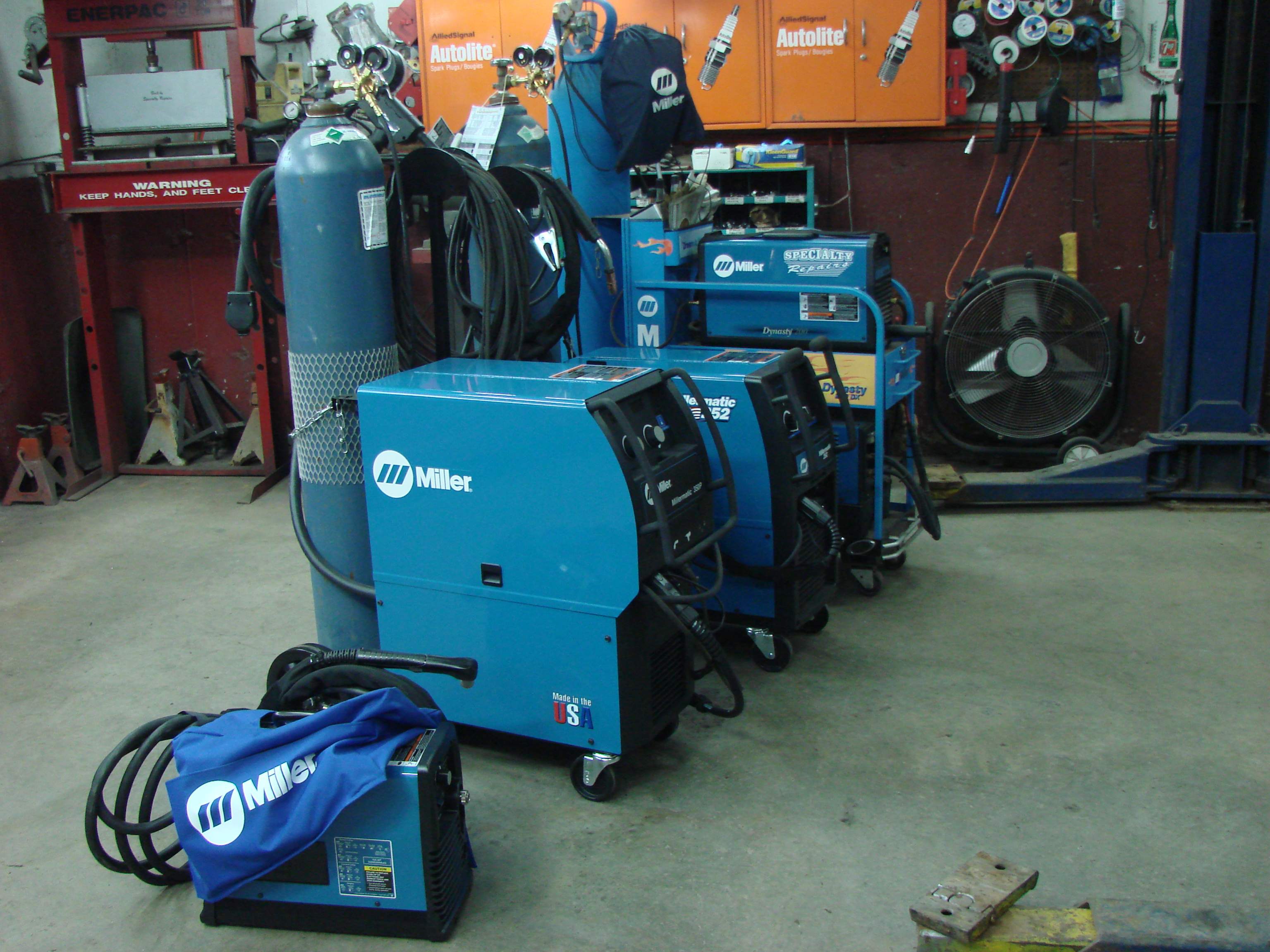

I'm selling my heliarc rig and buying a Miller 252 with a spool gun. I can still do commendable work with mig that I don't mind letting folks see. My suggestion is to get the best 220 mig machine you can afford so you have something to work with and if you have the tig itch, then scratch it, but it will take time and a lot of practice:laughing: Spend some time on Miller - Welding Equipment - MIG/TIG/Stick Welders & Plasma Cutting Excellent information there.
I tend to like my welding machines in Blue.

"I tend to like my welding machines in Blue."
I think it is more involved than simple color. It seems to come down to the process and even in that a model in the process. There are machines like MIG that many manufacturers make well, some that make better TIG and some that make better multi process. My MIG is a Miller, my stick a Lincoln. Sometimes when you open up and look at the guts, you will see some short cuts made by a company on various componets. My uncle worked for Union Carbide (Linde) for many years and eventually bought a large welding business in San Jose. I got to play with lots of stuff. By the way, the money he told me was not in selling the equipment, it was selling the consumables.

Certainly, the Blue line is more than a bit arbitrary, but for my uses my equipment has been excellent. The problem with most equipment is "operator deficiency". That is certainly the case with me. Having spent thousands of hours on the hot end of "red" machines, I know they are just fine:eek:
Your uncles observation on the consumables is, what I call, the Gillette school of marketing. "Giv'em the razor, sell'em the blades!":D
What you say is true.
I have used the RED ones for most of my career, and started with them over 25 years ago already. I have spent a good amount of time with the BLUE ones too and in fact own a MM251. To say one is "better" than another is personal preference, nothing more because they are BOTH VERY GOOD.
