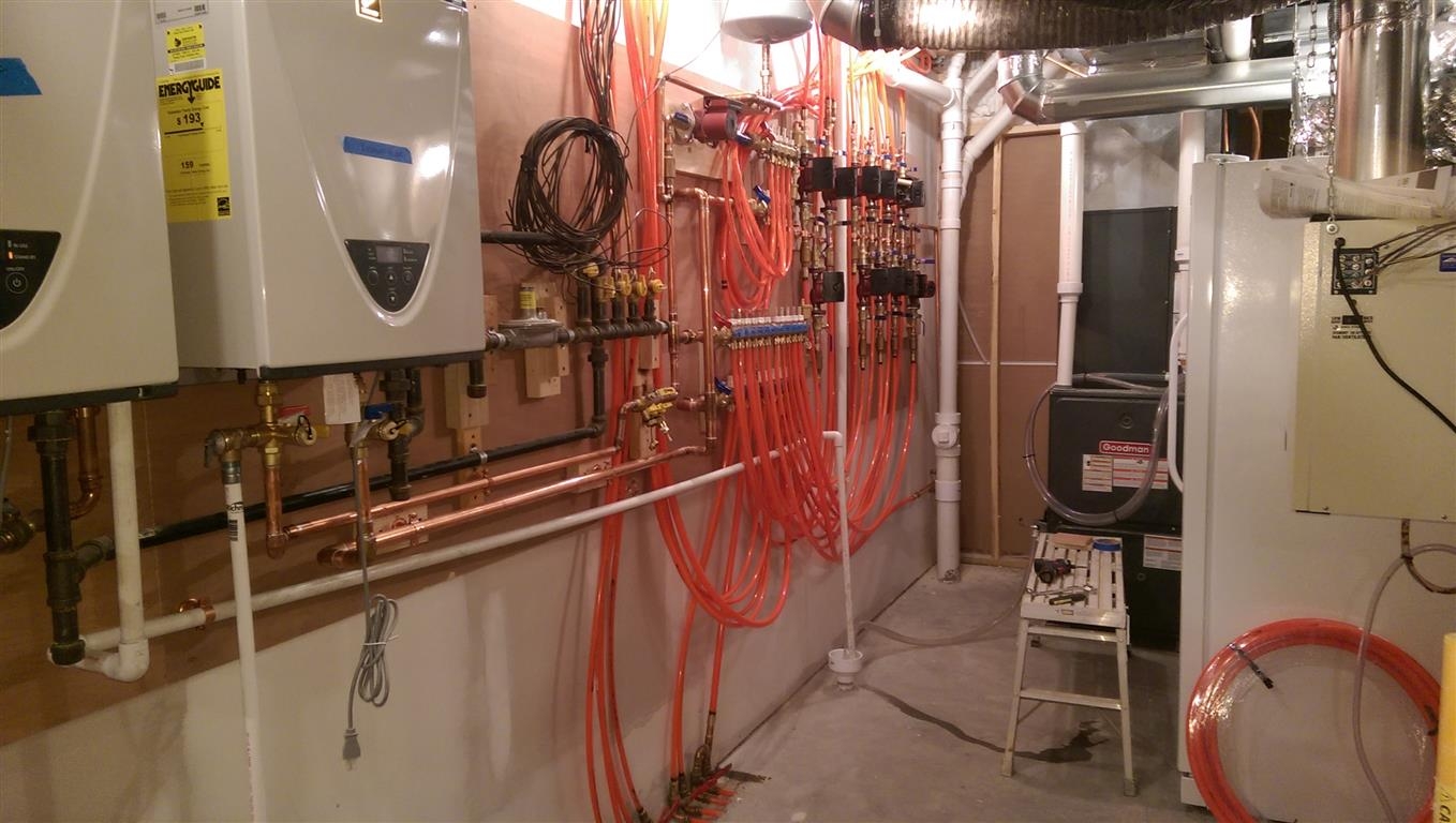

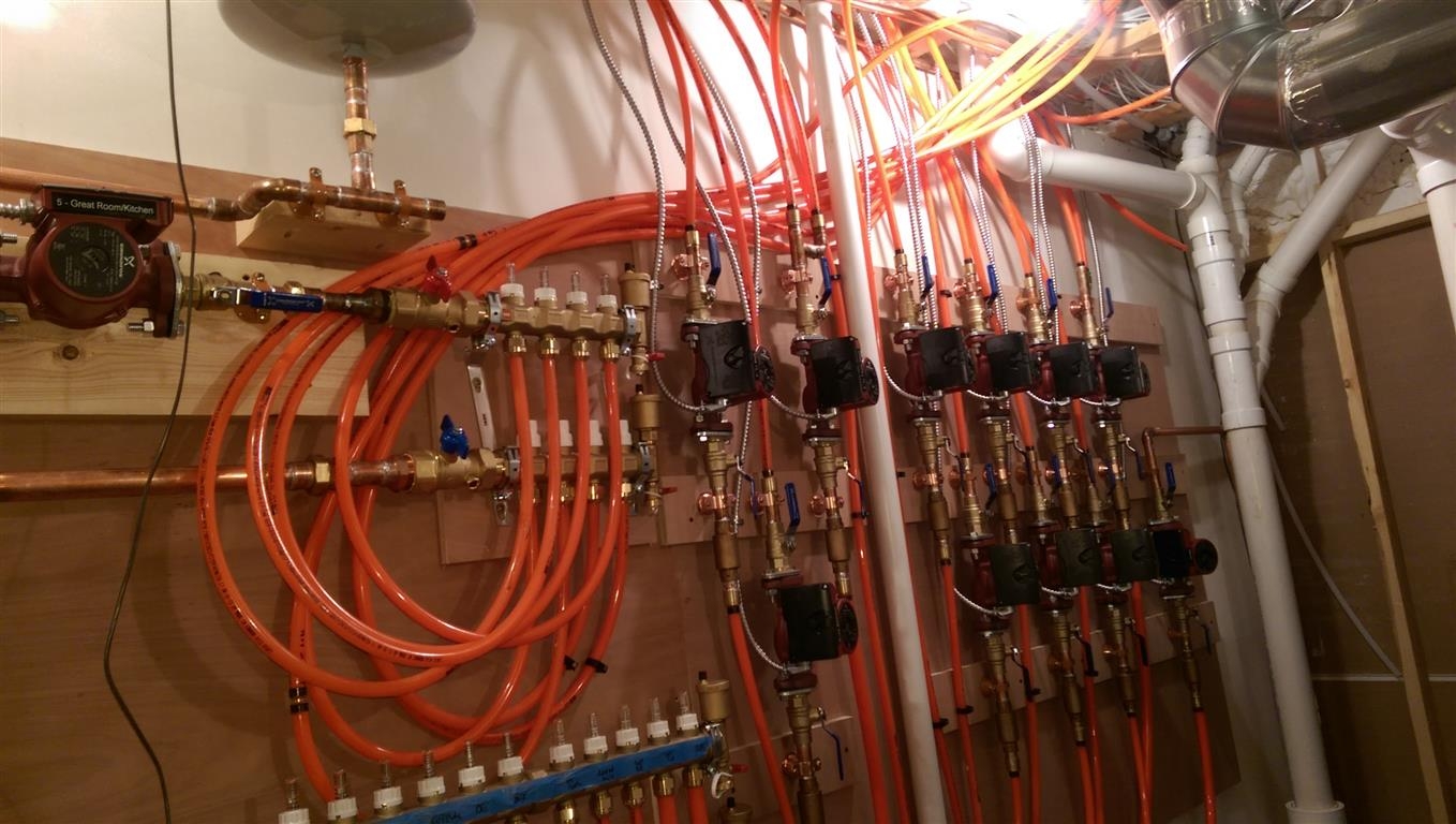

Each room has it's own circulation pump?? Gator you sure about that?
Mine is essentially like that, so it can certainly be done. Here is mine complete:

That is one full room!
I have never seen my neighbors equipment room but from what he described as an electrician’s nightmare sure looks like it apply‘s to yours also.
As Murphy 1244 posted, that is one room full.
   / My Industrial Cabin Build #4,737
Actually there is plenty of space to work in there as needed and it is all laid out and organized/labeled. I knew I was going to need a fair bit of wall space for all the pumps and controls, so i planned for it.
