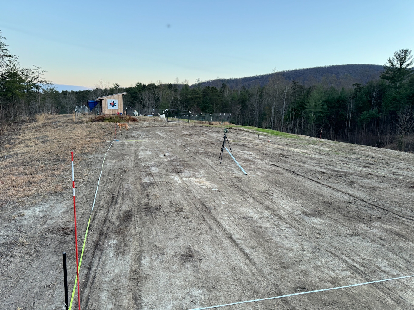

The state says no building permit required for ag building. The county has a 15 page application for the barn. State dept of health is included to make sure you that it wont affect septic or well.
County wants to know proximity to property lines, stream buffers and to clamp down on “barndominiums”. They want to get up your backside and know your business. And I’m sure they want to tax the heck out of everything.

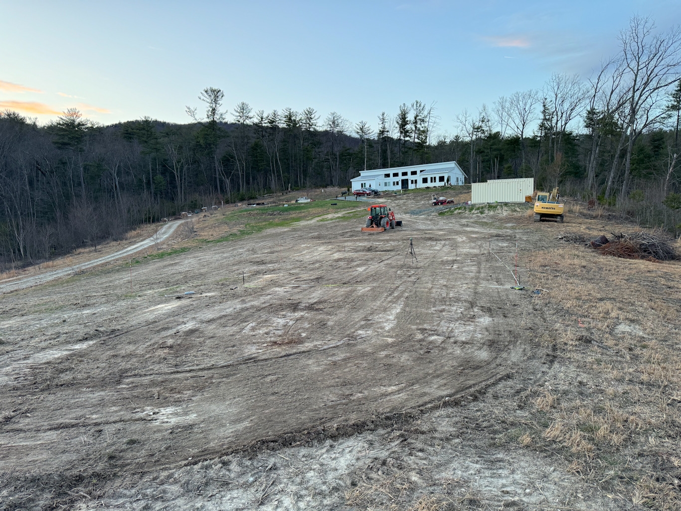

The barn is small. Just big enough to satisfy our needs. 24x40x12with a 12 foot overhang
Metal tube frame, on dirt, anchored to the ground with mobile home screws. Tubes are 4 foot on center
I scraped away the bromegrass and I’m digging out the 3-6 inch difference with a shovel around the outline of “foundation. Using the tractor and boxblade to create swales in front and back to prevent rain from working its way into the barn. The sight is a relatively flat saddle on the field in front of the house. Barn has 10x10 rollup doors front and back. And 5 windows starting at 5 feet high.
