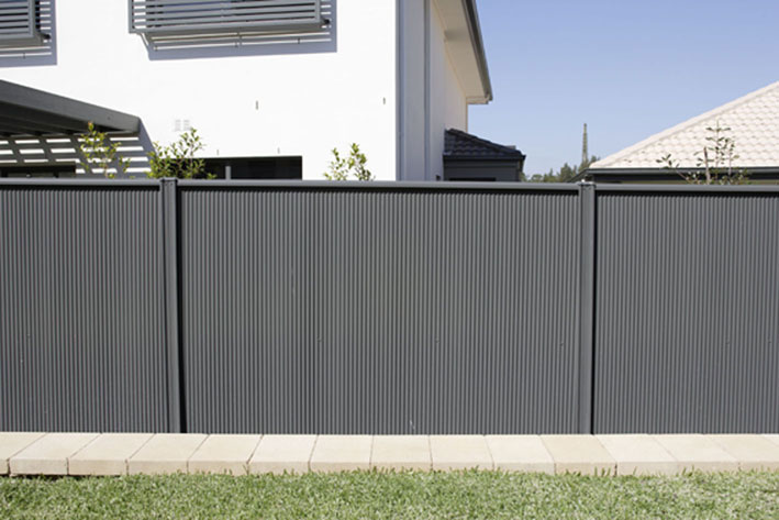

I'm having a hard time visualizing how this is going to look painted or not. Is the goal to make the material look better or make it last longer or both? I remember seeing a fence design in a book where they had boxed in metal with a wooden frame and a open transom type frame at the top to give it more appeal.

Have you never seen a corrugated iron fence? They are very common over here especially in older areas.

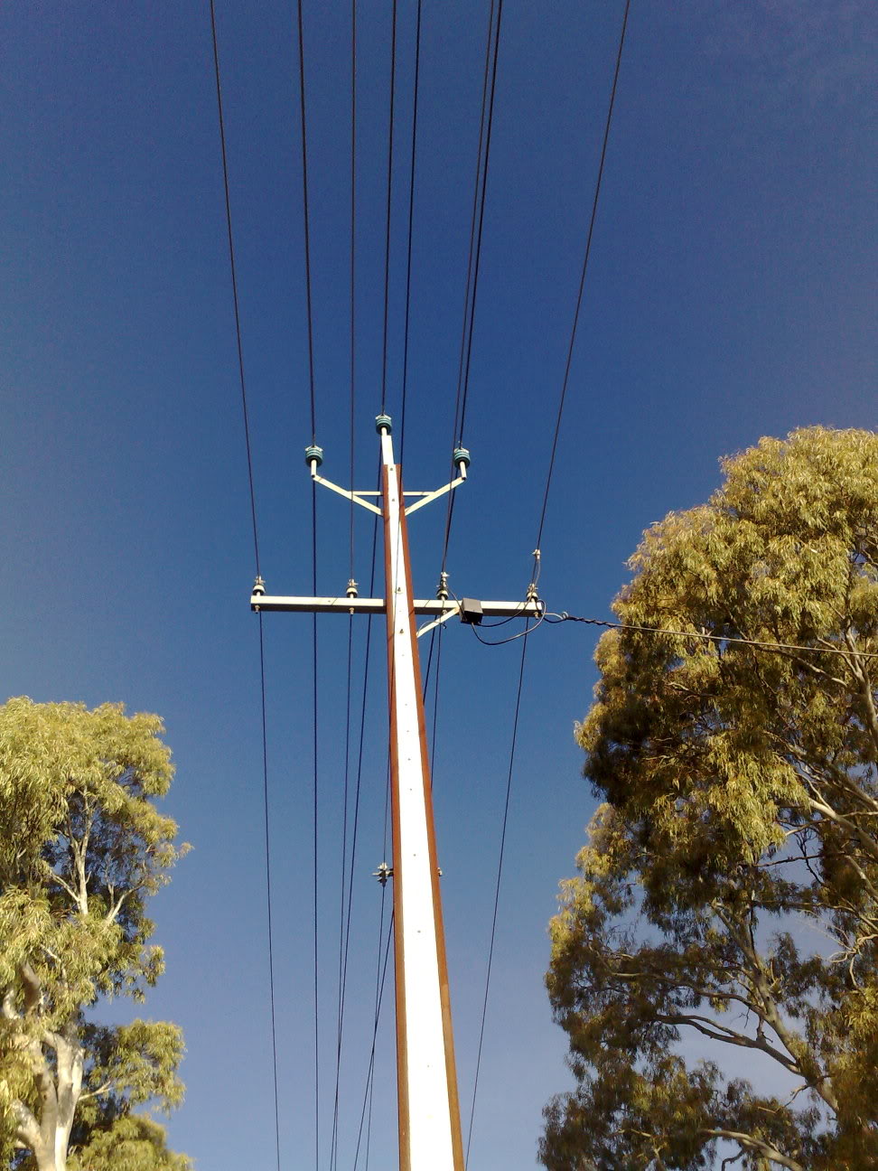

Your mental image is probably not far off the mark. I wouldn't put one across the front of my block, but they are fine in the right place as long as they are not too high. The more modern versions don't use rails. We don't have the timber available to us that you guys are used to so I suppose we have a long history of using alternatives to timber. Our electricity poles are concrete and steel too (although most electricity is undergrounded these days)
